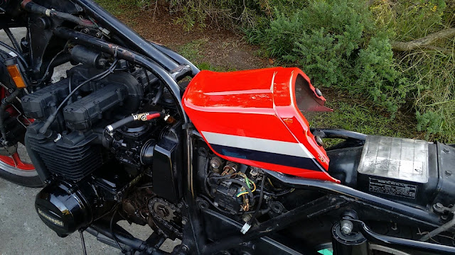

Finally to do the clear this weekend. I sanded back to try to flatten the basecoat with 800 dry, then apply another coat of paint. Left it for 24 hours.
Then apply 2K spraymax clear. 3 wet coats with 10min in between. It dries really shiny! But with visible orange peel.
I had enough in the can to do 2 coats of side cover, and 1 coat of tail and front fender:
The clear actually hide some imperfection, but what's really bad is dust. Even one tiny dust speck shows up on the clear and I was spraying in a closed garage.

2k clear settles a bit, it hardens fully over the next couple of weeks. You can polish the orange peel / fingerprints / dust out using 1200 1500 2000 wet , then hand glaze compound. Ideally you want to do this before it has set rock hard, but you can do it any time after as long as it is hardened enough. Be real careful to avoid sand throughs on the swage lines.
Also avoid the temptation to bake it in the sun, you could get solvent pop bubbles in the clear if you force it too much.
Finally, sand to bare metal the fuel tap gasket area and filler cap hole - petrol fumes get under the paint and causes peeling.

04 Jun 2017 06:15 - 04 Jun 2017 06:15Tyrell Corp wrote: You can polish the orange peel / fingerprints / dust out using 1200 1500 2000 wet , then hand glaze compound.
I do not have an buffing tool so not really sure I want to mess with the shine? Or can it really be done by hand?
Yes, I wouldn't have any time to mess around with it until next weekend so just a slow nice curing process in the garage
If anything I learnt so far patience is the key.... I did not realise the 10 minutes between coats could feel forever!!

Primer
panel wipe
fine putty filler
hand glaze compound
Hand finishing and compounding is ideal, buffing machines are more suited to cars. When wet sanding the clear you will see it coming off as a milky white colour. If you get colours then you have sanded through to the basecoat - Angular GPz bits harder than the more 'bubbly' curved earlier kz styling. Go really light on any edges.
If you screw it up you can key it, degrease and shoot more clear on -only after it is fully hardened. Obviously you want to use the same brand of clear.

Nice save in your final step before clear coat. You can knock down the orange peel with 2000 wetsand, then buff with a polisher and wax. It won't look so "plasticy" then either.

That looks really good and you were creative to work within your budget. Even the best professional painter equipped with top of line equipment are going to get some orange peel. When I was searching for painting information I came across an article for professional collision repair shops on how to duplicate the factory orange peel on a brand new car. Interestingly, there are different techniques to duplicate US, Asia and European manufacturer's orange peel. I had never noticed until I started looking closely a brand new cars. They all have a high gloss, but try reading a printed document in the reflection. Unlike a mirror, the letters will be fuzzy.
The difference between a good paint job and show quality paint job starts after the clear coat is dry. Careful fine grit (1500 - 2000)wet sanding and polish bring out that mirror finish. It can be intimidating to start sanding your nice glossy finish. The trick is knowing when to stop and having the confidence that the polish will bring the gloss back . As mentioned, you are OK as long as the sanding color is a milky white. However, it's to late if you start seeing base color, because you've already sanded thru.
If you do decide to try it, sanding will show just how bad the orange peel is. The high spots will be flat or dull and the low areas will be glossy. Your first response will be that you've ruined your paint job. As you progress, the glossy "valleys" will become smaller as you level the surface. Ideally you want to sand until they are all gone, with flat even finish. You're now ready to polish back to a high gloss. You may want to work a small area and intermittently polish to determine the acceptable level of sanding finish you are after. Better might be good enough. I also cheat a little. It's hard to notice orange peel on small areas or sharp bends. That's also the easiest place to sand thru. Minimize sanding in these areas. Concentrate on the larger flatter surfaces where the reflection will be most obvious.
An electric buffer will make the polishing job quicker. A Dual Action or DA is best for novices like us. True polishers take some skill not to burn the paint. However, you also can do it by hand. Polishing compounds are probably sold from the same place you bought your paint.
Either way, you can be proud of the job you've done. It's up to you what level you want to go to.
