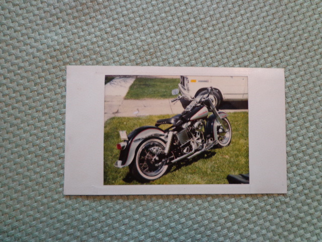

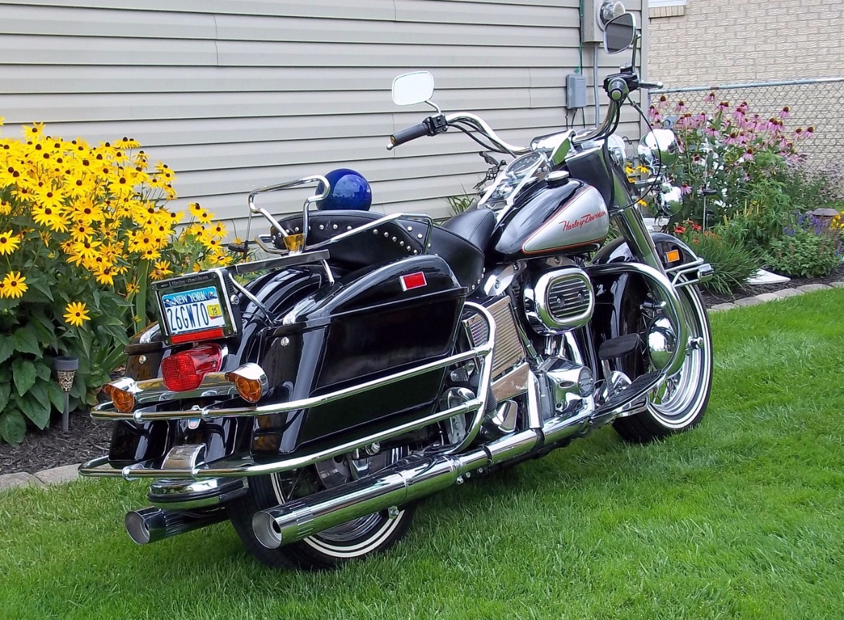

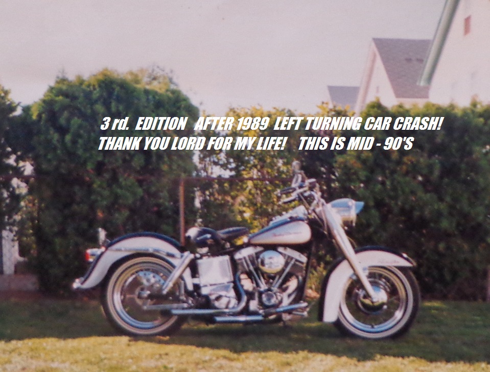

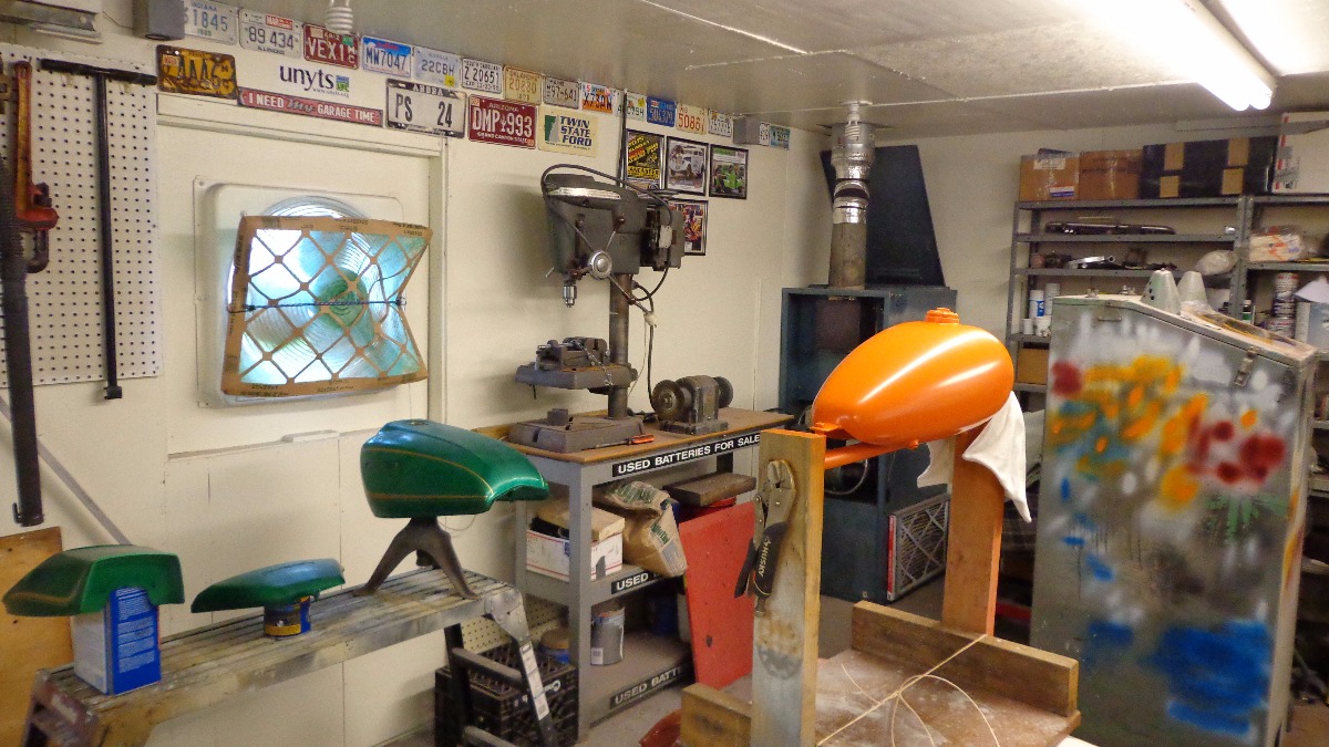

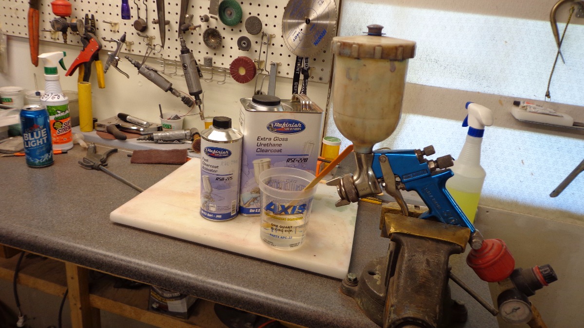

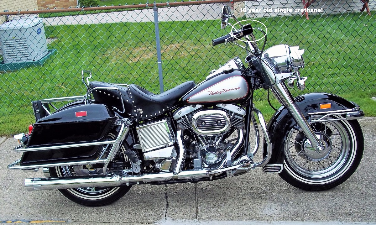

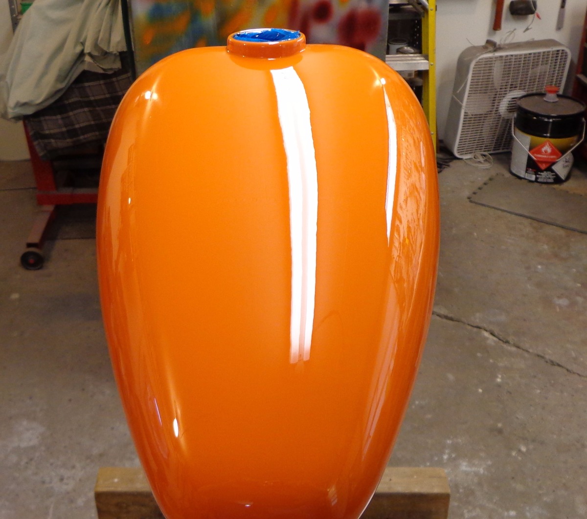

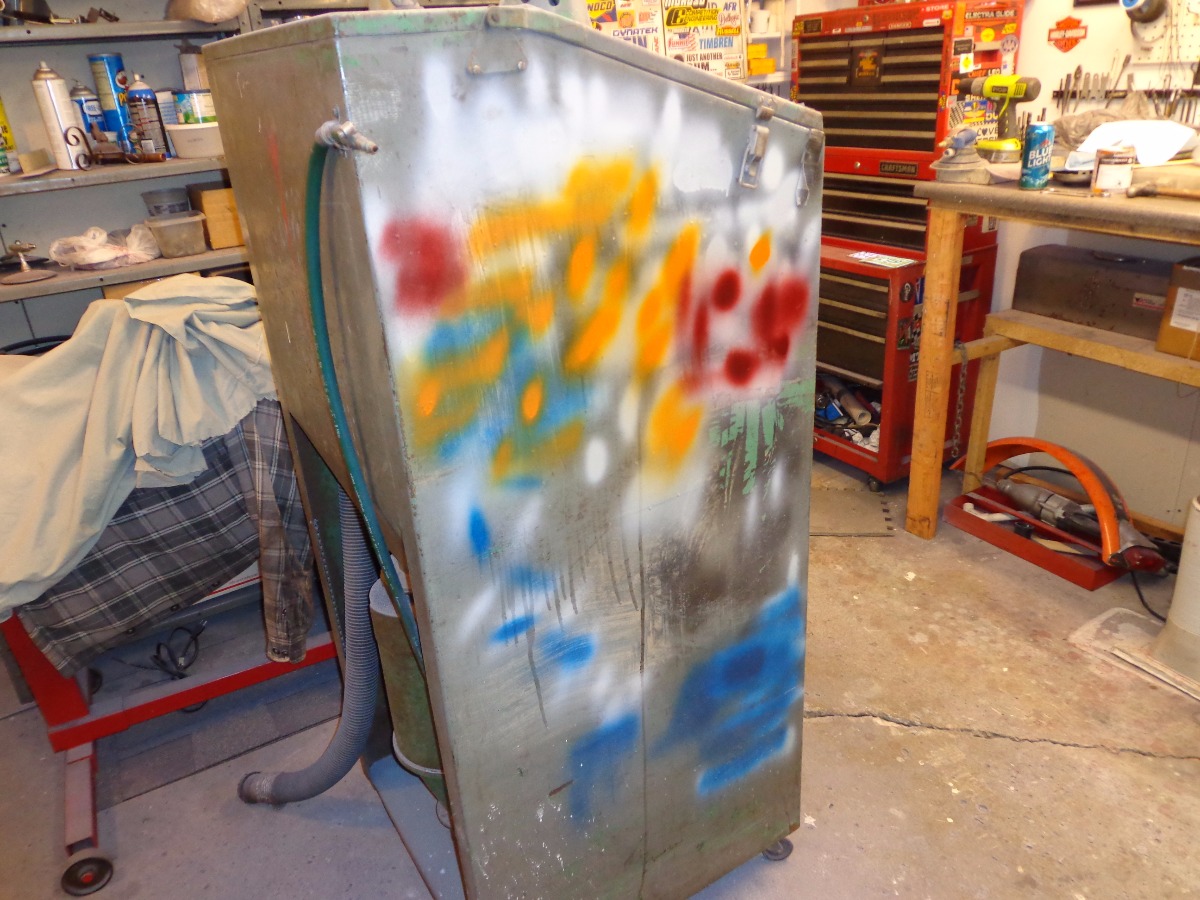

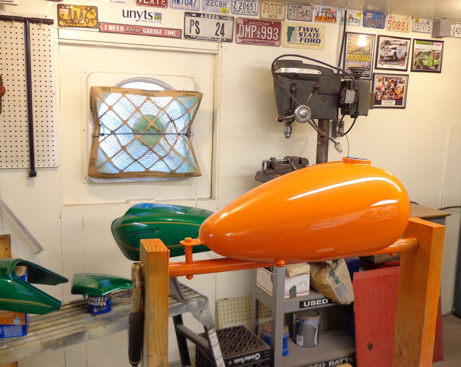

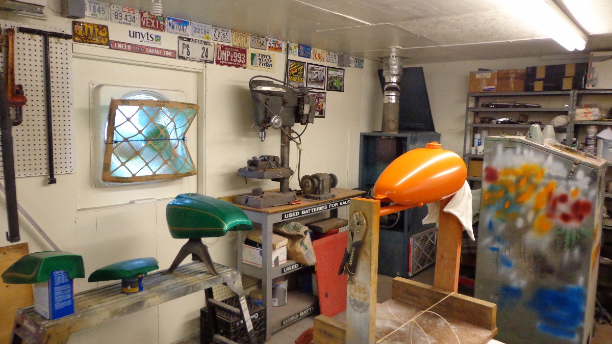

Hi H M, I did not see you are from Australia! Different regulations and cost's. But I have been using Urethane clear since 1994. Dupont came out with 4700 "HyperCure" dried in 2 hours, could buff in 8 hours in normal conditions. Back then I painted my 75 HD FLH. with old black and metallic silver Lacquer. It dried for about a week. I had my pin stripe "Artist" do his work with enamel. Then I used this urethane clear coat. People said OH NO don't do it! Well that was 23 years ago! Last pic 1994 won a plaque in bike show my 2 kids, they are 32 & 34 today!
This old set of tanks were painted in 1994 along with fenders. Years have past and I redid the fenders solid black.
But nothing like real - auto shop professional clear urethane.
Today it is so cheap! This 4:1 gal / qt. Made by "MATRIX" 5 quarts of sprayable material cost me $79.00. I can do at least 7-8 bike jobs with this clear. But I have not touched any lacquer, even primer for the past 20 years.
