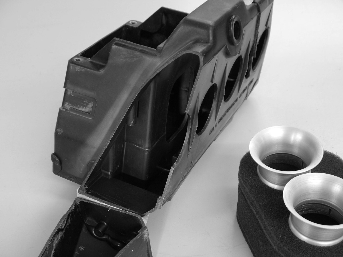

Looking to remodel my air box, and butt-join the modified pieces tightly back together, with neat/clean joints.
Is there an inexpensive (simple to use) adhesive suitable for the material?

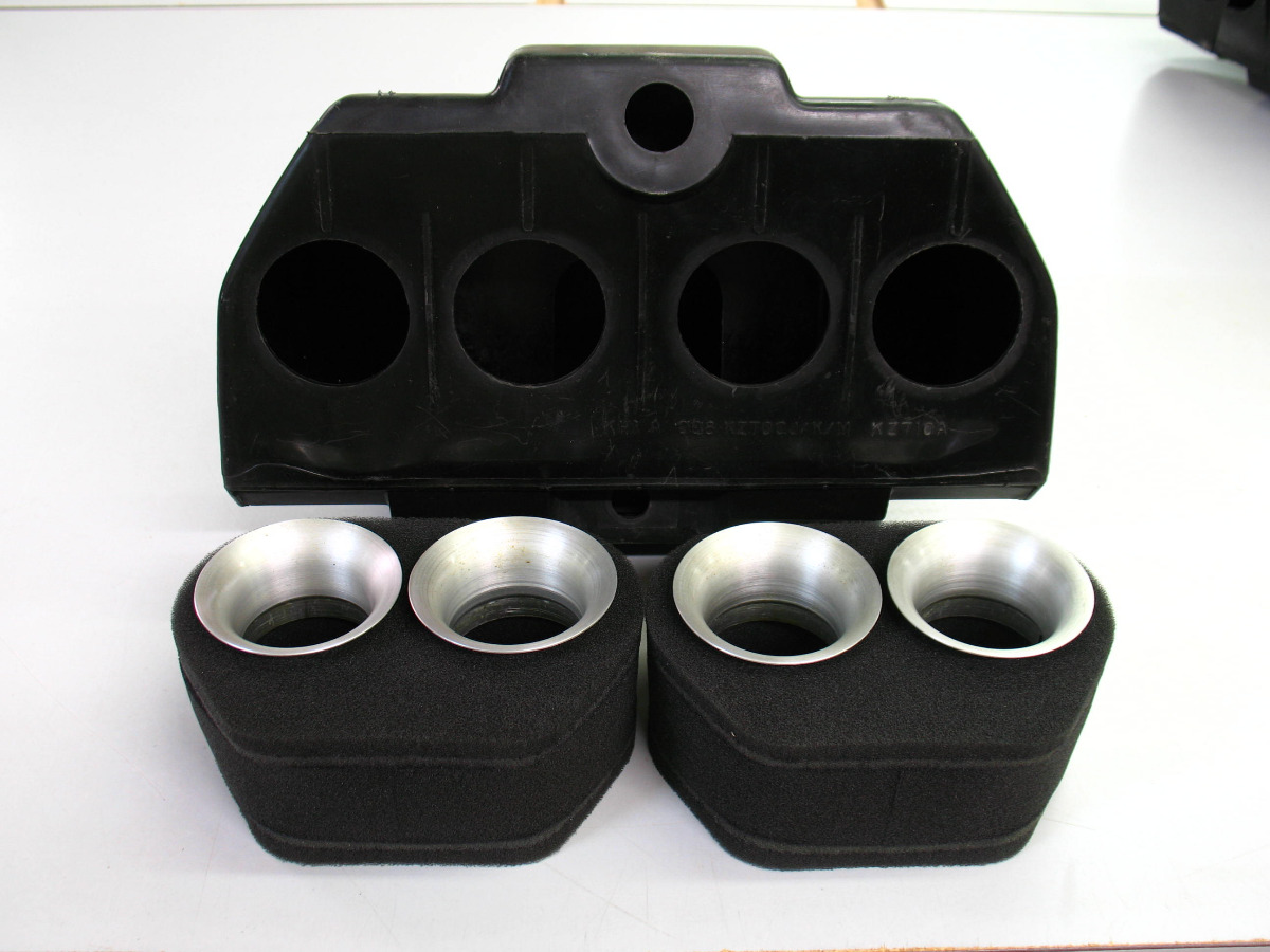

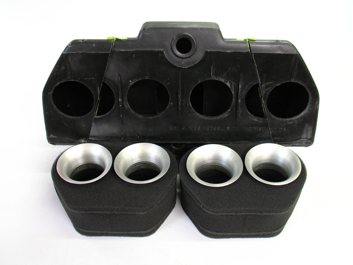

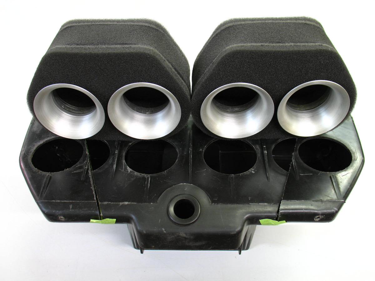

I hope to make one widened air box (from two) to accept 70mm long velocity stacks straight off the carbs, or Pipercross foam filters with shorter stacks, fit into oval shaped holes in the air box face. It would still look stock, having the original chrome covers and frame-attachment fittings for support.
