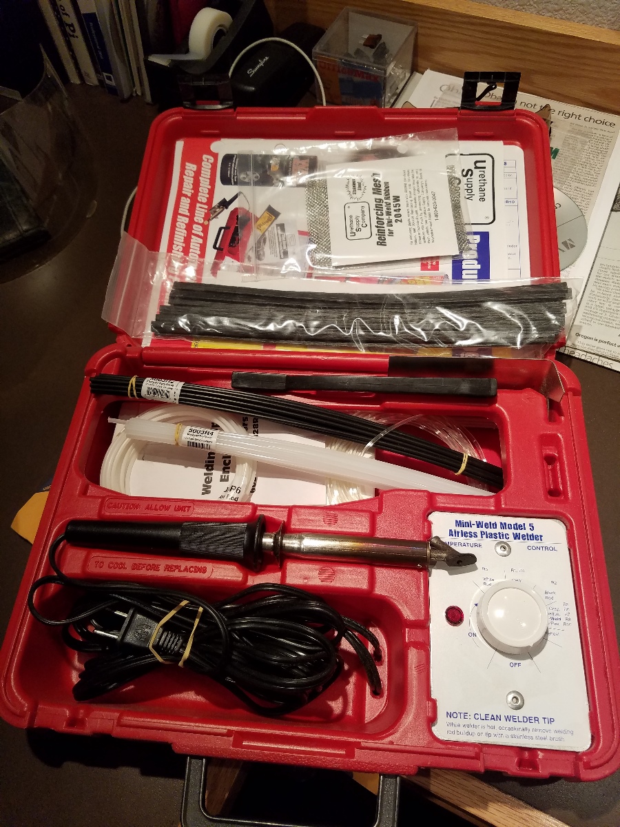

I just used this plastic welder to repair a polyethylene eye wash station that had developed a crack. It's been holding fifteen gallons of water now for three weeks. I believe our air boxes are also polyethylene. I don't remember perzactly but it wasn't very expensive but then what can I say, I'm a fool for tools!

That plastic welder is one that I recommend over the $17 one from HF. I couldn't afford that one when I was doing mine so HF it was. How much was that (if you don't mind me asking) ? jon
PS: The adjustable temperature is a great feature !!

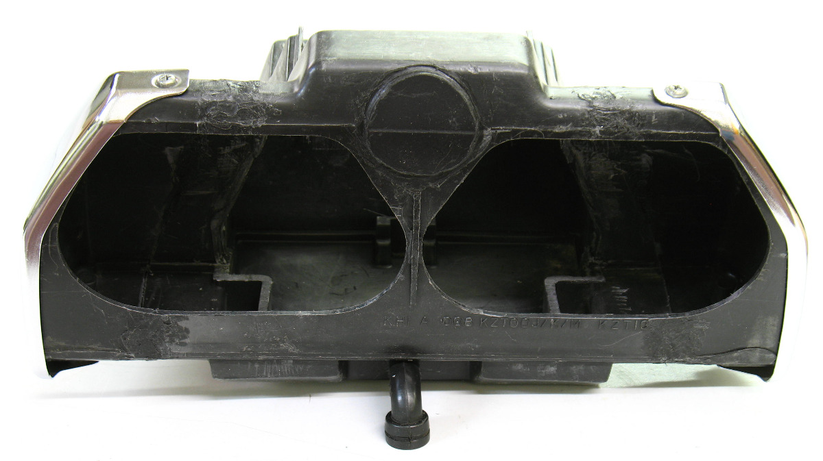

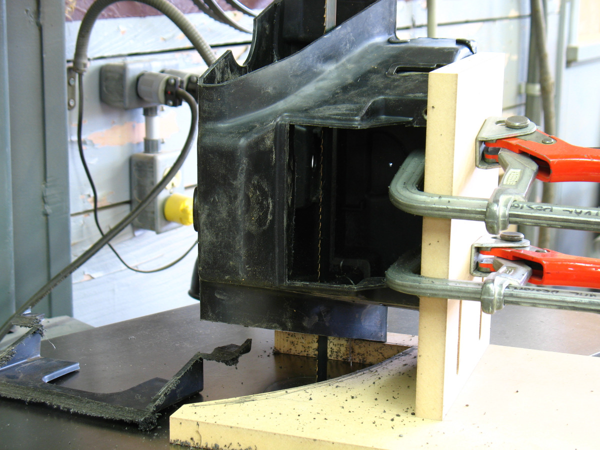

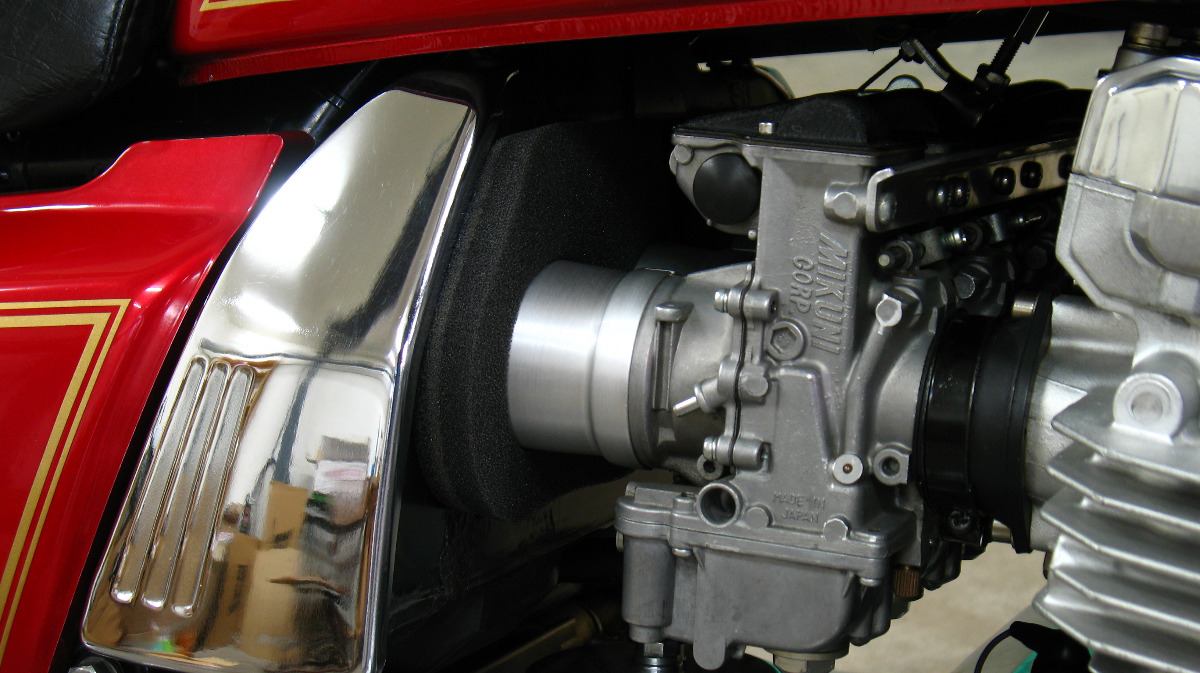

Brilliant [strike]Dumb[/strike] idea...I know. :lol:
Used an antique electric cattle prod looking soldering iron (thanks davido), which worked great for my first time ever attempting to fuse plastic (thanks SWest) together. It worked even better the second time, re-fusing it 3/4" narrower in order to clear the gas tank. :pinch:
It seems to work:
Snorkel cover removed:
A trick gutting out the interior:
Side by side comparison, as-built:
It seems to work:

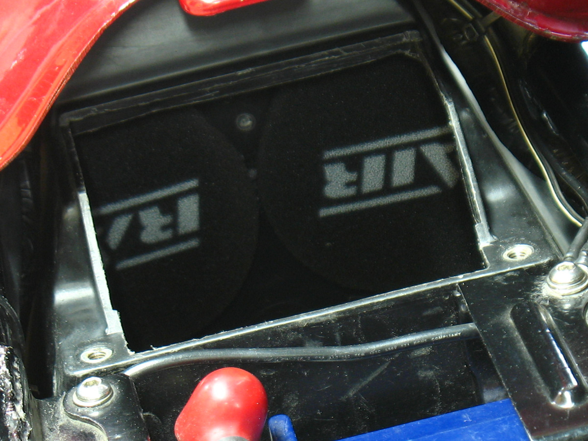

The new 50mm stacks open just inside, so I can stuff most of the filter material in there too. :woohoo: To install them, the stacks/filters were passed through the openings and attached to the carbs from inside the air box, since there is not enough space on the carb side to fit them. :ohmy:
Utilizing the original crankcase breather hose attachment on the air box, the engine once again vacuums away those intolerable-nauseous fumes! :whistle:
The reworked air box works much better than I imagined. The engine definitely feels constrained with the intake snorkel-cover installed. Without it, the engine feels like it breathes easier, and the power seems to come on stronger. :woohoo:
