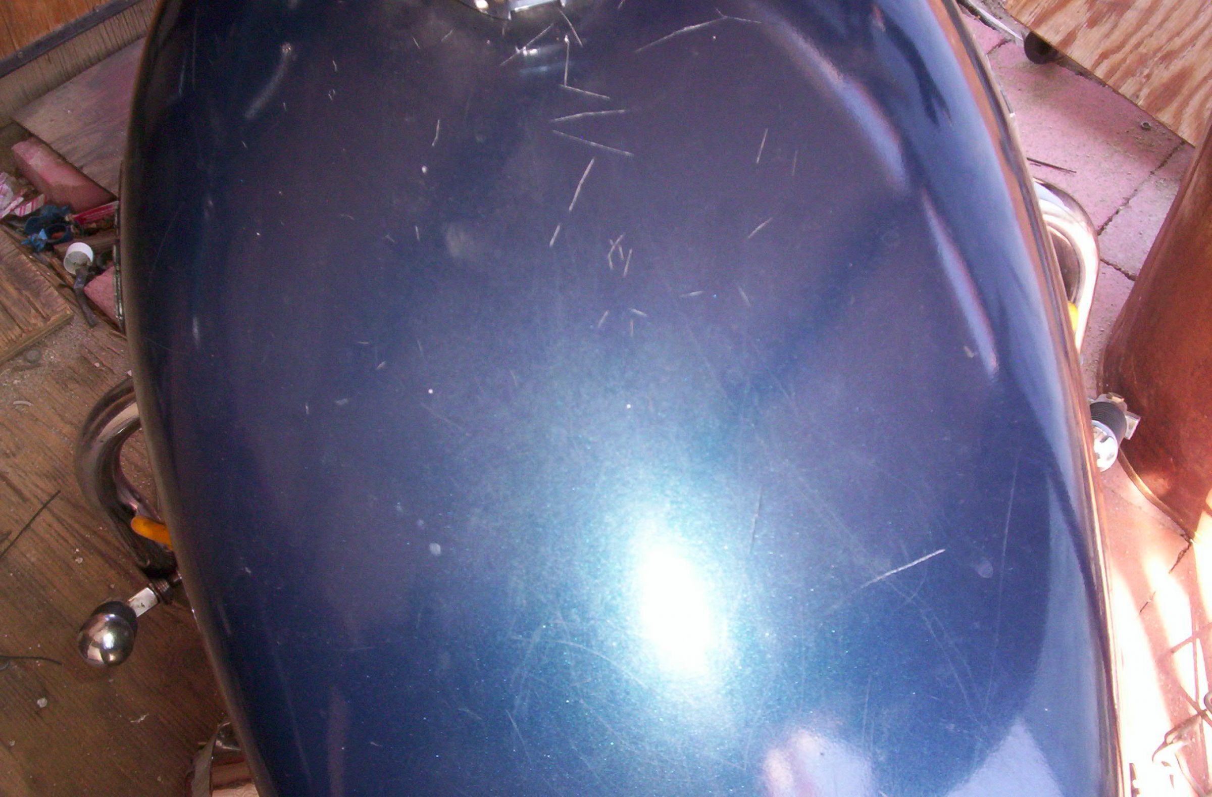

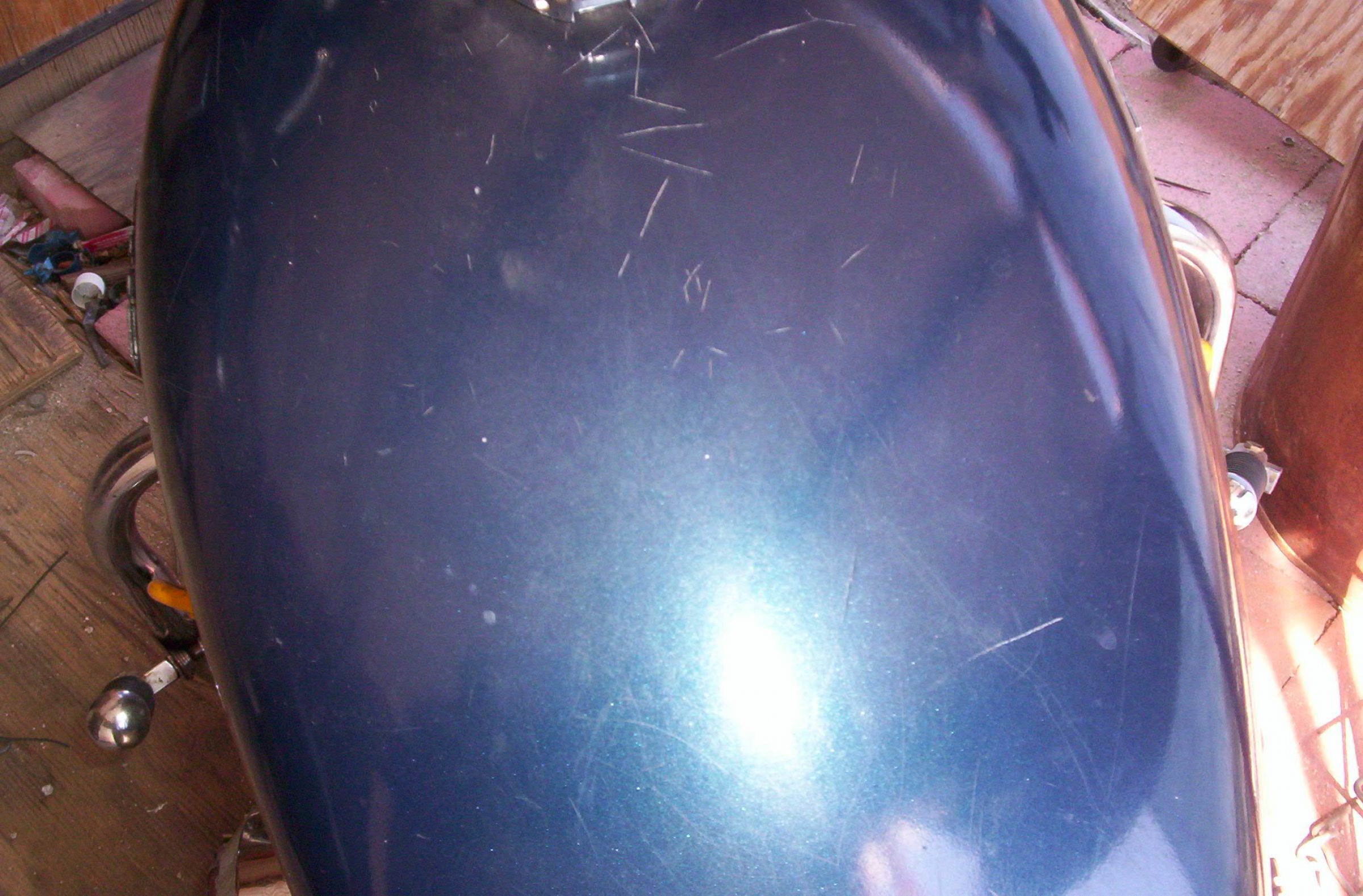

Also, polishing your old paint might give you satisfactory results too. I've done that a few times now when customers didn't opt for new paint, and it can look pretty good when done.

I try to save the original paint over re-spray any time it is possible, up to rust or dents bigger than a quarter. It seems to work best on bikes without fairings or much plastic bodywork like the '82 GPz. Cruiser models are the simplest to restore or paint. Spending the hours doing paint touch ups, wet sanding, rubbing and polishing compounds, waxes, and buffing tools is easier and WAY cheaper than sanding, priming, color coating, and clearing.
