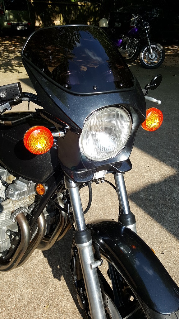

I wanted something similar for my 650 and found this EMGO Venom Mark II for about $60:
It came gloss black but I painted it to match the bike.
Installation was a PITA but I liked the results.

Wrench monkey, Now that's a Nice looking fairing ! Does the back edge of the fairing come in contact with the handlebars that you have ?
My turn signals are also mounted in the stock position on the headlight ears. Does the cut-out or drilled hole of the fairing allow for clearance of the turn signal stalks or did it need to be trimmed or the hole enlarged ?

Re: KZ Sport fairing ?
06 Jul 2016 06:59 - 06 Jul 2016 07:00
Hey there
Ooops. No. The fairing does not contact my bars or anything else for that matter even though it's close fitting.
The fairing is pretty much plug and play as far as the signal stem stalks are concerned. The holes where you pass the signal stems through are perfectly aligned and didn't need any mods to press the signal stems through.
BUT
I did have to F with the entire assembly to get it installed. The main culprit for me was the headlamp opening is made a slight bit smaller than the headlamp bucket's perimeter, so to install the signal stems and wire etc, requires the headlamp be removed of course and then I couldn't fit the headlamp back through the front fairing hole without heavily modifying the opening which I didn't want to do.
I ended up using a dremel tool with a small sanding drum (you could hand sand too easily) the upper half perimeter of the lamp opening from the inside. This provided room to rotate the headlamp bucket up - like I'm talking directly straight up at the sky, while the fairing was rotated downward as far as the chin spoiler would allow. I unbolted my speedo/tach cluster too and leaned it back over the tank temporarily for more room. Lowered the headlamp with ring down, made the headlamp connection and clicked the ring over the bucket and then rotated everything back to straight (this is the moment where I needed that extra 1/4" of clearance along the top half of the headlamp opening in the fairing...
The fairing has a mounting hole on the bottom between the forks which appears to me as used for some kinda headlamp ring mount (my headlamp bucket has a 6mm receiver nut welded inside it) but it didn't align. Maybe a mounting plate or something for a kz with the "Kawasaki" emblem between the forks would have worked. I dunno. Ultimately, I used 2 heavy zip ties to secure the fairing's chin to the front brake hydraulic splitter to stop possible fairing movement at higher speeds.
Like I said, installation was a PITA but it's doable - certainly if I can do it, anyone can! :laugh:
It was helpful to have my wife assist me at one point - the headlamp install into the bucket was easier with 4 hands.

Yeah, I should have mentioned that my headlamp bucket assembly was actually from a 750 so it's possible that other headlamps may just fit through the hole directly and avoid all the hassles I ran into because of the extra sized headlamp ring/bucket I have.
I have another headlamp (after market unit) with H4 and LED lighting that would have been waaay easier since that one would fit straight through the original opening.
Anyway. It's unique looking and I am happy with the results. Thank goodness for cooperative wives willing to put up with our pursuits!
