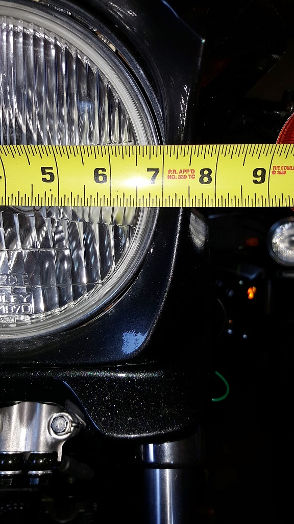

Here's a measure of the headlamp opening on the Venom MkII fairing:

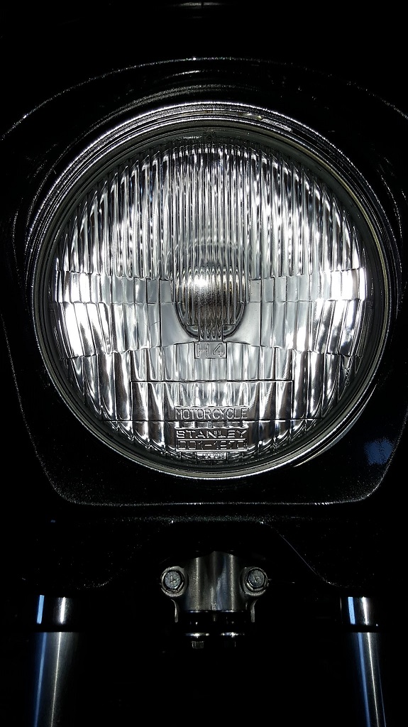

This shows a full front view of the headlamp behind the fairing:
You can see the chrome headlamp bucket is partially eclipsed by the fairing

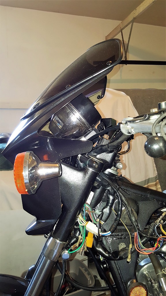

This shows a profile view of the fairing. Notice the turn signal stem mounts and also clearance to handlebar and cables etc:

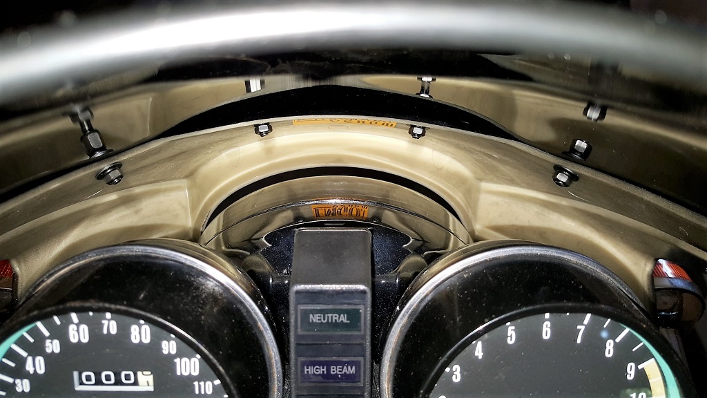

Last pic. This is an inside view of the fairing looking over the gauge cluster. Notice the slight relief I sanded into the upper radius of the headlamp opening. This allows to rotate the headlamp upwards while rotating the fairing downwards (slightly) to drop the headlamp and ring into the bucket:

Even still with all the pictures you took, I think this Venom fairing would clear the handlebars and controls I have better than the Viper fairing I was considering. And looks like with it's rake or angle better clearance for the instruments and master cylinder which appears like yours that you have mounted.
So with an opening at 7" my headlight assembly wouldn't pass thru the hole and would have to be mounted in the same fashion as you did with yours.

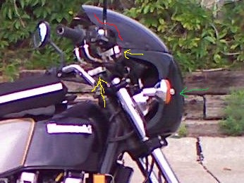

As requested from your p.m.
Best pic of the bike that has been sold.
Red outlines the windshield edge trimmed out for the master cylinder.
Green points out the screw for the supplied bracket that slips in behind the turn signal stalk.
Yellow points to the aluminum strap that is bolted to the handle bars with pipe clamps and the fairing windshield screws.
