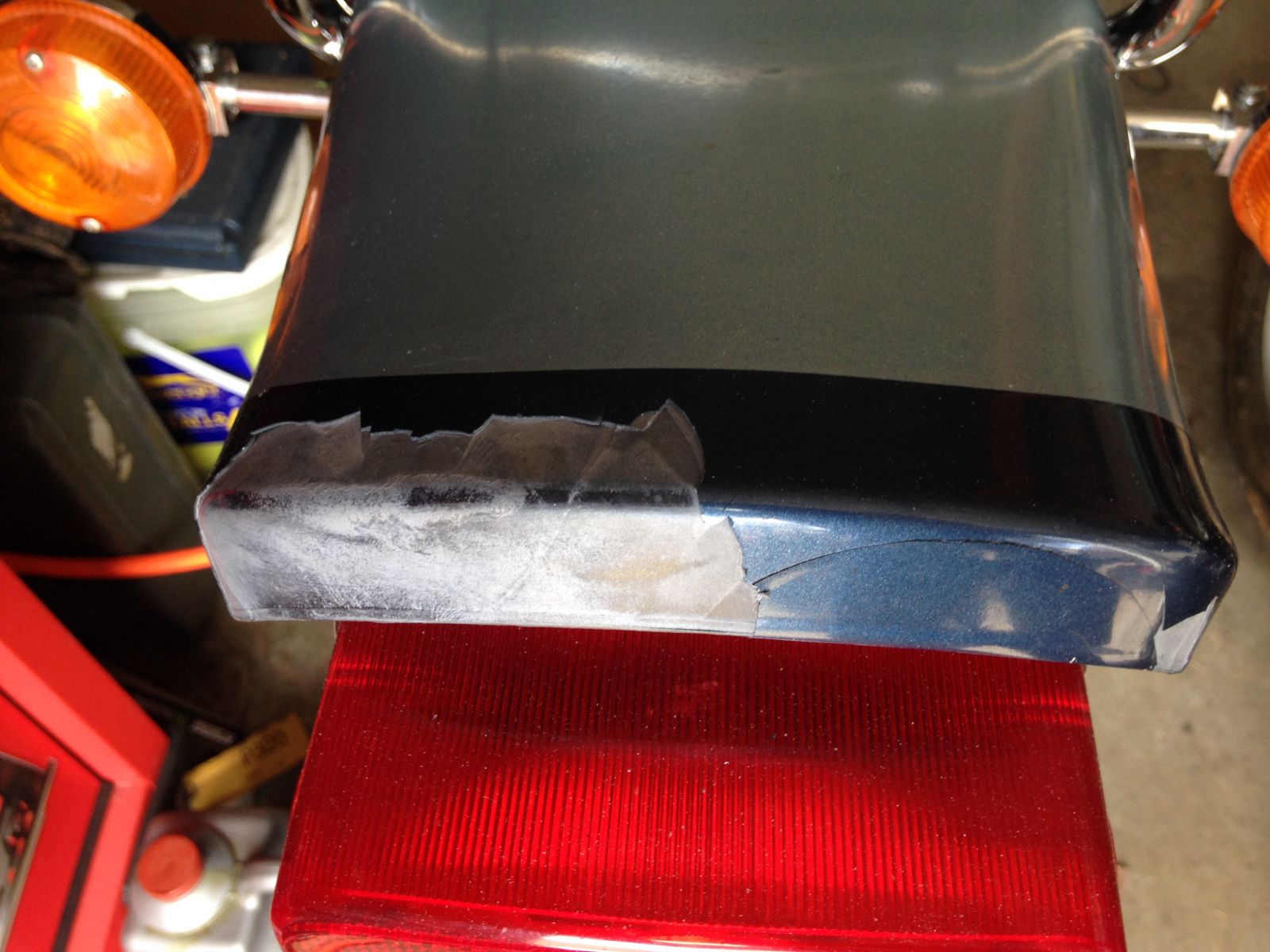

Best way to remove paint
08 Feb 2016 10:09
1978 Kz1000 Z1R. 10K Miles1

Re: Re:Best way to remove paint
08 Feb 2016 10:18
My 1000 had paint like that when I got it. I took a utility razor blade and started chipping and breaking chunks off. Then I hit the tail with some sandpaper to knock off the stubborn places. I was 15 then and had way more time on my hands than I do now.
08 Feb 2016 16:26
Block sand.

Re: Best way to remove paint
08 Feb 2016 19:05
Wet and dry with a block, plenty of water and a dash of dish soap will cut through it the fastest and get a paintable surface.
09 Feb 2016 14:46
I want to remove the paint completely.
Down to the plastic...guess I'll use a sander being carefull and putty the imperfections .
09 Feb 2016 15:02
That's on there thick someone primed heavy 1 or 2 colors then clear!
I hate those paint jobs. I had bought a bike way back when Dupont "IMRON" paint was out. That stuff was the hardest stuff.
I break down and buy the " aircraft stripper for plastic".
That's all got to come off! No feather edging that one!
Are the 2 side covers the same? Or you just painting the tail?
09 Feb 2016 15:06
Tail piece and both side covers will be strip of the paint . Tank is done...
09 Feb 2016 15:18
Hope you don't have arthritus! Your hands will be locking up. I also would turn the pressure down in the glass bead cabinet.
Use some worn out glas , and clean out the seams and folds, grooves on the side covers.
I always had to have the paint as best as I could get it to show quality.
Maybe some of the new Vapor or soda blasting even crushed walnuts work for media blasting
09 Feb 2016 15:24 - 09 Feb 2016 16:31
I strip plastic of paint by soaking the part for a while in used brake fluid or rags soaked in brake fluid and applied to the surface. It will bubble and lift and scrape off easily in sheets.
09 Feb 2016 15:33
Yes, That's a good idea. even new fluid, cheaper than a gallon of stripper!
09 Feb 2016 15:34
I'd first try to chip off as much paint as possible. The chips showing at present suggest there is some hope with this approach. Then I'd take a small DA with some 100 grit paper and have at it.
09 Feb 2016 15:53
Soaking the parts in those liquids won't weaking the plastic?
