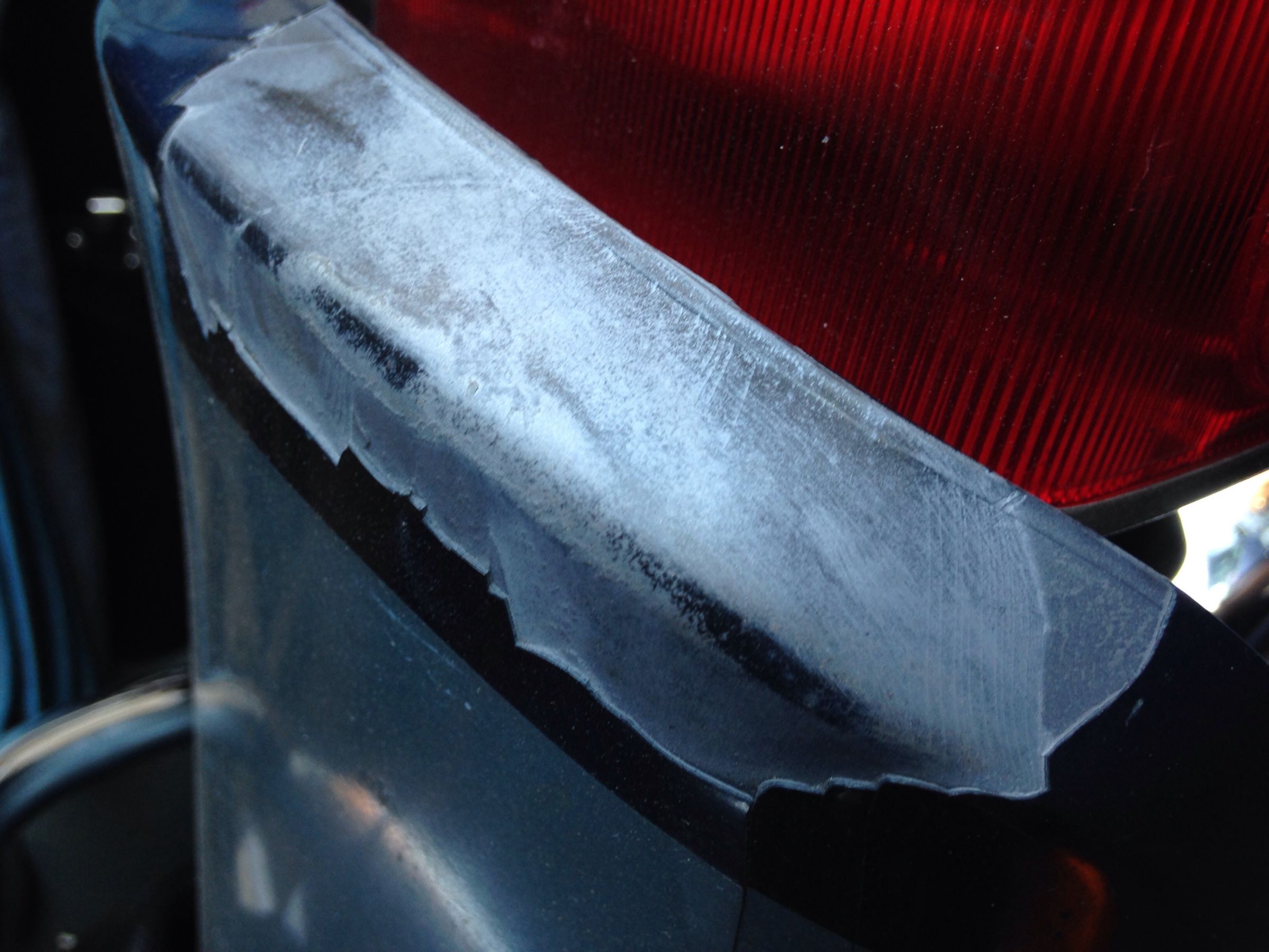

19 Feb 2016 14:47 - 19 Feb 2016 14:49Alright guys....thx for the replies. This is what I'm working with.....don't know much about paint but I do know that I can save a lot of money if I can prepare it .

First just try chipping it away with a utility knife blade to see if it chips away easily. It sure looks like it will pop right off since the super thick repaint looks like the primer is already separated from the factory paint in the photos.
