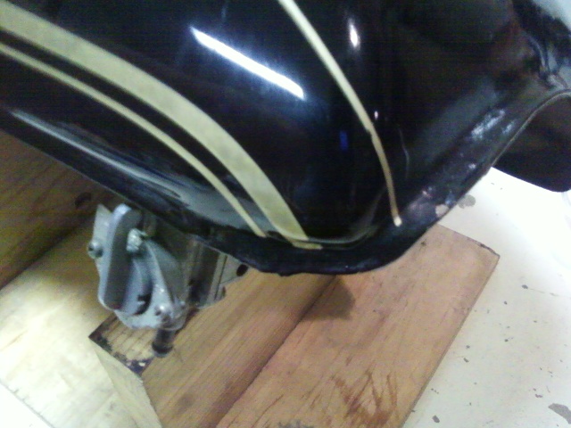

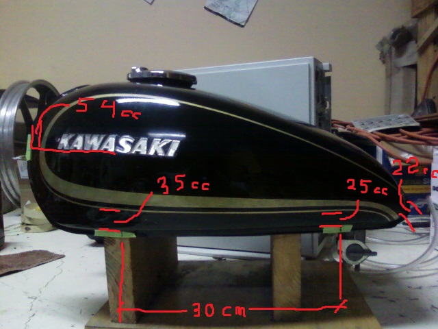

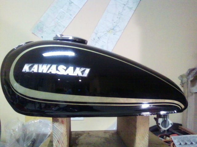

Here's a couple pics of the tank, I haven''t been able to locate my caliper, it is with all my other permission measuring tools :pinch:
Hang in there I'm still digging

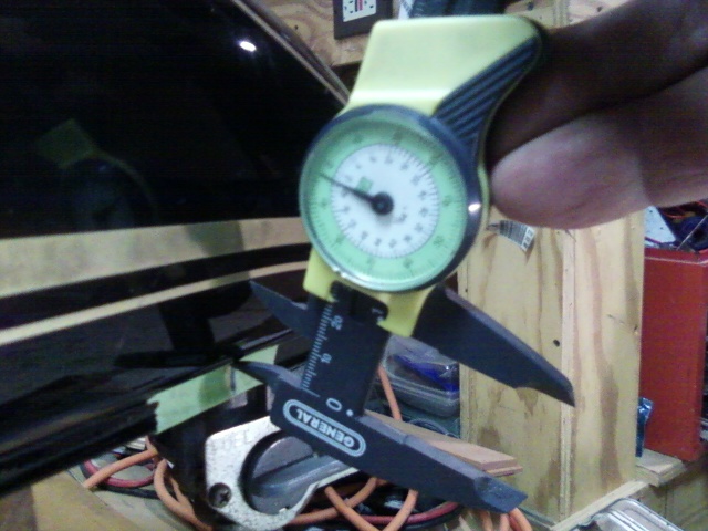

From the leading edge of the fuel tap to the forward measurement is 30 cm

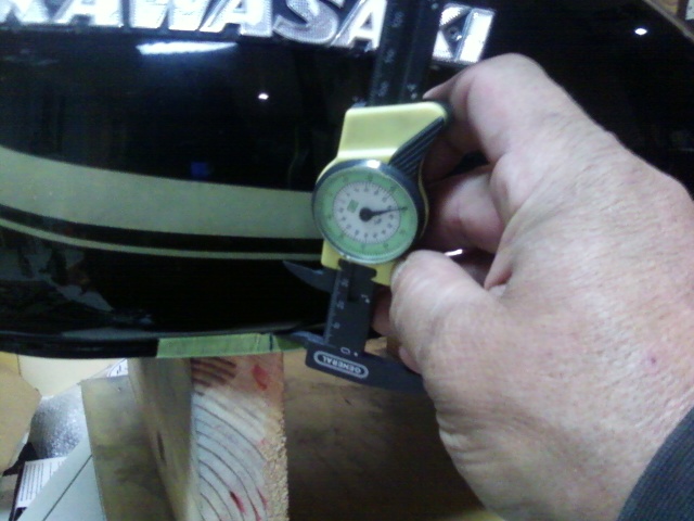

The forward measurement up from the crease to the stripe is 35 mm
The the back measurement by the tap is from the crease to the stripe 25mm

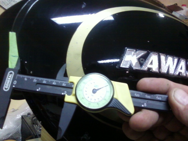

The measurement even with bottom of the Kawasaki emblem from the crease to the stripe 54 mm

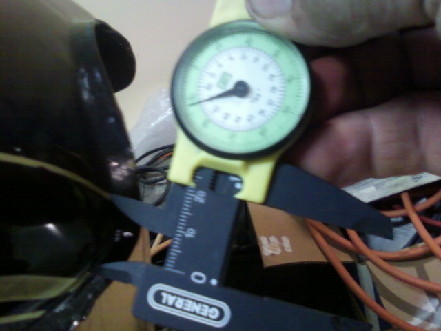

At the back of the tank were the 2 strips come together (in the crease) 22 mm between the stripes.
Good luck

That's great! Thanks for taking your time to do this, greatly appreciated
