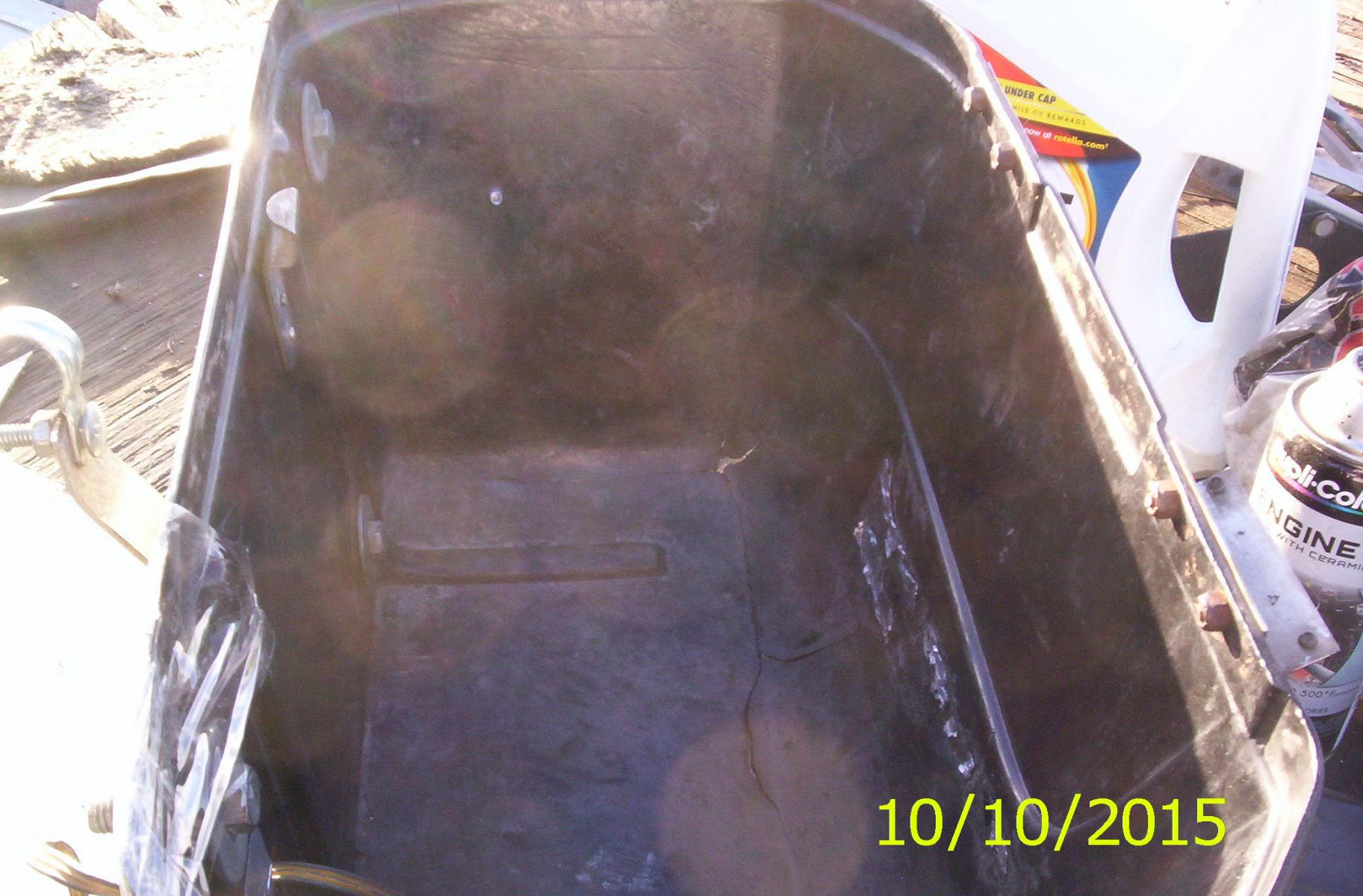

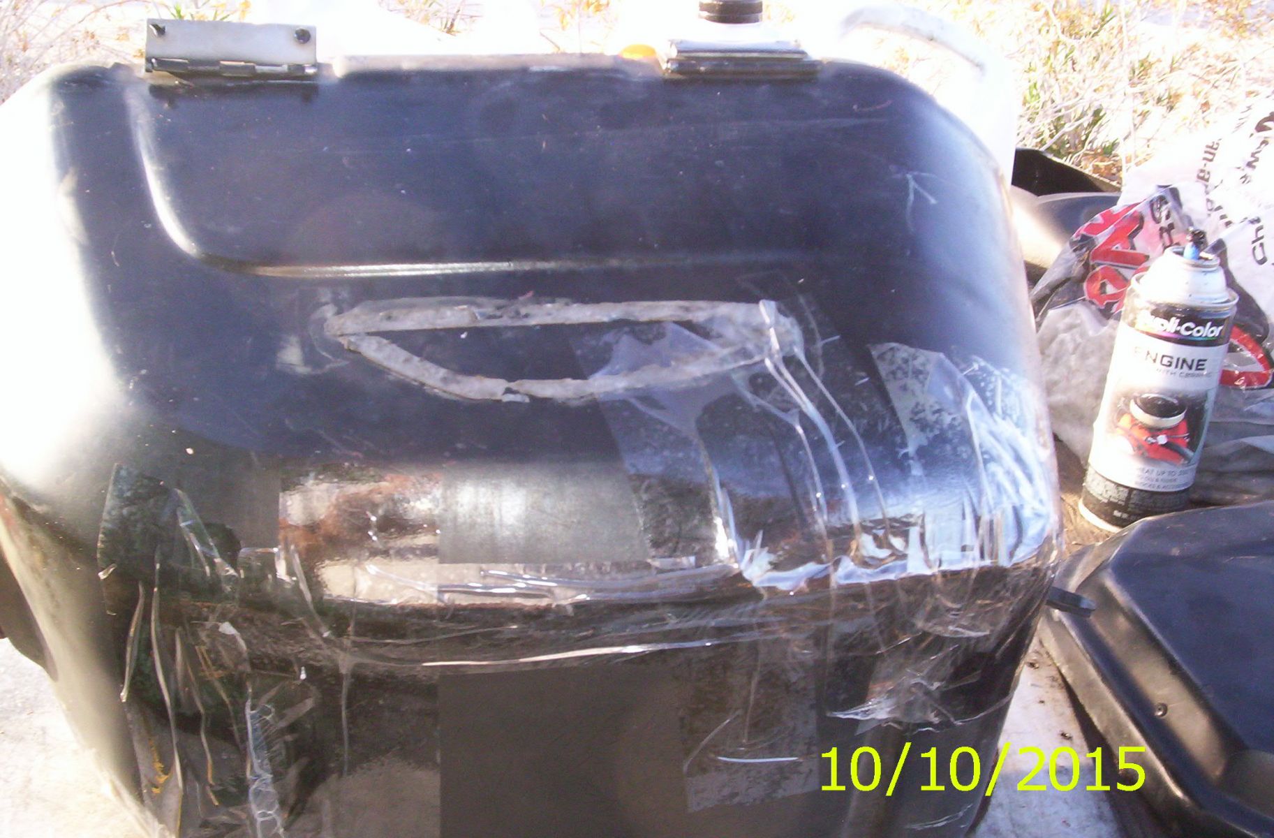

As suggested I'm starting a new thread on my boxes repairs. Last night I was able to use my heat gun to get the cracks to match. There is a gap where the plastic shrank on the bottom. That will be covered with fiber glass. I'm heading to Depot for supplies.
It will take another cleaning and light sanding to rough up so it will stick.

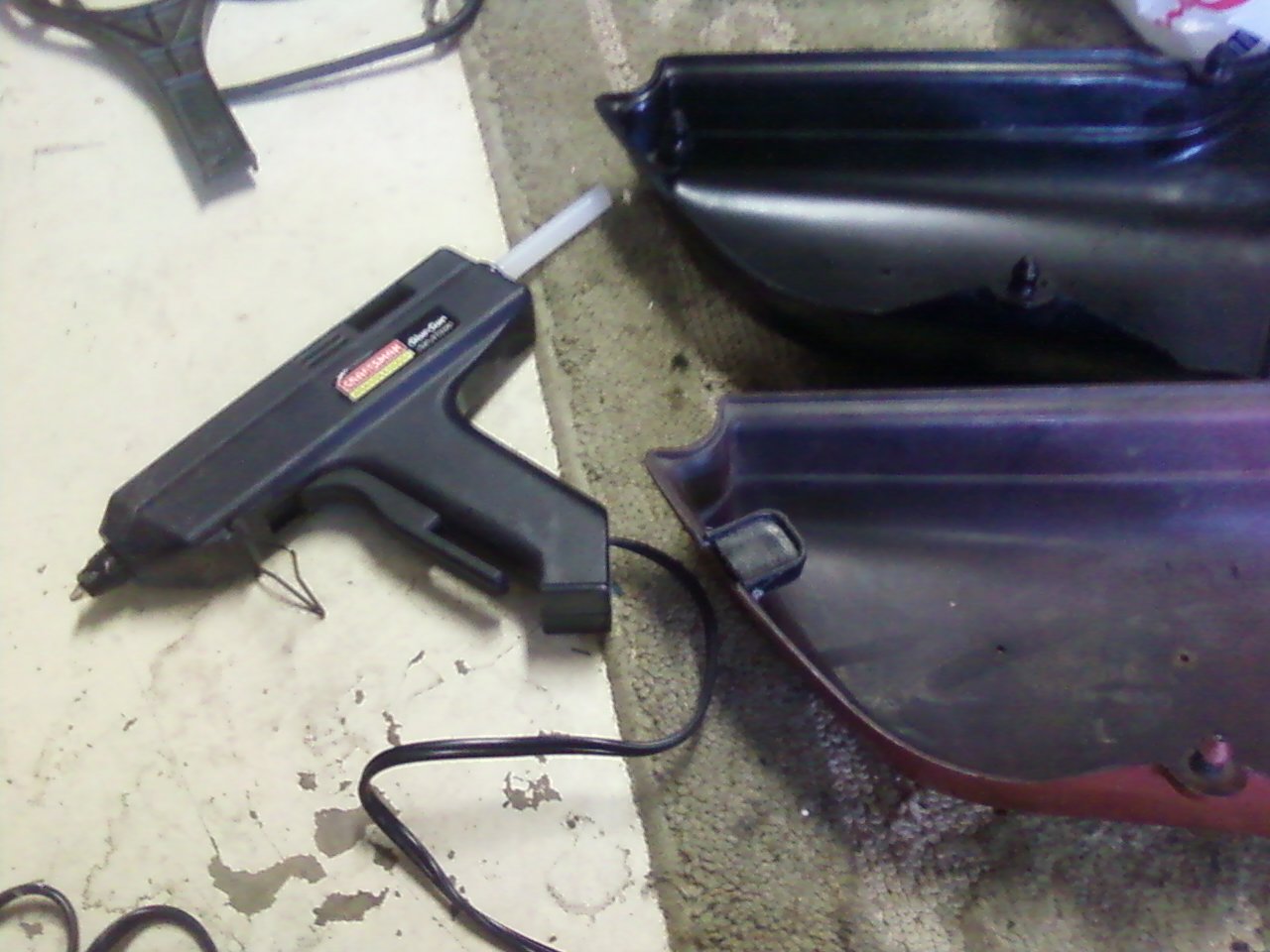

a hot glue gun does a good job of tacking pieces together

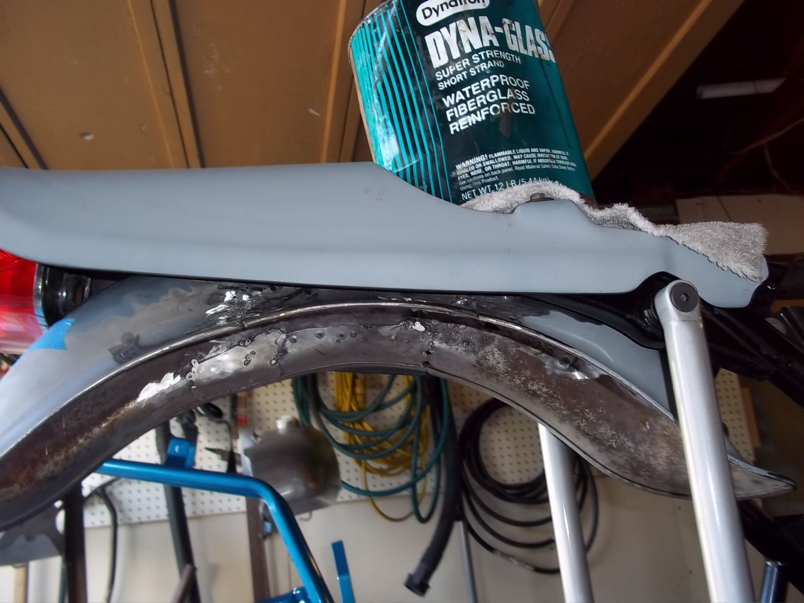

Basic fiberglass resin and fiberglass cloth! They sell kits at all the auto parts stores.
I have this 25 year old gallon of Dyna Hair, fiberglass, reinforced stuff!
Gonna finish my 3 piece fender one of these days!

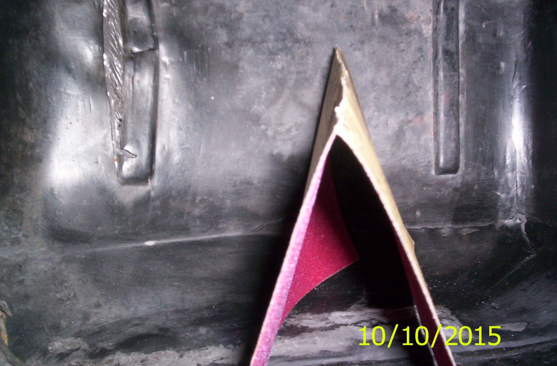

After cleaning with thinner, I roughed up the areas with #100 and #80 paper.
Attachment 001-2.jpg not found
For those that haven't done this before, you fold the paper in half. Fold it back and forth a few times so it will tear easily at the seams.
Fold it again to make 1/4 sheets. They will now fit a sander, sanding block or fold it again to make hand sanding easier.

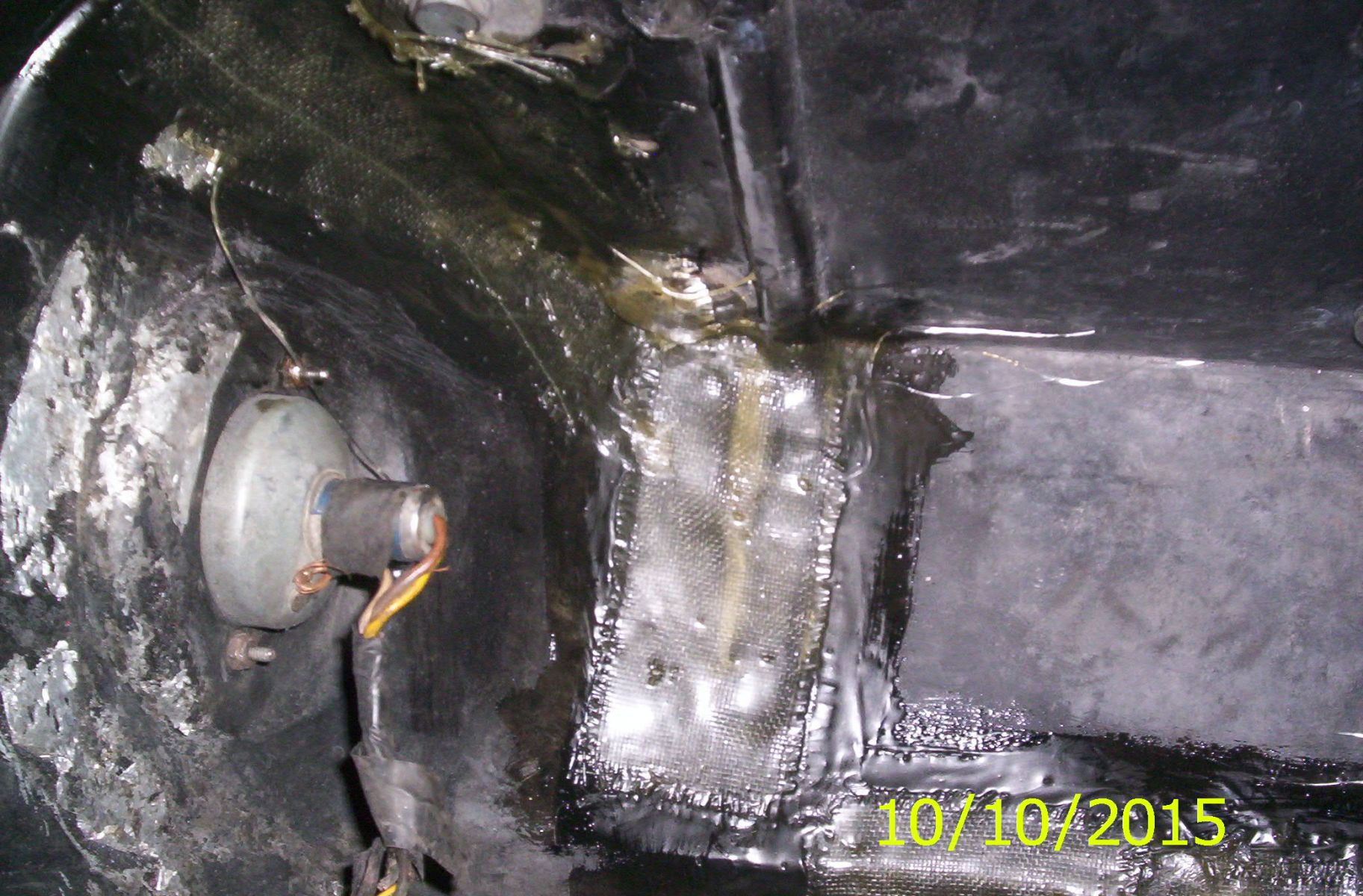

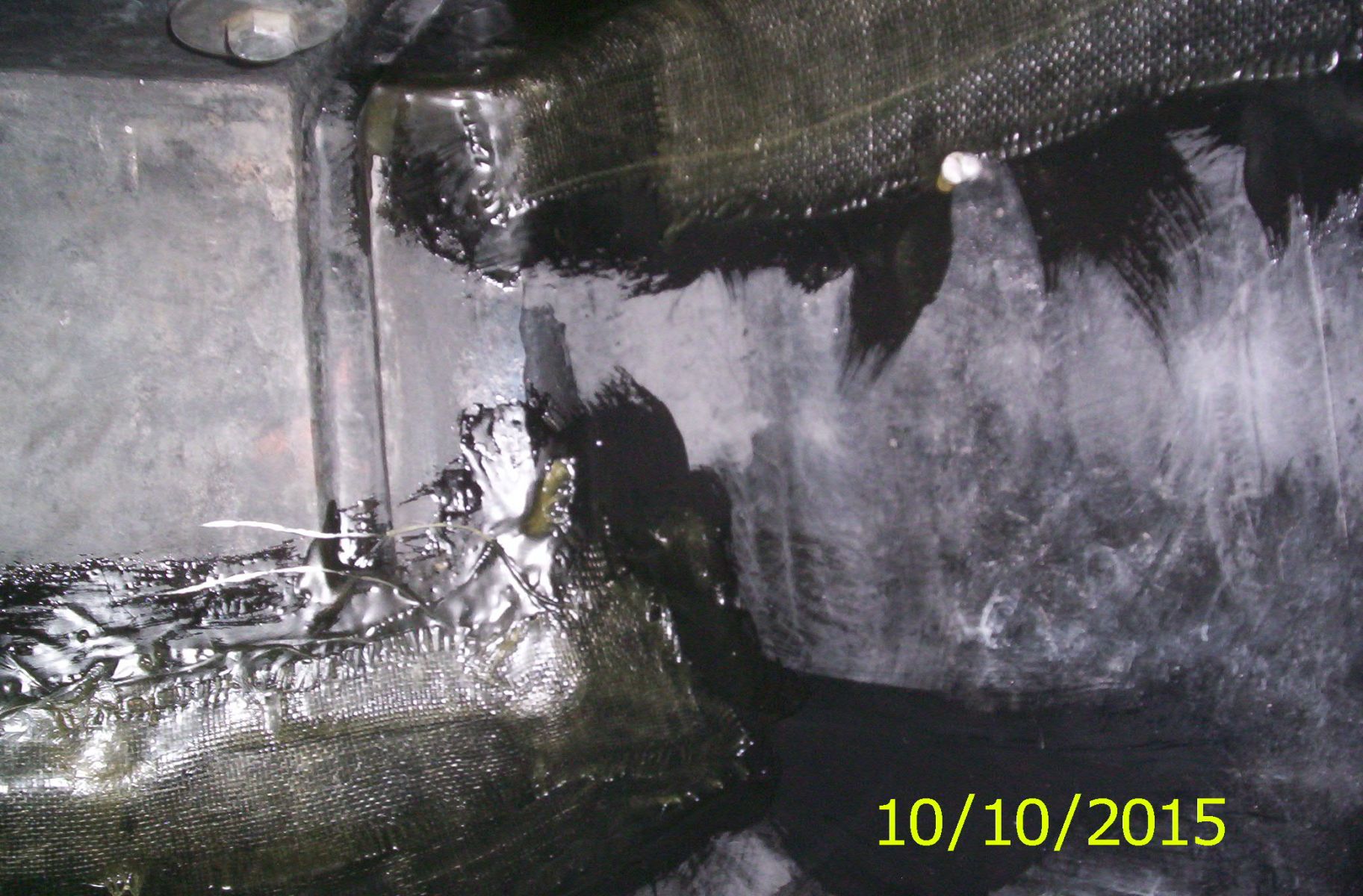

Brushed the thinner and it became like glue. Time to apply the first course of fiber glass.
It'll stick.
Attachment 009.jpg not found
Got in the corners.
Now to let it cure and apply another course.

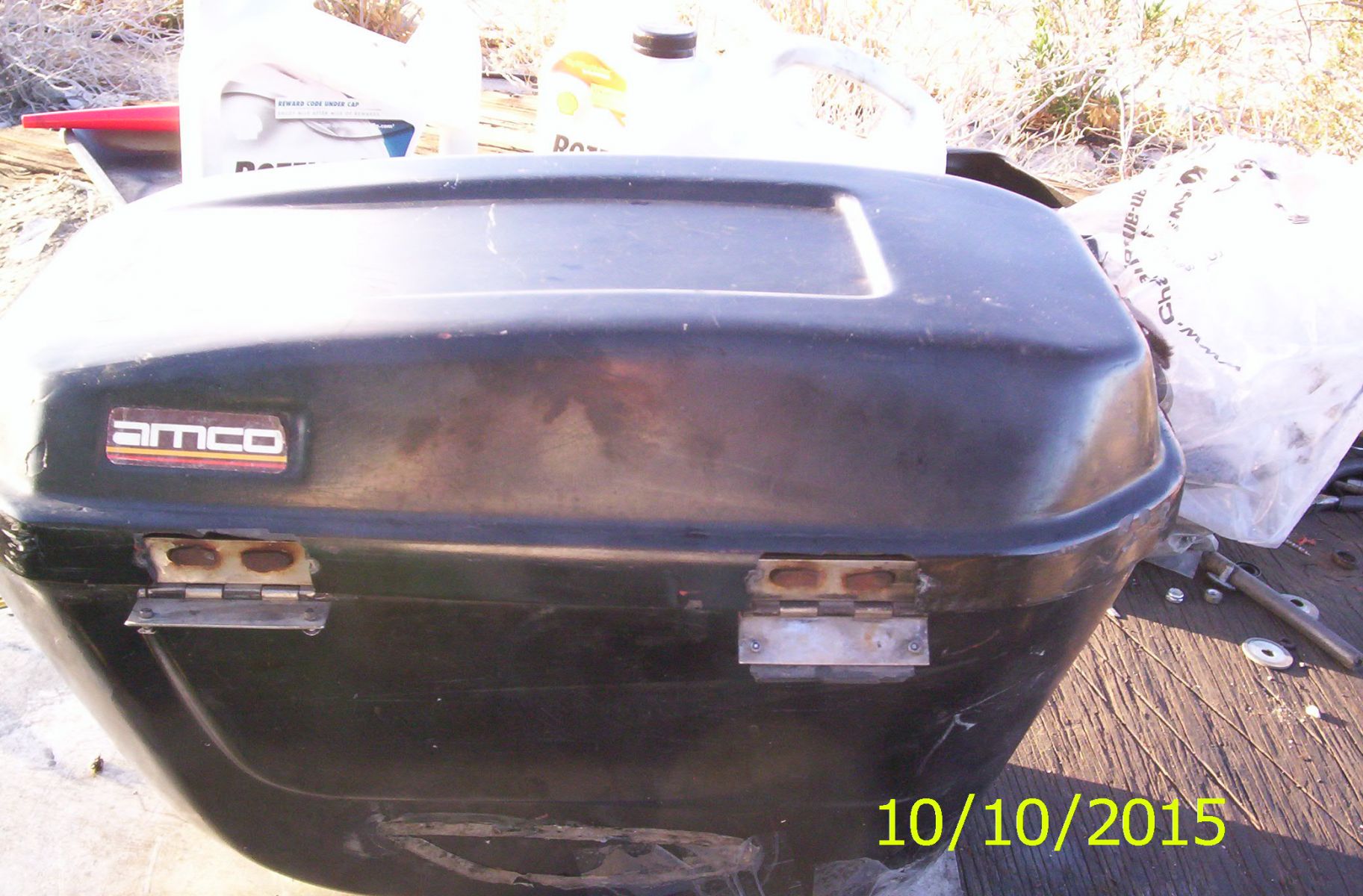

Second course of glass and started on the hinges. Tomorrow I start on the outside. :whistle:

A little light sanding tomorrow and I can paint them. Even fixed some cracks on the other box.
I could spend more time on them and maybe I will later. Have some business to attend to 400 miles away. Need the boxes and a few other things done to do it.
