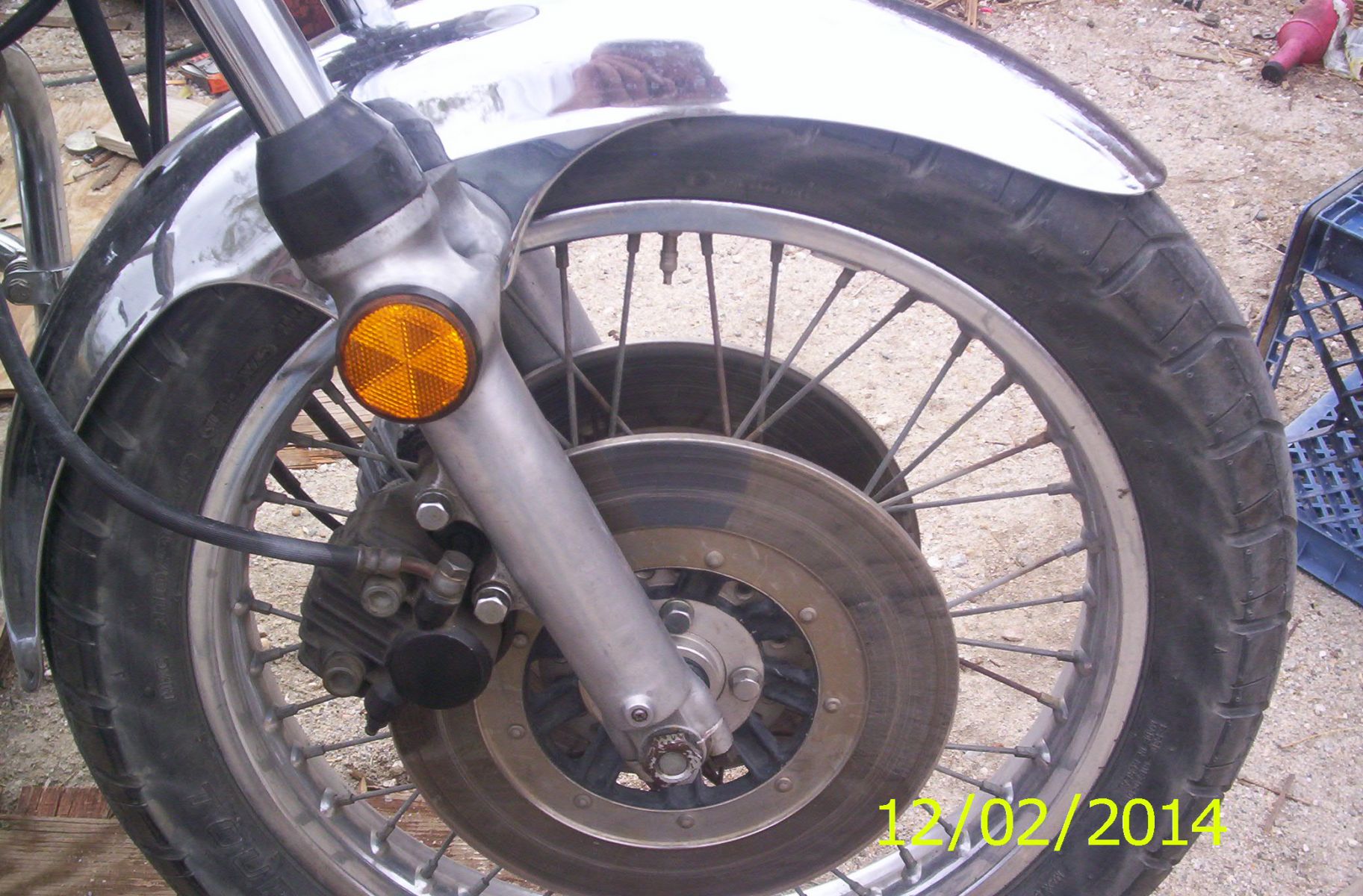

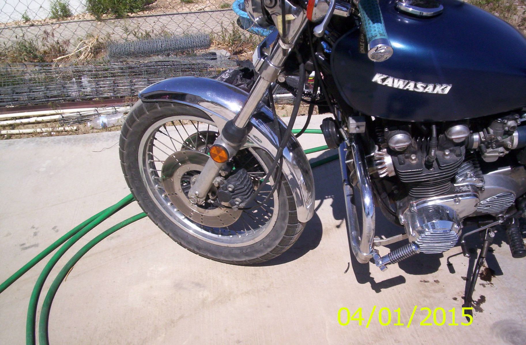

Be super careful cleaning up chrome - wire bristles on chrome can scratch. I suggest a chrome cleaner/polish and 0000 fine steel wool.
The front lower forks are coated. I used 600 and 1200 grit sandpaper with plenty of soapy water to knock out the finish to the aluminum and then I polished the aluminum. My finish was too far gone to look good cleaned up. If you remove the finish be warned it will require up keep in the future.

I'm going to do mine again soon. PITA to clean up after 40 years. The clear coat was flaking off so I used #150 sand paper on a buzz sander and wire wheel for the tight spots. Then I went to #320 wet/dry, then steel wool, course, medium, then fine. I had a lot more to do so I stopped there. This time should be esier and I'll spray some engine clear coat on them. Still look good so not a priority.
