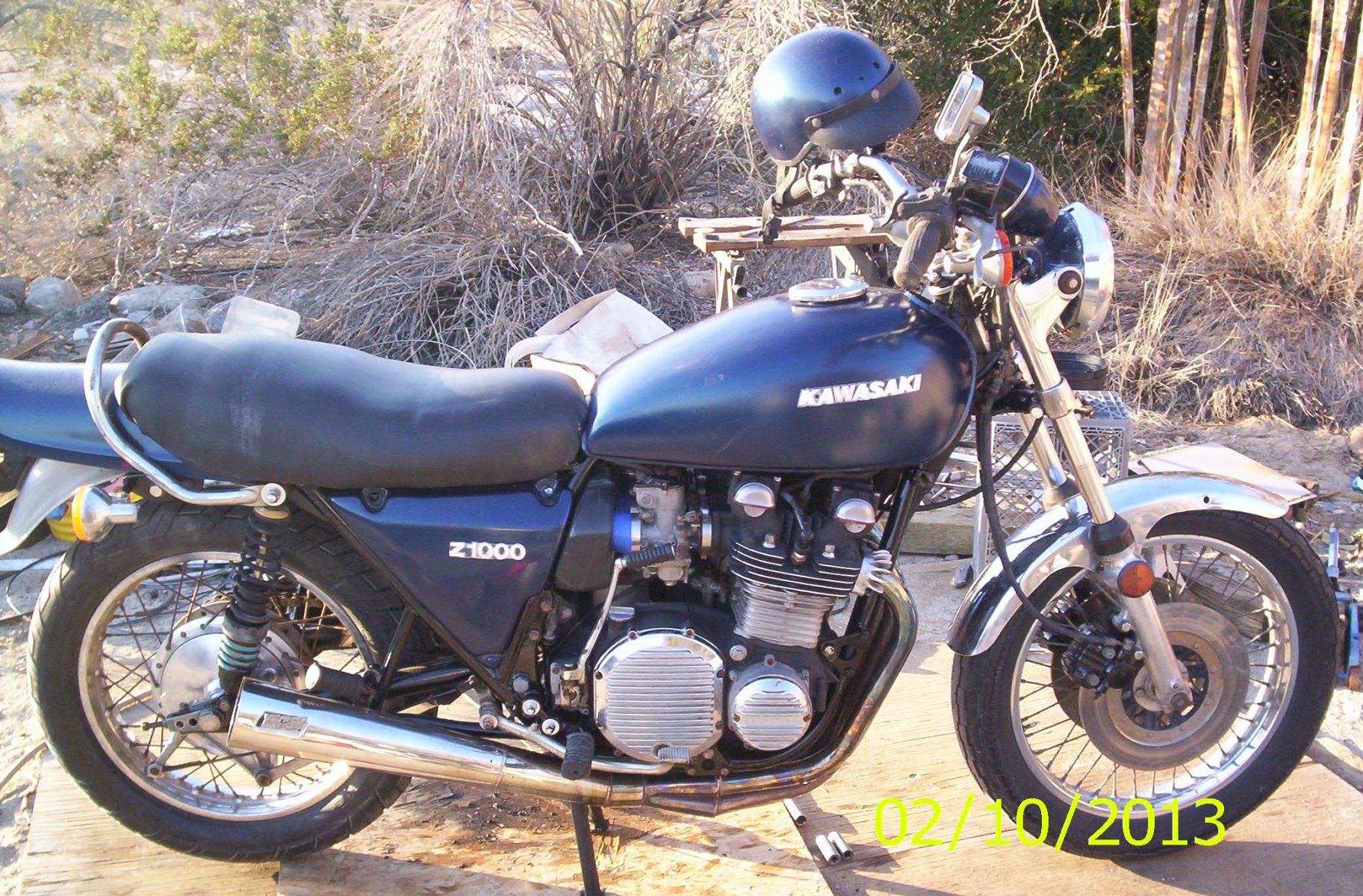

I love my 2 1/2" to 3" high Euro touring bars on my KZ1000.
I did 60 miles yesterday and another 148 miles in the mountains today.... around 900 miles now since the overhaul and it is starting to kick some serious ass.
