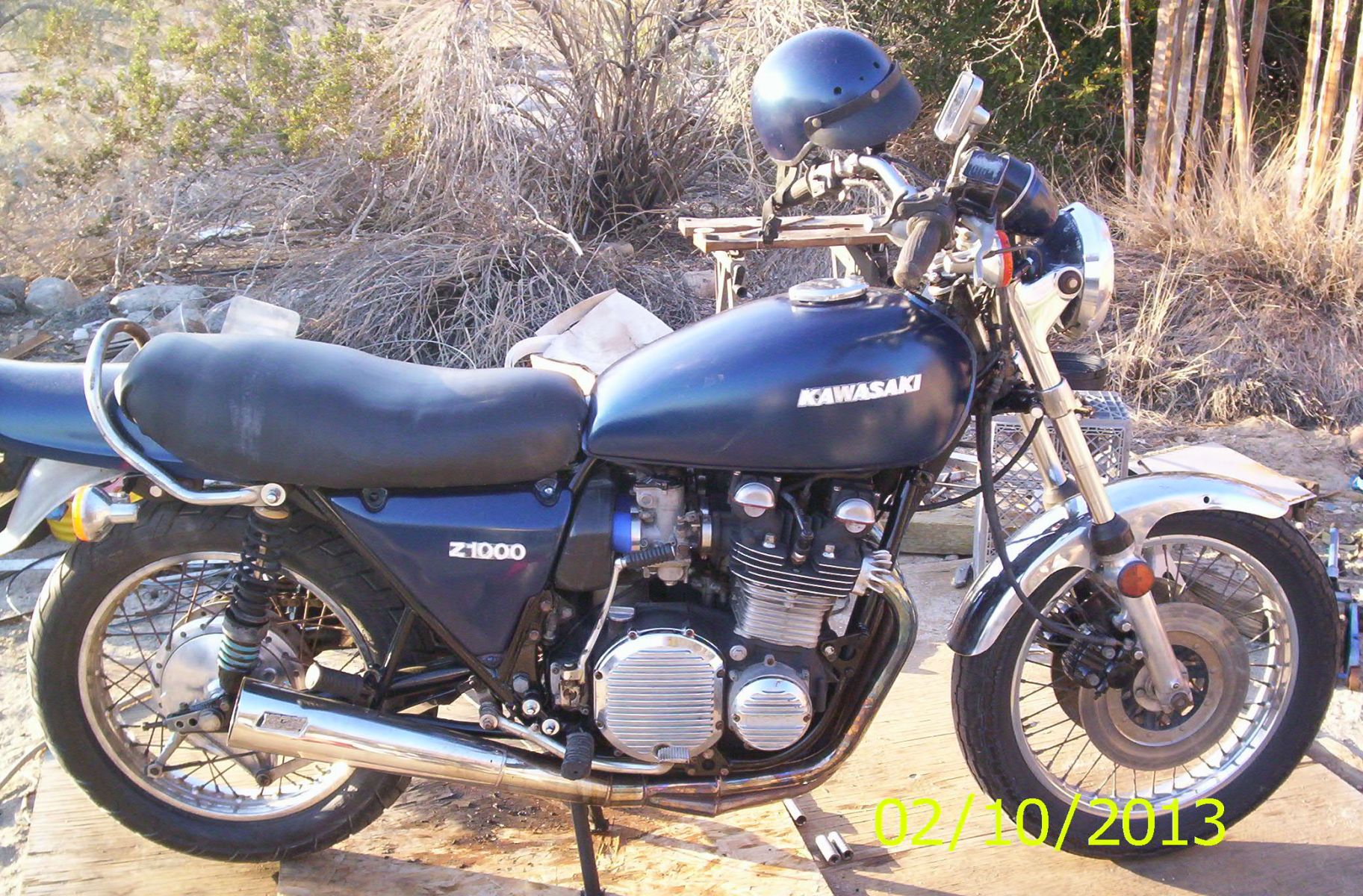

I love my 2 1/2" to 3" high Euro touring bars on my KZ1000.
I did 60 miles yesterday and another 148 miles in the mountains today.... around 900 miles now since the overhaul and it is starting to kick some serious ass.

Rings starting to seat. What kind of cams?
