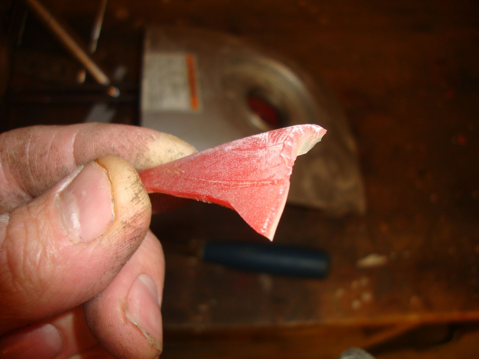

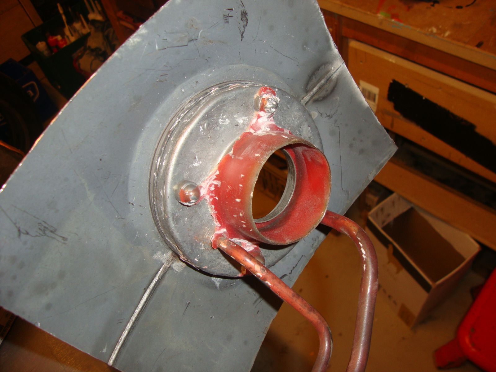

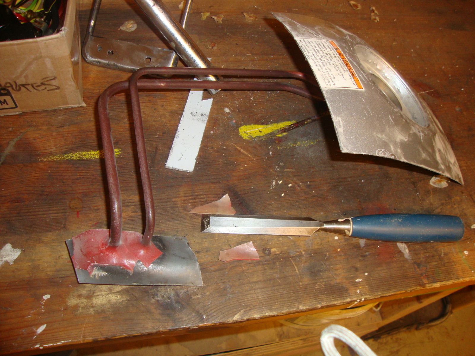

My local bike shop were throwing out an old Bandit tank because the liner had started to seperate. I borrowed the grinder and hacked it up for the 'aircraft' type tank filler top thing for my project. I had to take an old chisel to it to get the liner off
This is tough stuff! You could make a fairing out of it!!
The good thing here is I could get at it with a hammer and chisel, not something you can do. Unless you cut the bottom out you could clean it up and weld it back in. A bit extreme maybe but it would give you the chance to fix the holes that led to tank liner in the first place.
Good luck with it.
