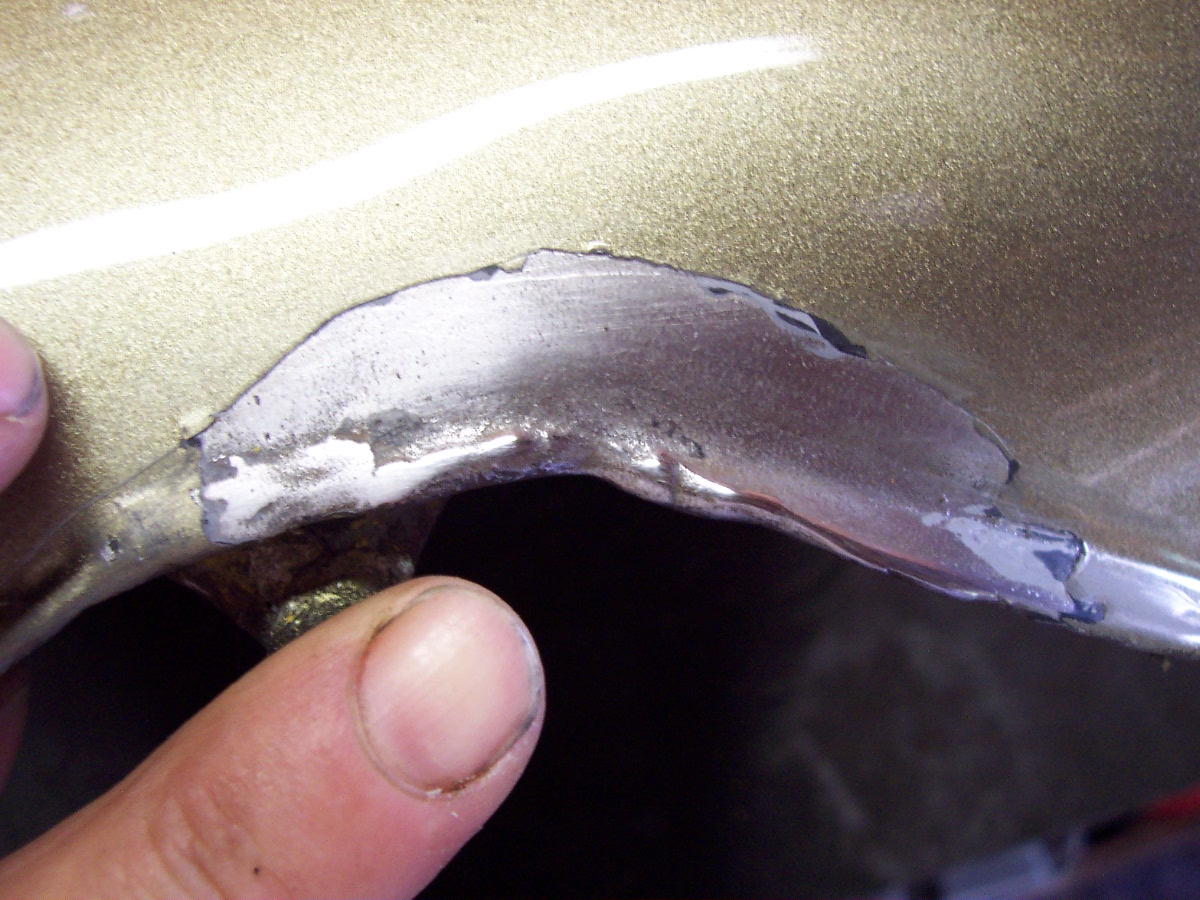

BAM!!! I find the gas smell. Crack in tank weld under the front of the seat by the hold down

Here is crack area

If the tank appears solid other than that split you can have it brazed. Be sure the person brazing it has done other fuel tanks so he will know how to properly flush the fuel & fumes so he doesn't blow it (and himself) up. Ed

Caswell Plating has a kit that might do what you want. That way, you save the paint job. If it doesn't work, sounds like application of heat and molten metal is your final option.

I have heard (I actually have no direct experience, BTW) that Kreem tank liner, if applied correctly, will stop small leaks. I am also aware that there are numerous complaints about failure of the Kreem product to set-up properly...but that may be user error. I have also heard great things about the redcoat liner, but that there may also be application issues that will impact the paint scheme (again I have no direct experience).

+1 for the caswell plating kit. I used that on a friends tank for him. Zero problems in 4 years. prep is very important with any of the lining kits

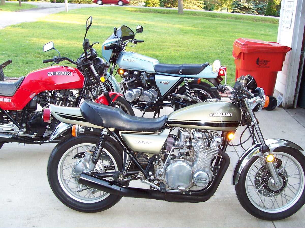

What is Suzuki paint code? Looks great!

Have you repaired your tank yet Greg ? I've been successful repairing tanks in the past. I like to flush the tank out and the keep a constant airflow going into the tank and exiting the petcock hole. Tig weld it and you'll be ready for touch up paint.
