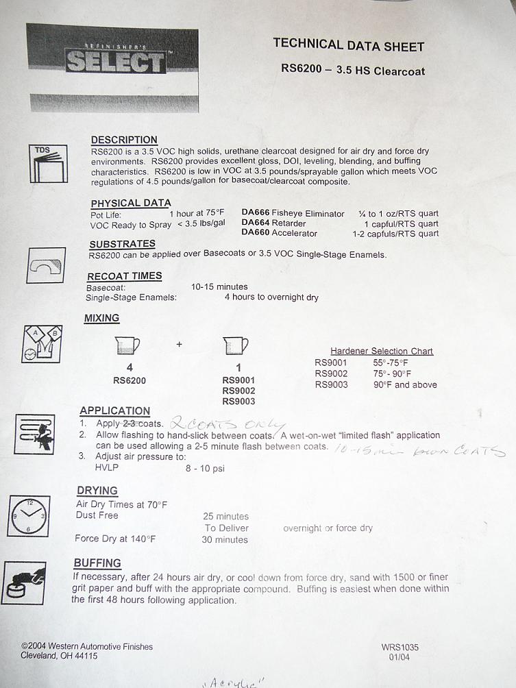

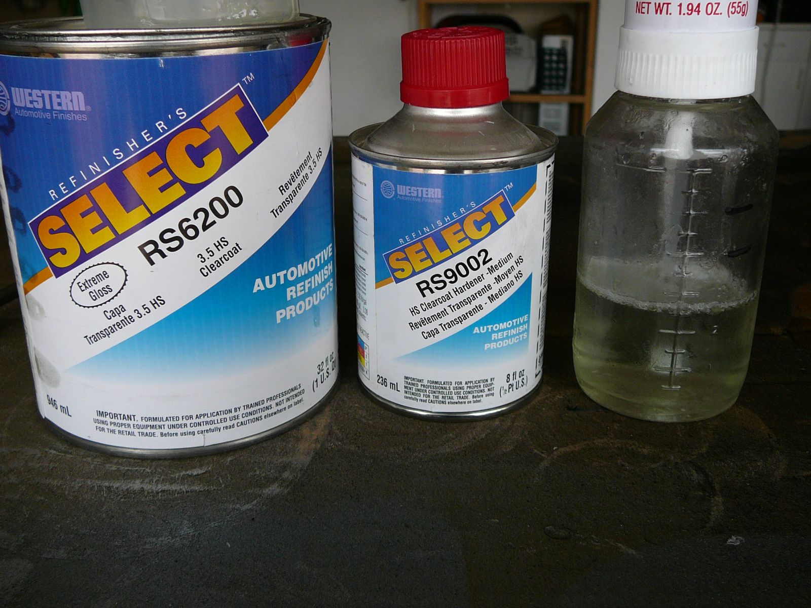

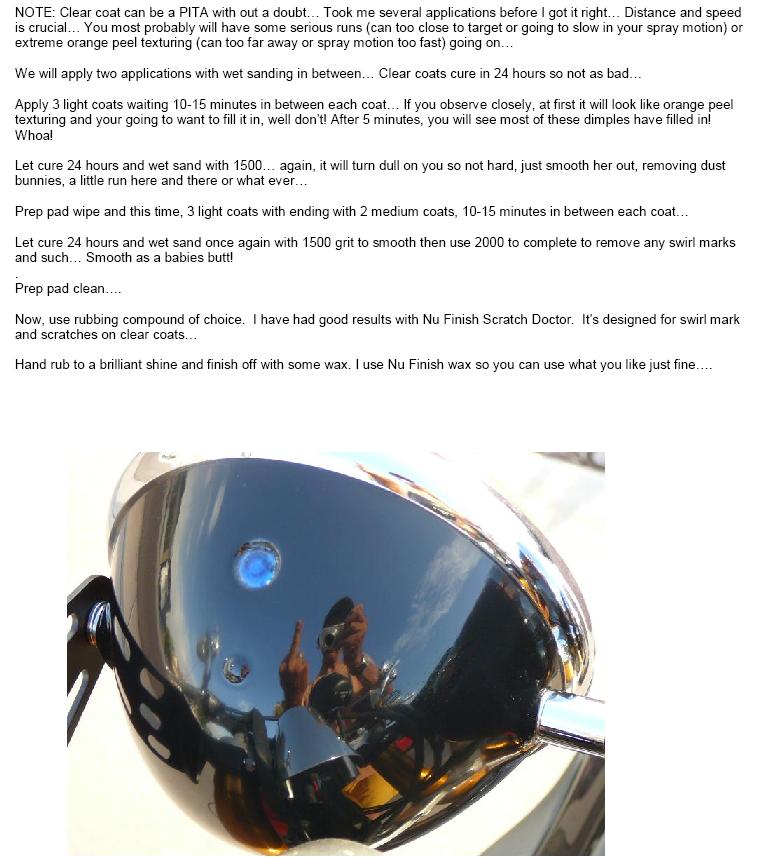

Re: My rattle can work
19 Jan 2013 21:55 - 19 Jan 2013 22:00
Why take a chance of ruining a fine paint job....
Wet sand her down, prep and 2-part clear coat her...
She'll be like glass!...
