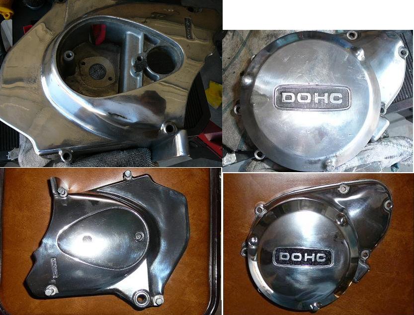

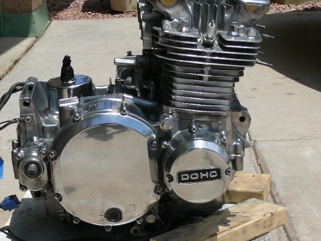

Very very nice!! That is exactly what I am trying to achive with my 76 A4. Can you tell me more about the soda blasting? What did you have to do to build your soda blasting equipment? Are you using a sand blaster and just using baking soda instead of sand? Im sorry I know it is alot of questions but I really would like my engine to look like yours and this is the biggest hurdle in my resto.

I haven't tried the soda blasting yet, but I'm going to. There was some posts about it here, and it involved a Harbor Freight solvent sprayer and a box of baking soda. I bought the sprayer, and I've since found out I can buy a fifty pound bag of sodium bicarbonate at the local feed store for 13 bucks. I'll be doing that pretty soon.
I just finished removing the paint and polishing my upper triple. And I'm experimenting with trying to maintain that high shine with some stuff called U-Pol. Gets good reviews from auto body pros: www.autobodytoolmart.com/u-pol-clear-1-h...-up0796-p-15130.aspx

Hi and i am new to the site and i am just starting to restoring a 1978 KZ 750 twin that is really in not to bad of shape but has been sitting for over 3 years in a heated garage. the engine casings look ok, but lack the shine as in your pictures.I was curious on the baking soda method you have mentioned as i know how long and hard using never dull or things like that take and still never look all that great. did you have to buy some sort of blasting unit ? or did you just build one somehow? will a small detail sandblaster work with baking soda instead of sand? did you just use regular polish after the blasting? or is there a link somewhere explaining the process and how to do it that you know of? I want to redo the bike and paint it white so it has that vintage look and the stock chrome and Spoke wheels pop with a shiny power plant. Thanks for any help or info you could guide me to and what a great site!!!

24 Jan 2013 01:15 - 24 Jan 2013 01:16lakesguypaul wrote: Hi and i am new to the site and i am just starting to restoring a 1978 KZ 750 twin that is really in not to bad of shape but has been sitting for over 3 years in a heated garage. the engine casings look ok, but lack the shine as in your pictures.I was curious on the baking soda method you have mentioned as i know how long and hard using never dull or things like that take and still never look all that great. did you have to buy some sort of blasting unit ? or did you just build one somehow? will a small detail sandblaster work with baking soda instead of sand? did you just use regular polish after the blasting? or is there a link somewhere explaining the process and how to do it that you know of? I want to redo the bike and paint it white so it has that vintage look and the stock chrome and Spoke wheels pop with a shiny power plant. Thanks for any help or info you could guide me to and what a great site!!!
If it's just normal oxidation and not too bad I say polish it by hand and avoid the mess of blasting. As you say, it takes time but so does blasting when you consider plugging everything up, possibly taking things apart, and cleanup or re-assembly. Once finished it's very easy to maintain the shine. I'm not sure what level of shine you are trying to achieve, but hand polishing looks good enough for me.

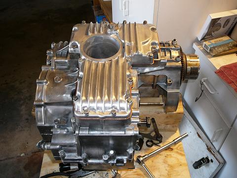

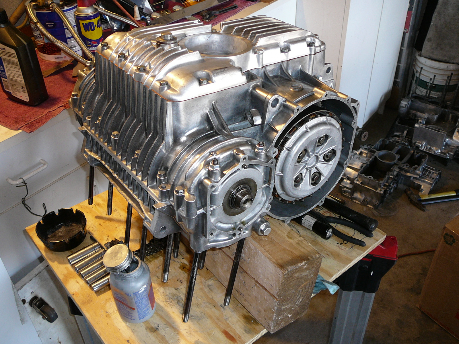

Absolutely gorgeous ED....
I'm with you, time with your girl and a little elbow grease, all better...

OMR - Thanks, but I must admit you got me beat! I cannot say I've ever cleaned and polished the inside of my engine, but yours looks great! I bet they didn't look that good inside the day they were made.

OMR. :ohmy: what ratio of h20 to simple green :blink: or used straight out of the container.
