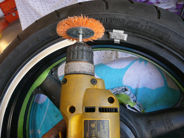

What about for removing white crusty oxidation on the engine fins? I've got some starting to form and I'm wondering what works well for removing that. I've read recommendations of aluminum wheel cleaner. I bought some from the local auto store and it didn't do much.

Nylon wire wheels.....
Orange for tough
Gray for light
Blue for medium...
For extreme oxidization, wheel first then Simple Green...

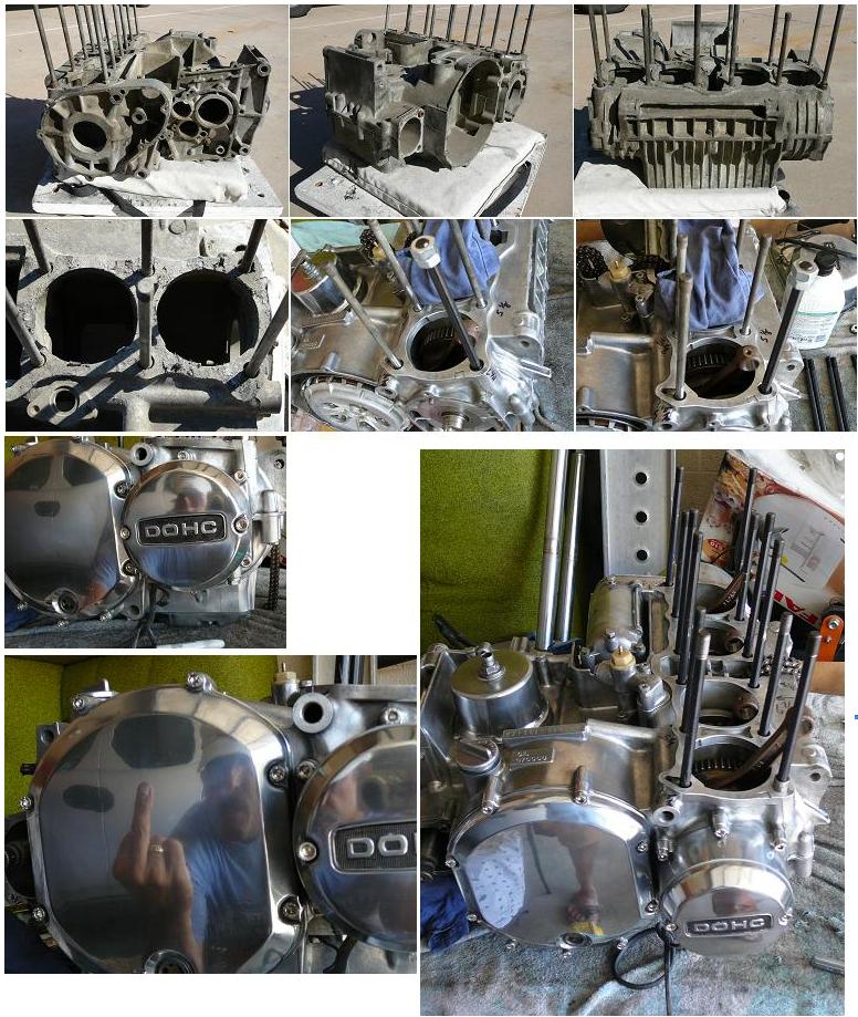

Last build, same procedure = results...
Damn, I should be s spokes person for them.... :blush:
