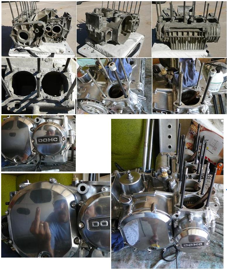

As in those images, simple green after the nylon brush was it..

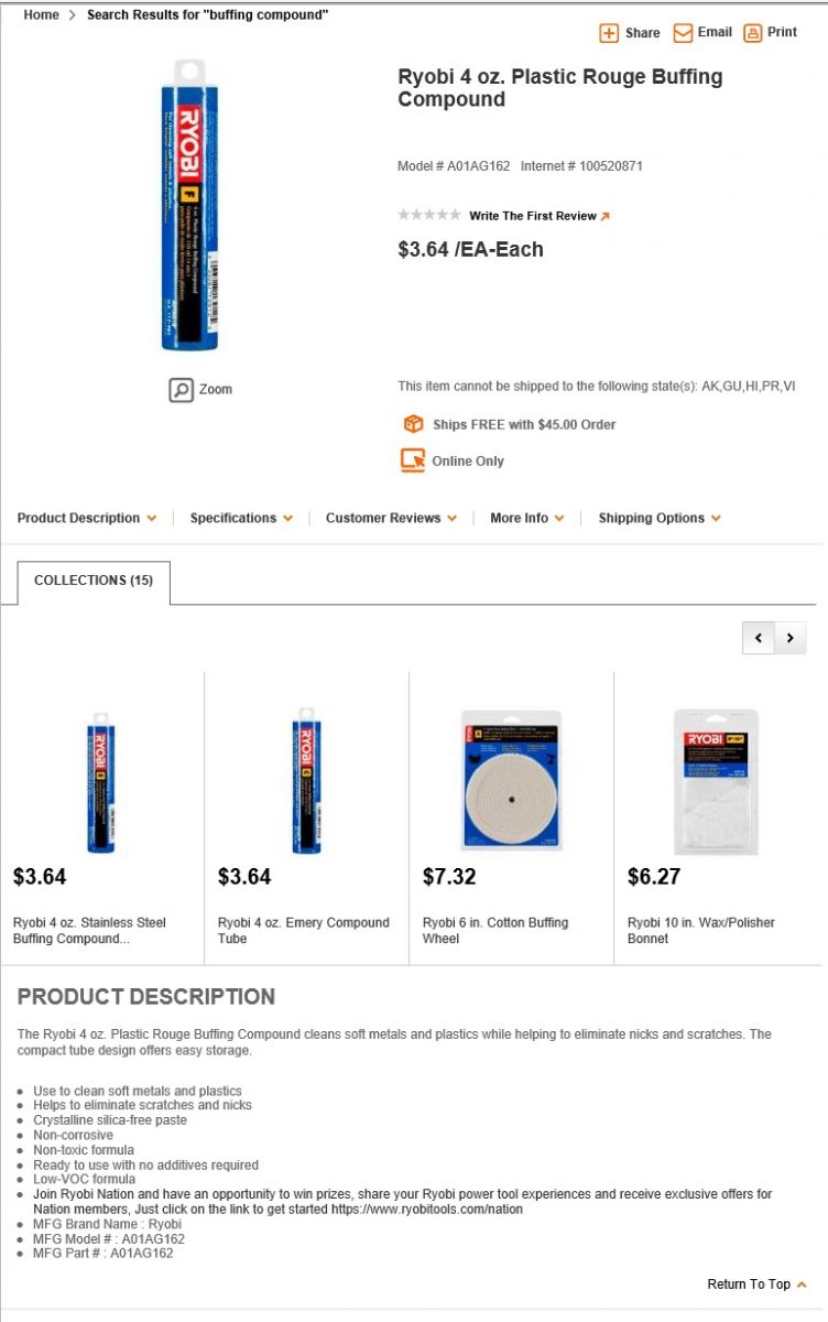

AS for side cases and valve cover I go a tad further with a set from Home Depot... Buff pad on a drill... Start with Ruby then finish off with white compounds.
Then after on the bike, just some aluminum polish here and there to keep a nice shine... I'm not into chrome so buffed aluminum is all I desire.... Anyone can polish aluminum, the ones with buffed/polished aluminum says a lot about their character, pride of ownership etc...

If you are going to have the cases split, consider vaporblasting. I have only found a few places in the US that do it. The surface gets peened and is easier to clean up later. I used this guy:
www.vaporblasting.biz/
Before and after:
Before and after:

30 Jan 2013 00:23Whats that on inside of cylinders? :blink:pig9r wrote: If you are going to have the cases split, consider vaporblasting. I have only found a few places in the US that do it. The surface gets peened and is easier to clean up later. I used this guy: www.vaporblasting.biz/
Before and after:
Re: VERY oxidized engine.
30 Jan 2013 11:27 - 30 Jan 2013 11:28wireman wrote: Whats that on inside of cylinders? :blink:
Looks like rust to me. I'd say it needs some attention before re-assembly. Ed

30 Jan 2013 13:22
It's wasn't rust. They were honed ( by local machine shop) and wiped down with oil. Not sure why it looks that way in the photo though? For what it's worth the cases and jugs don't look that shiny in person either :laugh:
