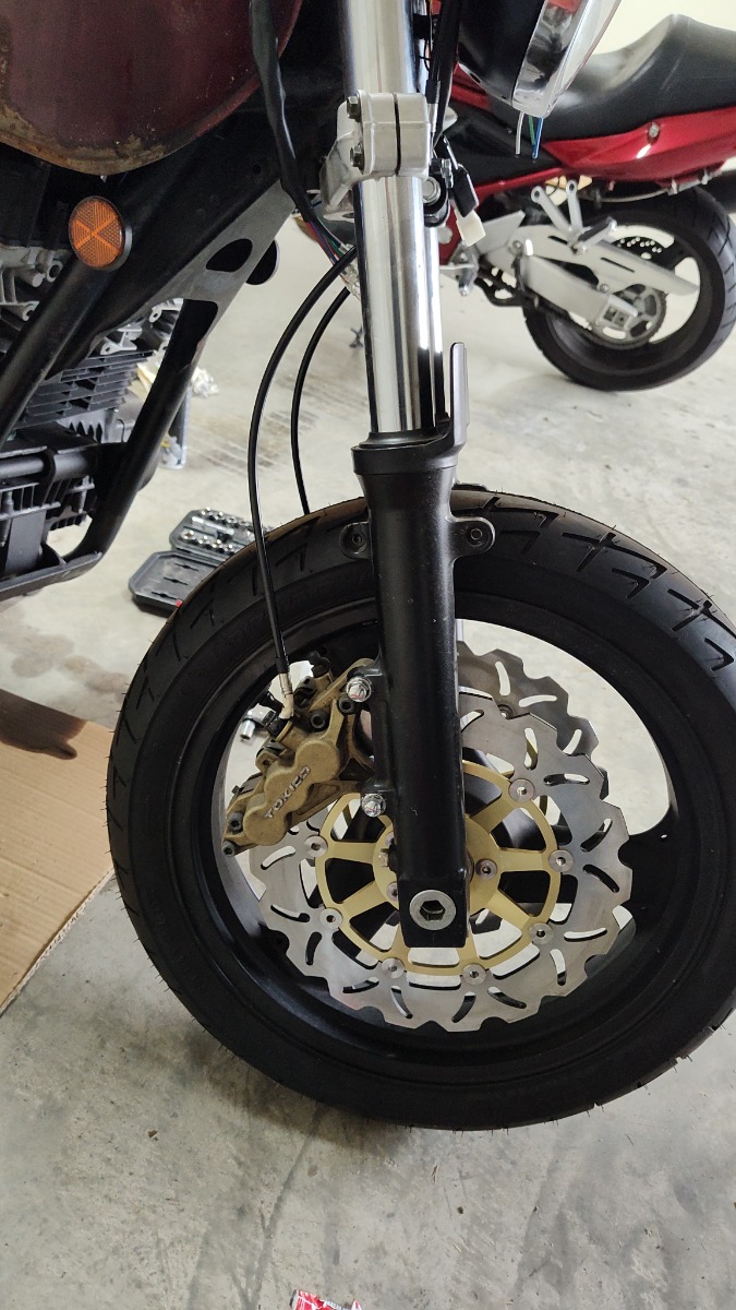

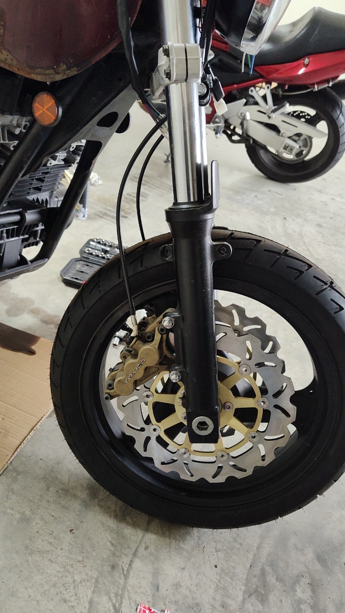

Do you have a ZRX? If so, could you send me some close ups on the front brake line routing, please? I have new ZRX lines from Spiegler, but the banjos have to be rotated to fit. I'm just not sure which end goes to the caliper and or to the brake joint between the forks. also, a picture of the front brake line clamps/holders as I can't seem to find them.

I do have a ZRX, but it does not have the factory brake line setup. Instead of the three-hose factory version, mine has only two lines, each running directly from the mater cylinder to a caliper, thus eliminating the splitter and one hose.

  I got it figured out I believe. Next is rebuilding the calipers .

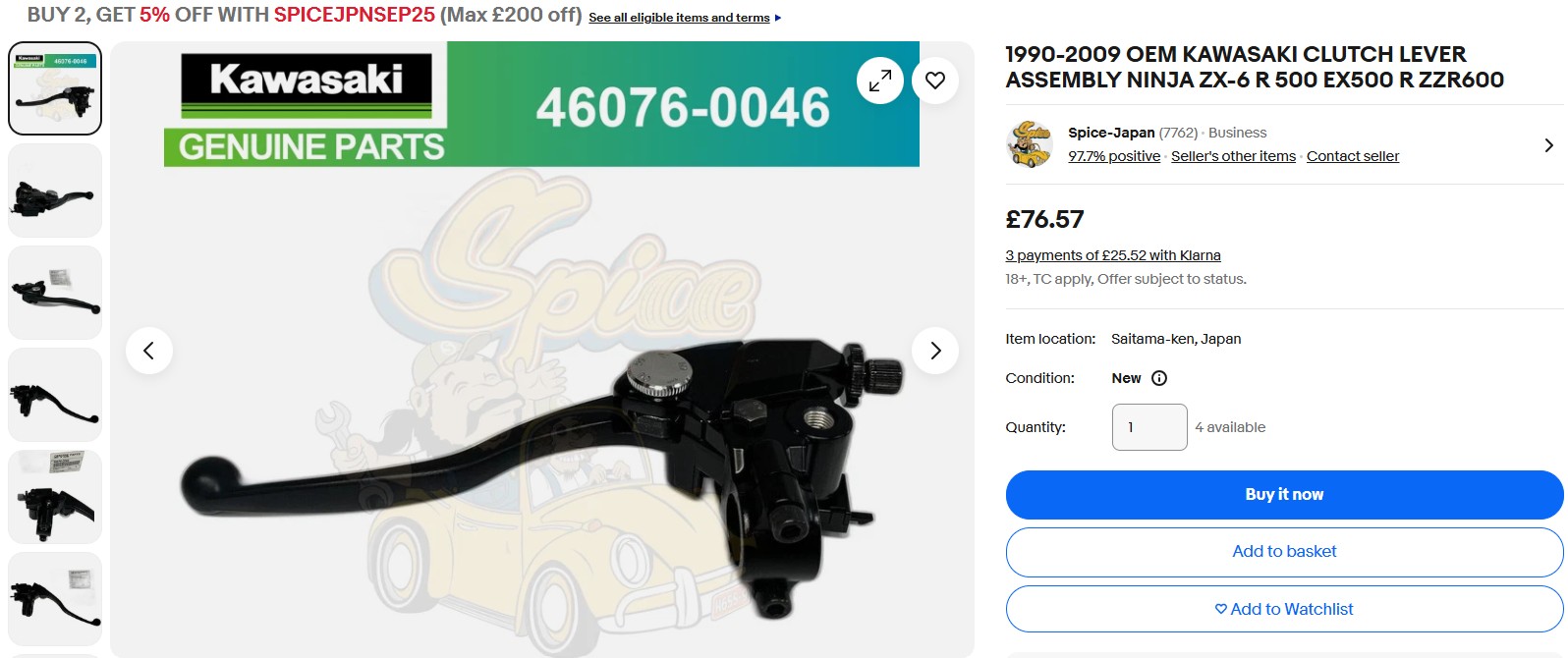

If you chose to go with the ZRX or a 14mm master (EX500 etc) the below is an idea for a clutch perch that would match :)
I purchased both the M/C and clutch perch from the EX500, I believe it will work out well
