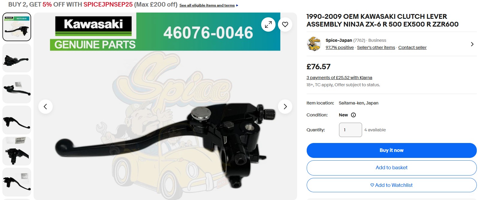

If you chose to go with the ZRX or a 14mm master (EX500 etc) the below is an idea for a clutch perch that would match
The following user(s) said Thank You: Formula264
