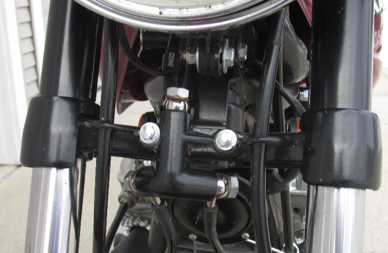

I did a dual disc setup on my '76 750b . My rotors & right side caliper and hanger were supplied by a friend who does lots of work with vintage Hondas and Kawis
so I'm not sure what model those parts were sourced from.
The rotors are drilled and milled to 4.5mm . I used a master cylinder from a 2009 650 Ninja (14mm bore) which also gave me the lever-mounted brake light switch.
Since I got rid of the hydraulic switch I took the stock 3-way splitter and retapped the hole from the switch to accept a banjo bolt. I mounted the splitter upside down,
Ran 1 line from the top to the master and a separate short line from splitter to each caliper. I don't doubt that this has been done many times before but it looks good
and I'm very pleased with how well the brakes work . I hope it's OK to post a pic here.
