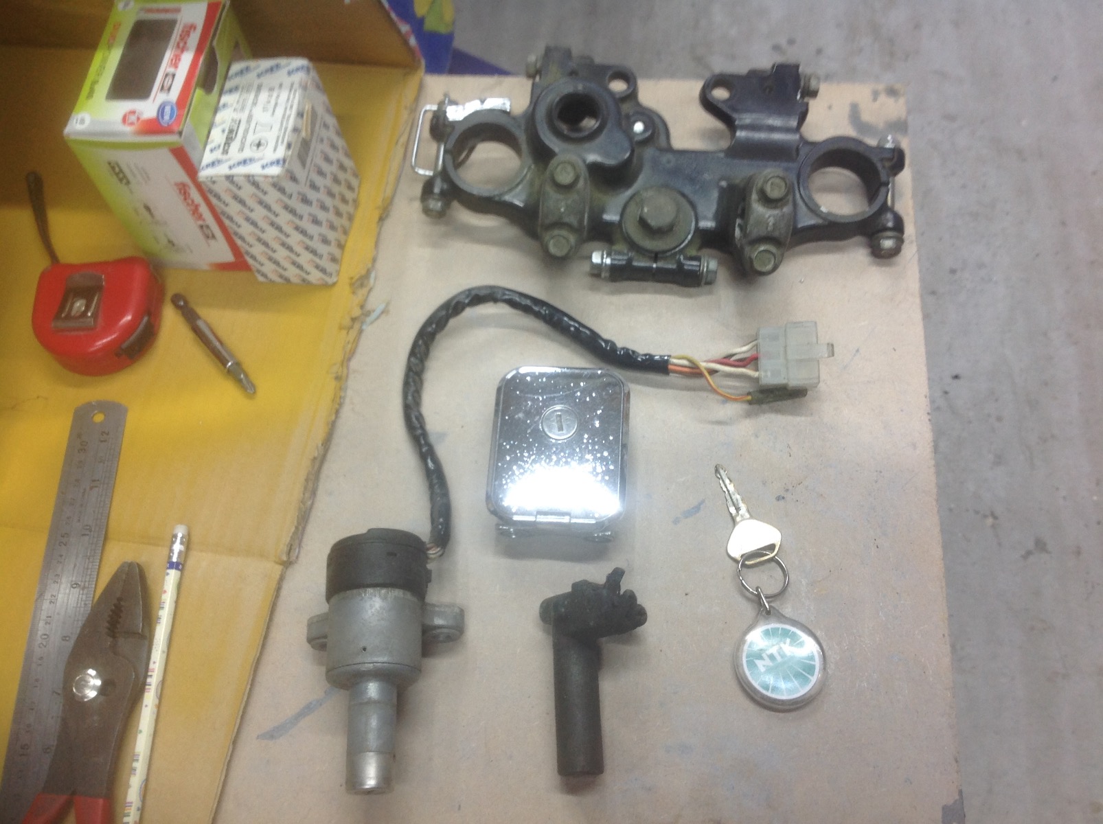

This is a stock 1000K top yolk - the pushed forward one is for a non-Ltd without the leading axle forks. Yours look like "J" trees, increased "offset" and "leading axle" forks are both designed to reduce trail, having both could make the bike unstable at speed

Oof... Well at least I know the trees are still stock so if I ever switched back to the stock forks I won't see any problems. I don't think there's room to switch the trees to the straighter version, the forks already come pretty close to the tank when turned.

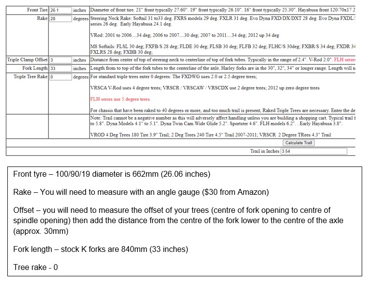

Once it's back together you could take the guess work out of it and put your numbers into the calculator on the below link
RB Racing Rake and Trail Calculator (rbracing-rsr.com)

Some really nice bikes pictures on that page. I really like the yellow one near the middle, not a crazy amount of rake but it still stands out. I had considered converting my bike to the single seat style (I can't even remember what that's called now) while I was building it, but I thought it was best to get familiar with it first by rebuilding it back to stock. Maybe some day I'll tear it all down again.
I'm not sure if I have all the numbers needed for that calculator. I suppose I could figure out the trail based on the numbers from the original J, then adjust for the leading axle fork. Is there any rake in the stock trees? Where would I find this type of information at?

31 May 2023 12:46Use the below as a guide and update with your numbers (the numbers I have put in as an example would give 3.54 inches of trail = 89.9mm of trail which would be potentially nervous)
