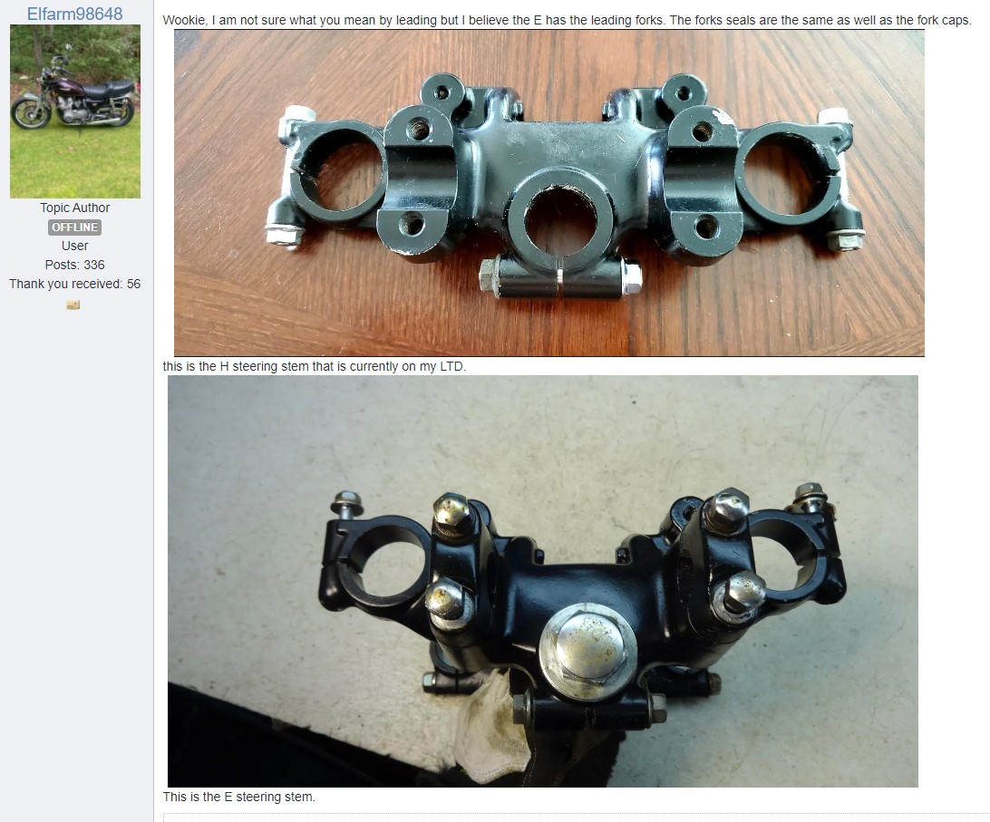

It looks like ebay made up my mind for me anyway... I didn't see anything BUT the front-leading forks available, so that's what I ended up ordering. I figure I know they already work for me, even if the geometry isn't quite correct, but I know what I'm getting in to this way.

I don't know for sure ref the trees but I do know when Elfarm put the "J" equivalent (sorry don't know the model codes for 750) tank on his 750 Ltd he had to use the trees from the roadster as well because the forks where hitting the tank on full lock. (there was a significant difference in the offset with the two sets of trees which cured the clearance issue) below shows the difference between Ltd trees and Roadster trees (E&H models) regarding different "offset"

31 May 2023 07:54I don't know for sure ref the trees but I do know when Elfarm put the "J" equivalent (sorry don't know the model codes for 750) tank on his 750 Ltd he had to use the trees from the roadster as well because the forks where hitting the tank on full lock. (there was a significant difference in the offset with the two sets of trees which cured the clearance issue) below shows the difference between Ltd trees and Roadster trees (E&H models) regarding different "offset"
That's exactly what I was asking about.

That's a pretty significant difference in the trees. I'll have to take a look when I get off work but I'm pretty sure mine match the first ones that are not set forward. However I don't have any trouble with the forks hitting the tank (we have a bad problem in the area with people walking off with bikes so I always lock the wheel after I ride). Maybe there's a difference in the frame between the 750 and 1000 that eliminates this issue?

31 May 2023 08:19My 1000K trees looked similar to the 750 Ltd setup (the top one is in Spain now!!) but I believe you are using the Ltd tank anyway so clearance shouldn't be an issue anyway (theoretically )That's a pretty significant difference in the trees. I'll have to take a look when I get off work but I'm pretty sure mine match the first ones that are not set forward. However I don't have any trouble with the forks hitting the tank (we have a bad problem in the area with people walking off with bikes so I always lock the wheel after I ride). Maybe there's a difference in the frame between the 750 and 1000 that eliminates this issue?

Hmm I found some old pictures of the top of the front end from when I started disassembling the bike, and yeah, the tree looks like it has quite a bit of forward angle to it like the LTD head above. So I guess the PO did in fact replace the whole tree when they swapped the front forks.
