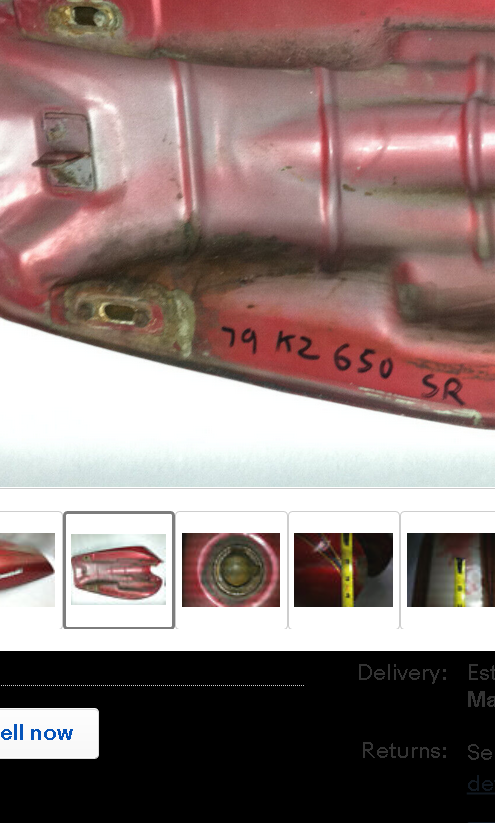

Yeah, check the shape of your petcock opening(s) on your gas tank.
It may be pill-shaped instead of a circle.
The Pingel requires a circular opening.
So cutting may be necessary.
I actually may have used a slow step drill to modify my tank.
photo:ebay (wantsmopar)

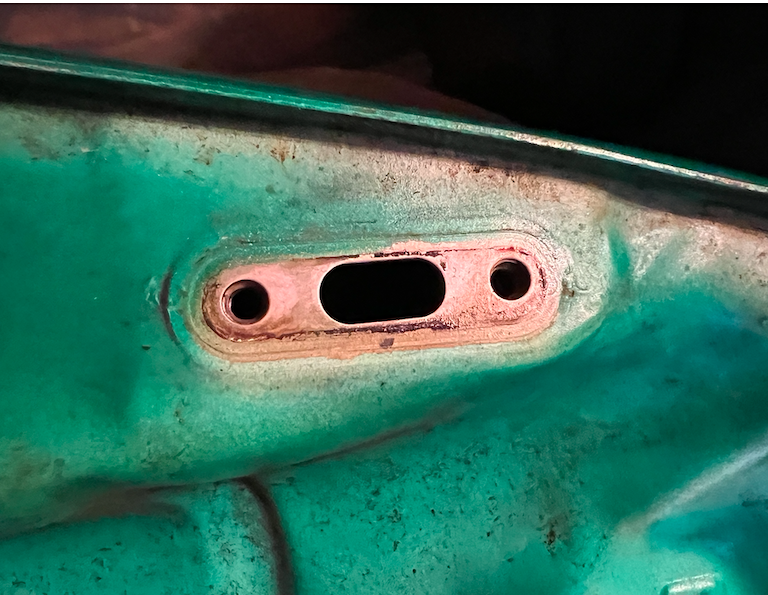

Yeah mine looks like this: I want to use a drill bit, but I shiver thinking of all the metal shavings that will be left in the tank. An if i make a circular hole wider than the pill shape, how will it seal if its wider than the sealing gasket?

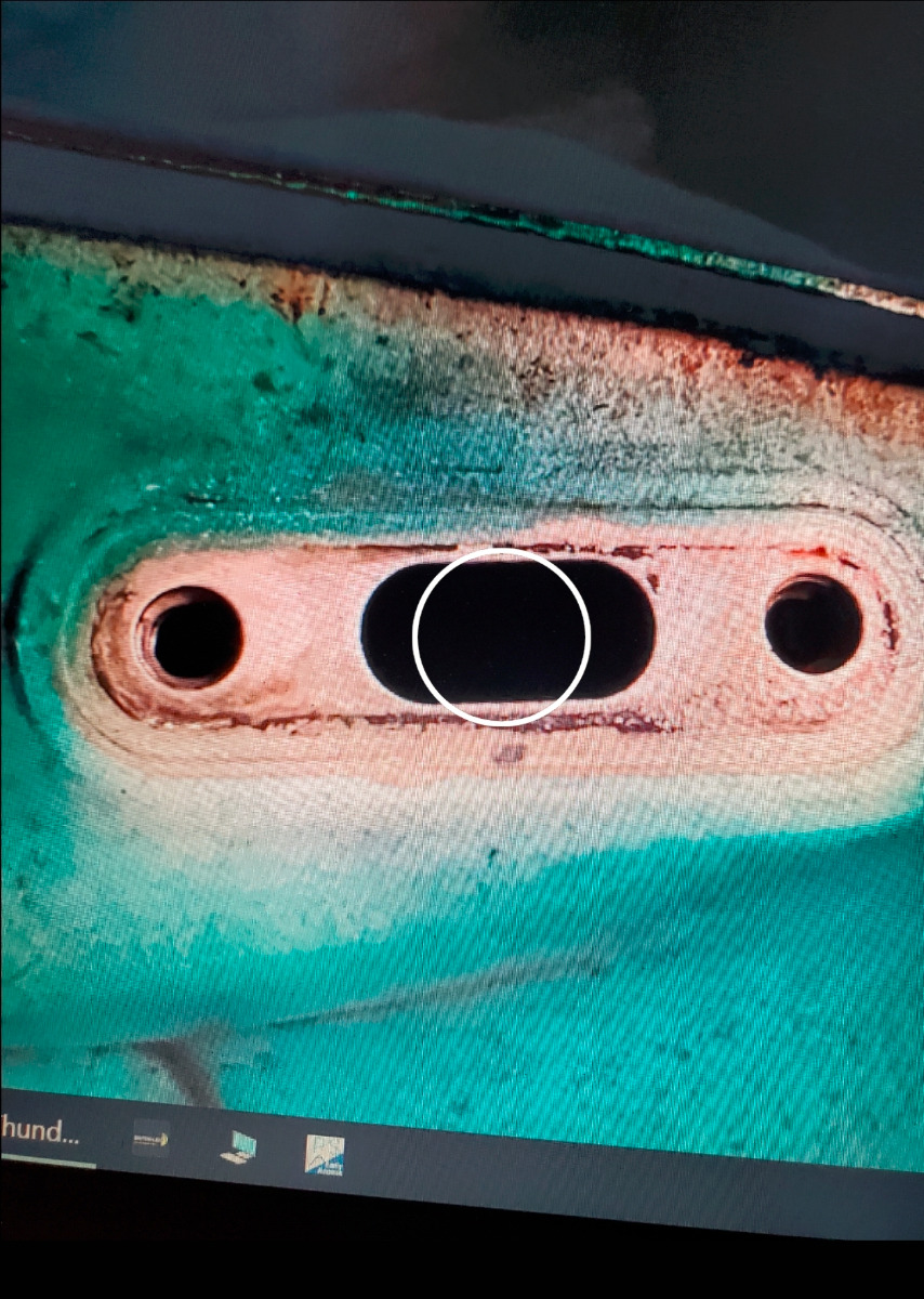

18 Mar 2023 15:12 - 18 Mar 2023 15:13
It won't be wider.
You would just need to open up the top and bottom a bit.
The circle opening required actually has less area than the pill-shape.
I'd wait till you get the valve.
Your choice of valve may be slightly different than mine anyway.
Otherwise, you may cut too much.
Below is a rough guess.
