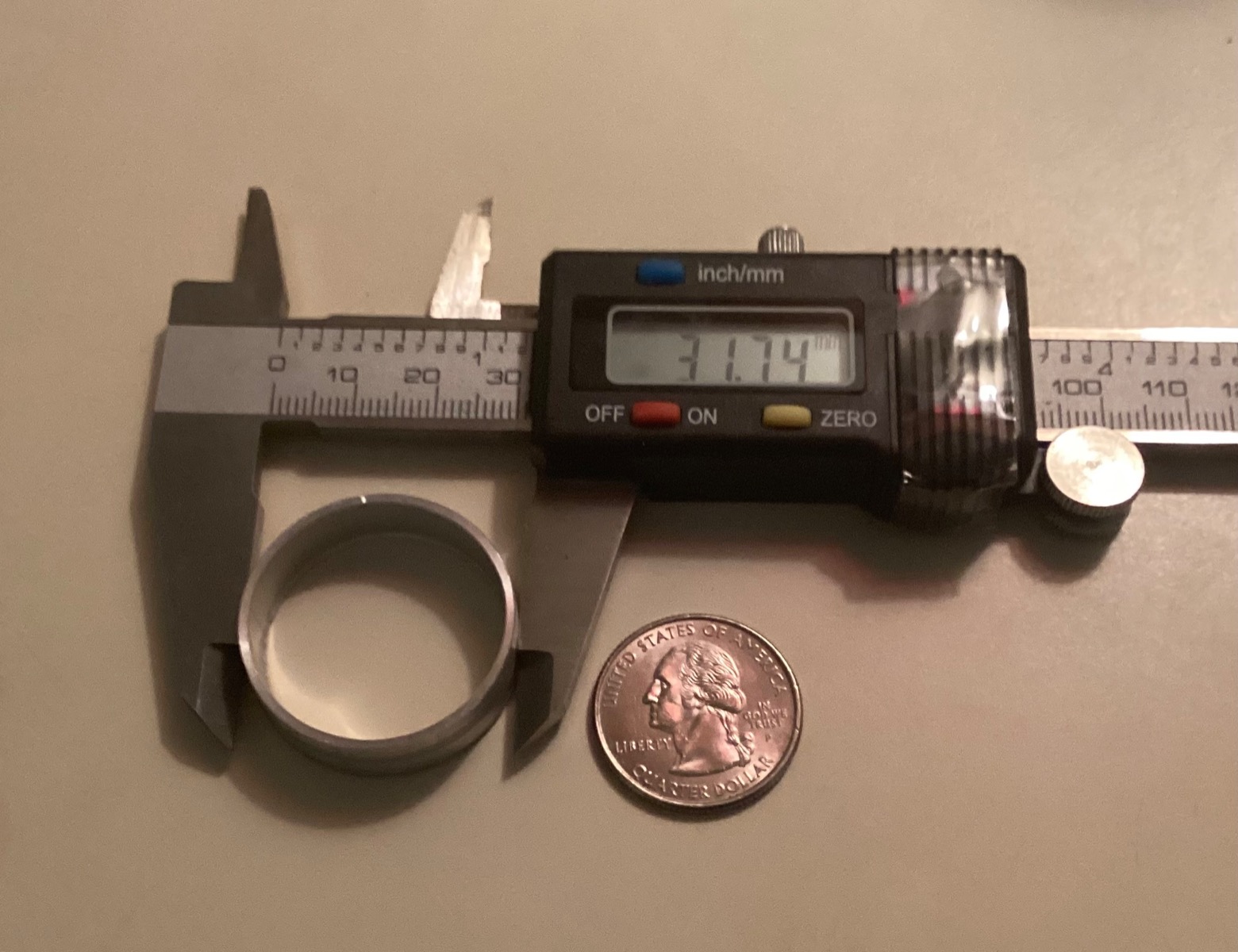

Here’s a scrap of the aluminum spacer stock that a suspension company sent me when I ordered new springs. It measures 1.3 mm thick. The spacers were approximately four inches long each.
They told me I could have used schedule 40 PVC as well.

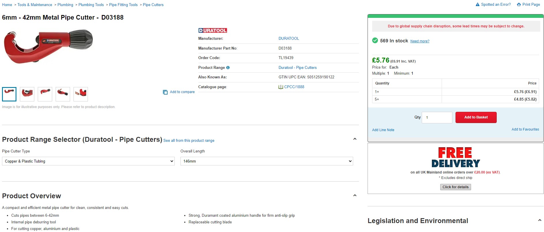

Not sure what size your tube is (the below goes up to 35MM) but one of these will cut it in minutes and be perfectly square - why mess about for around $12 ?
And another even cheaper that goes to 42mm (I know it's a UK company but there must be comparables stateside

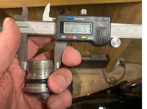

Measured the threads today, approx 30mm, what size should I go for ?
I have a washer on top of the progressive spring.

I would suggest you measure the inside of the tube and then get as close to that as is available (with it still being able to move freely in case you need to get it out again)
