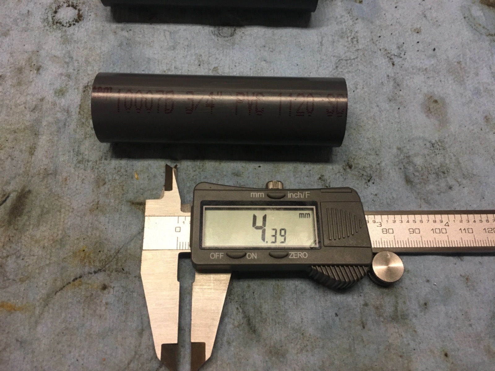

Found the drop. Unfortunately it has the schedule number cut off. The wall thickness is 4.39mm
 You'll be fine with that.

Any electrical pvc pipe you buy will be sch40. Sch20 is not allowed for electrical work and sch80 is a special order.

It’s fit perfect, added 20mm
