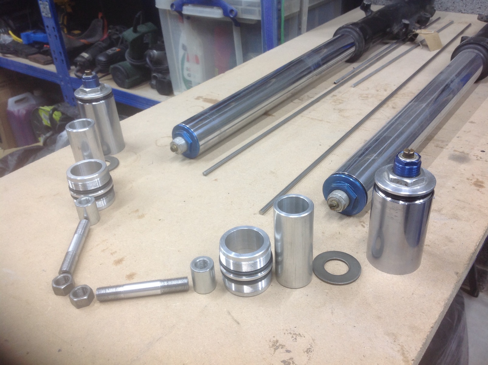

- Posts: 6934
- Thanks: 4352
Re: Spacer PVC
26 Feb 2023 00:40
I had mine made in alloy as part of my fork extensions ( they are 75mm long though so I think it would of been asking a lot of PVC)
