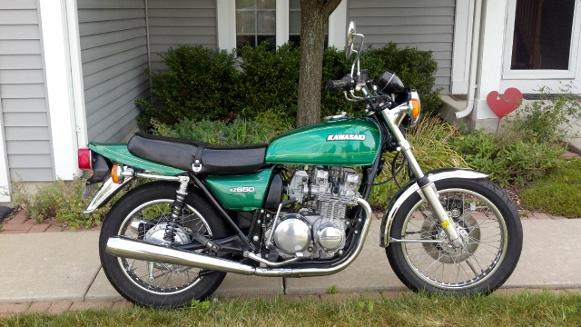

Just to throw another great U.S. made suspension manufacturer into the mix: Worx Performance Shocks. They custom tailored the shocks for my KZ 650. If they have not made a shock for your particular model, they will take your measurements from your bike; swingarm to lower shock mount. lower shock mount to upper shock mount, etc.
Here is their link. >>> Street Bike Shocks (worxshocks.com)
PLUS, don't forget your fork springs. If you do not put in heavier rate fork springs, you will find yourself with less control on braking such as fork dive when riding two up. Also, my stock springs were so soft that I would get head shake and loss of control at speeds above 90 mph. RaceTech makes some great fork springs as well as Progressive. They will also provide to your weight/riding style. Here is the Racetech website >>> Race Tech
Here is my KZ with Worx Performance Shocks and Race Tech fork springs. It handles great two up and holds lines in corners very well.

13 Jul 2022 10:24
Wow. Thank you for that info. Didn't know I needed to upgrade the front too. I just added a lil air to them and it solved the bottoming out up front
