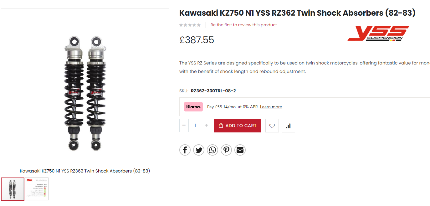

12 Jul 2022 04:58
Something like the below should have enough "pre-load" adjustment on the spring to meet your needs "two up" but can be reduced when you ride solo (the adjustment only takes a few minutes if you maintain the threads on the adjusters)

12 Jul 2022 15:44 - 13 Jul 2022 01:54Ikon have this service as does Hagon. The YSS shocks Wookie posted above have more preload adjustment than stock type shocks {like hagon and Ikon}, the collar above the spring can be wound down to exactly where you want it to stiffen up the spring, they have a small grub screw to lock the collar off once adjusted, they are a good shock and the correct length. Make sure you understand and know exactly what you want before buying anything... Don't be afraid to ask more questions..
