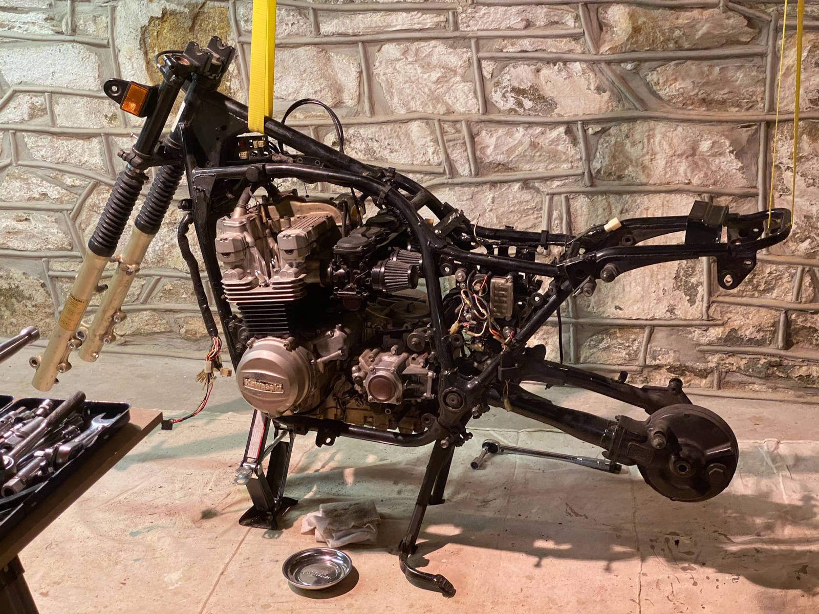

This problem has been resolved by joining my local tool library. I took out a corded Porter Cable 1/2” impact wrench. Three days struggle was over in under a minutes careful application. What an amazing resource.
I appreciate all your input. Sincere thanks. I am definitely not yet using the right penetrating oils and I will be on the lookout for the hex version of that axle. Meanwhile, it seems logical to grind flats on my existing one before reassembling.
Here’s where I am down to at the moment…
Next off, the harness and all the wire mounts and brackets. I’ll be cleaning all the connectors and touching up any rust spots. After that, I have to decide how deep I should go into the engine. I had only planned on checking the valve clearances and replacing the valve cover and oil pan gaskets.
