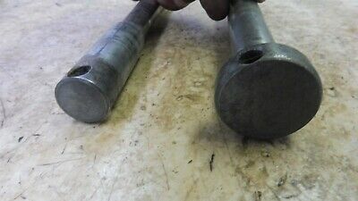

Re: Spectre - Rear axle - Castle nut stuck
01 Feb 2022 17:37 - 01 Feb 2022 17:39
Yeah, I was looking around eBay and it looks perfectly round. That was an odd choice for Kawasaki.
I would probably just grab the head with a big pair of vise grips and then once I got it off replace it with an earlier or later model axle with a proper head. Or grinds flat spots into that one for next time.
I'm guessing it's like this?
