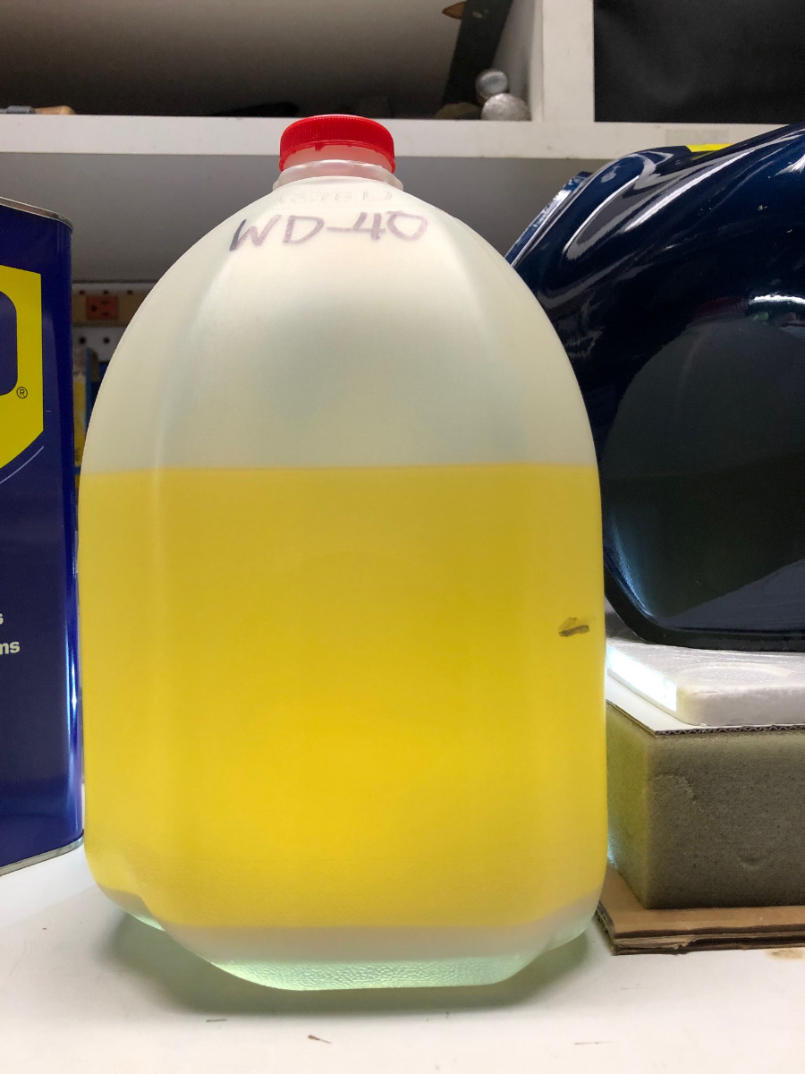

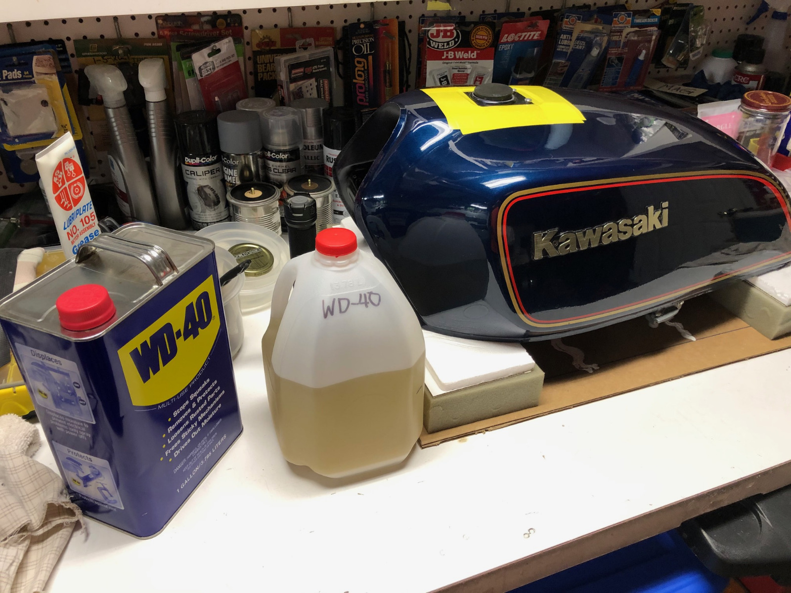

Update the morning after: Attempt#5 was a FAIL also! This morning I have a few spots of surface rust inside the tank...Bummer. But also there is this black and grey crud which has developed especially on the lower parts of the tank. You can easily wipe it off. It is not the black phosphotizing that covers the metal after a long Phosphoric bath. I am going to have to start again by pressure washing out the crud then on to attempt #6
(You are welcome to read the following but I was premature in classifying attempt #5 as a success)
Hi Guys, SUCCESS!! Thanks for all the input. Based on comments I have read I tried again. Attempt #4... Phosphoric acid wash (Tank looks great after the acid was drained) followed by a single one gallon distilled water rinse. But before I could put a quart of WD40 after I drained the tank it had already flash rusted. The rusting was minor but still there almost instantly. Another failure. I decided the rinsing operation was the problem. It removed the acid exposing the bare etched metal to the oxygen.
So next I tested the reaction between the WD40 and the Klean-Strip Metal Prep by mixing some together. No crazy chemical reactions but they separated almost instantly with the Klean-strip heavier and below the WD40.
Attempt #5 for my KZ1100 tank: Derust using the Phosphoric Acid (Klean-Strip Metal Prep) and then drain. This time no rinsing but immediately I added a quart of wd40. Drained well and then added a fresh quart of the WD and drained. SUCCESS! No flash rust.
Tomorrow I will ad some Marvel Mystery oil. I should have the carburetors rebuilt and installed by next week and then I will be installing the tank. Hopefully firing her up late next week.
The picture shows the used WD in gallon jug. Yellowish WD on top, The white layer is the water emulsified with the WD, and the clearish lower layer must be the phosphoric acid.

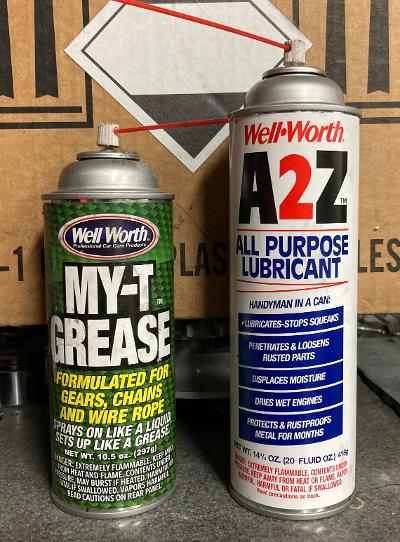

27 May 2021 21:51 - 27 May 2021 21:51[Marty, speaking as a woman that uses WD-40 for clutch/throttle cables, throttle tubes, my chain, and pretty much everything else that I can...I don't really agree. I sprayed a bare engine block with WD and 3 years later when I dug it out, no rust.
I'm just opining! You want very excellent products?
"WELLWORTH" I have ordered and used their products for 25 years. I know the original owner and founder, he has since retired. I ordered $1000's of dollars of product for a large commercial printing plant.
"A2Z" is WD40 on steroids! kicks its ass!
"MY-T Grease" sprays out as a liquid, then set up as grease in about 1-2 minutes. talk about cable lube!
Been using these products and love them. Been restoring bikes and parts for 25 years, preserving wire harness, rubber parts, selling on eBay for 20 years. Helped me make money! And preserve my motorcycles.
They are online and sell to individuals. Buy Some! try it out!
Ask "Shankhole" with the Trike. He came from Michigan to Buffalo and picked up an engine I sold him. I gave him a fresh can of A2Z. He seen my stuff. Now he knows!
