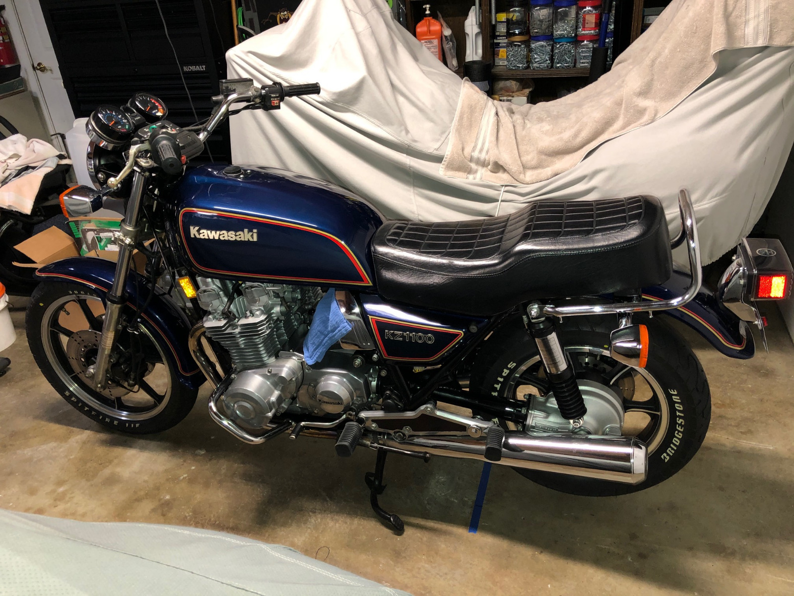

The project:
Next step is to assemble, bench synch, and install carbs. Then time to fire it up! I have gone through everything from the taillight forward to the tank. I am going to fire it up and ride her for a while then I will completely disassemble clean and repair as necessary the front end from the steering head forward.
