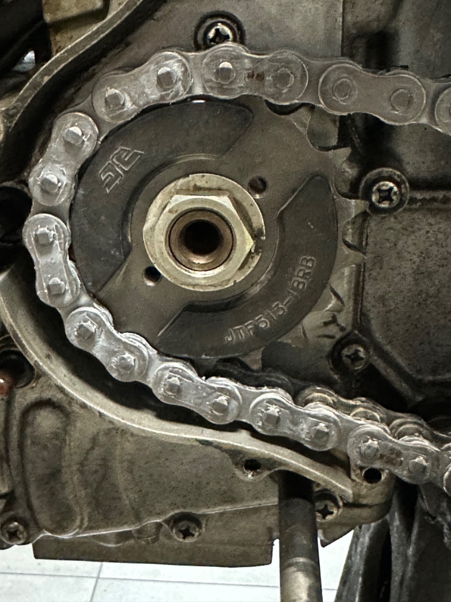

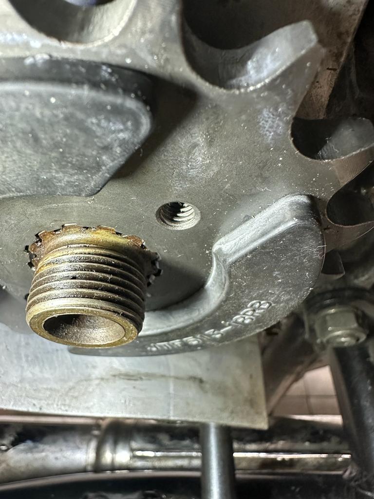

Hello, I know this is an old thread, but just in case. I have installed a new 530 chain in my “76 Kz900A4. Gone to a rear 42 tooth sprocket and an 18 front. 112 link chain. All in order, except for the fact that my new front sprocket does not have the little hole to hold the safety washer, so I believe I have to go to a “serrated” washer that holds to the spline and I can bed.my question is what is that washer? How can I get it? What is the part number? Will any Kawasaki sprocket washer work?

"Will any Kawasaki sprocket washer work?"
Not sure . Maybe
check parts diagrams at partzilla for your output shaft. Then see what other models have same. Partzilla seems to show a splined shaft but the washer with tab only
z1enterprises.com search "lock tab" shows a washer similar to the one you pictured and says it fits kz650 750 and 1000 models .
you may also want to remove the sprocket and count the number of splines on your output shaft and verify that a splined washer will fit over it.

Am I over simplifying things or can you not just drill the required hole in the new sprocket ?

Hardened steel.
Possible but not easy. Personally I would not have the right equipment.

30 Jan 2023 10:22I see you've never tried to drill a hole in a countershaft sprocket. They are harder that a whore's heart!Am I over simplifying things or can you not just drill the required hole in the new sprocket ?

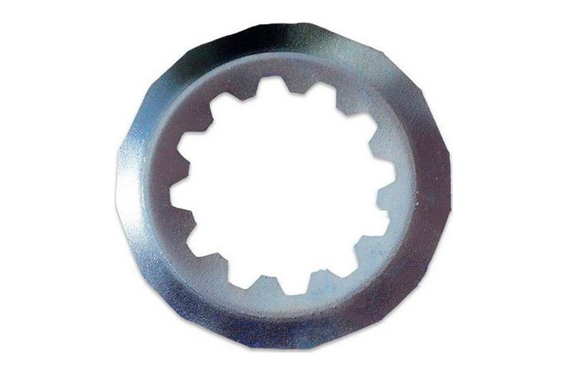

Here ya go.
www.partzilla.com/product/kawasaki/92200...f2b873a4fb361dd3003e

By cartal: ... I have installed a new 530 chain in my “76 Kz900A4... I believe I have to go to a “serrated” washer that holds to the spline and I can bed.my question is what is that washer? How can I get it? What is the part number? Will any Kawasaki sprocket washer work?
I don't think the spline pattern is the same on all models, so you can't necessarily use any old splined washer.
From the diagrams at Partzilla the 1976 KZ900-A4 has the same Fr sprocket as the 1980 KZ1000-G1 Classic.
The G1 has a splined washer which should then fit your motorcycle. Kawasaki P/N 92200-1065.
Partzilla has a pic, so it should be available & it was used on a bunch of models.
If they use the same Fr sprocket, then I assume the output shaft pattern should be the same.
I tried searching by output shaft, but all of the models I saw had the tabbed washer.
www.partzilla.com/product/kawasaki/92200...51057ea3ace501f933c7 same part as Mikaw linked. hee.
ps: after tightening the sprocket nut, bend over one side of the splined washer against the nut.

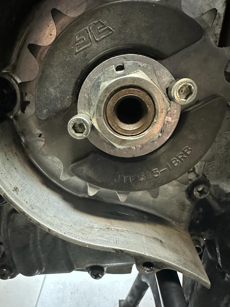

Thank you all for the replies. Wookie... I tried drilling the sprocket, but it´s impossible. No way.
2 different things:
1.- There is no room, after the sprocket is in, to use one of those "castellated washers", so I recurred to using the original washer, and then holding it with two bolts in the current sprocket. I ended cutting the head out of the allen bolts, as the cover would interfere with them. Just the stem of the bolts is enough to keep the sprocket (and the washer) from turning.
2.- I had to replace the "rubber" sprocket for a regular one. The cover would not fit with it in there.
Unfortunaltely, I don´t have a pic of the finished product.
