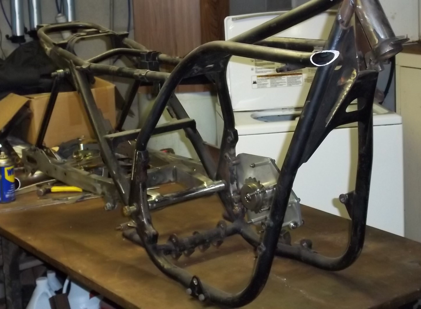

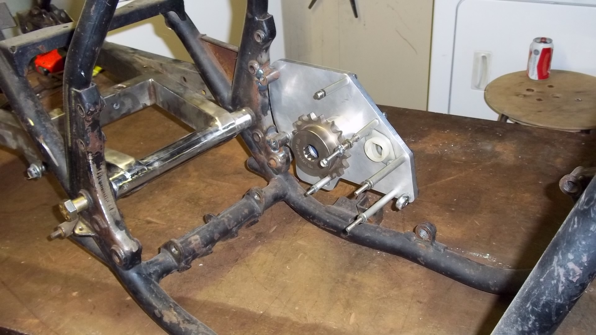

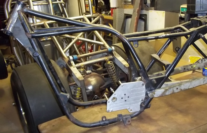

They have quality 530 chain today with super high tensile strength. Some of the Pro Stock drag bikes use it! Of course EK or Tsubuki is up there. I built one over 9 yrs ago. when I was still in the City house. I wish the Hot Rod on the table was 530! Could have snuck a 160 maybe 180 rear tire instead of the 150 rear. I'll find those pics too. That was an "Irish Will" old member plate he made and sold. 2010.
That was a middle of a rake job too. I found pics I forgot I had. Thats the race car 1/2 built too.
