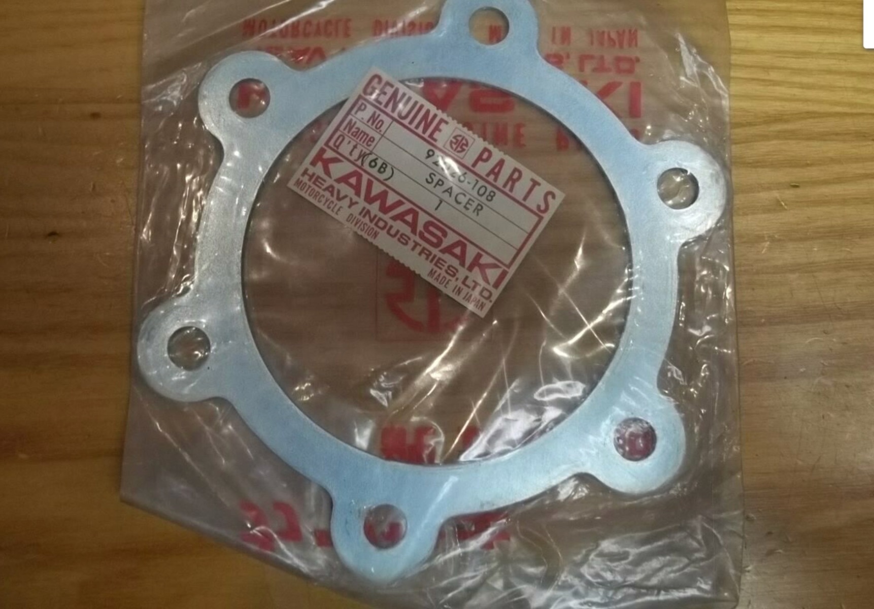

Re: Z1KZP swing arm swap
03 Jan 2021 08:49
GoPro 3 sucks. I was talking about buying a sidewinder baffle so it would come straight out not up like the one I have. Got the tail end on my comments. The cam skips over a few clips so the video is choppy and hard to collate. Going to buy a different one.
I put washers behind the sprocket to move it over to align it with the countershaft sprocket. Looks good to me. Will report back tomorrow.
03 Jan 2021 09:27
Steve KHI made a spacer between the crush drive and the sprocket when using an O-Ring chain. Might be more solid then a stack of washers.
- Posts: 23777
- Thanks: 3042
03 Jan 2021 10:05
Had one.
