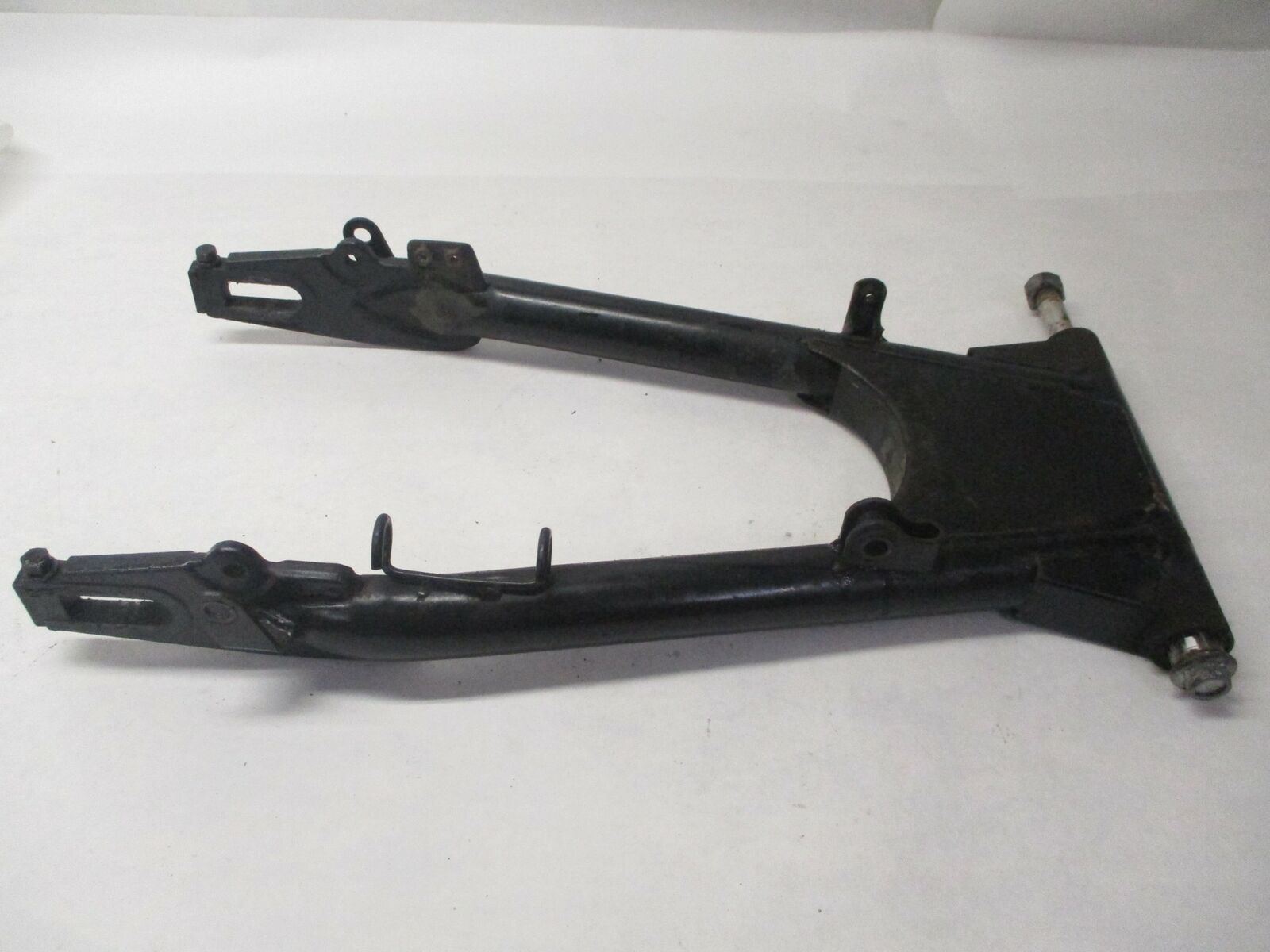

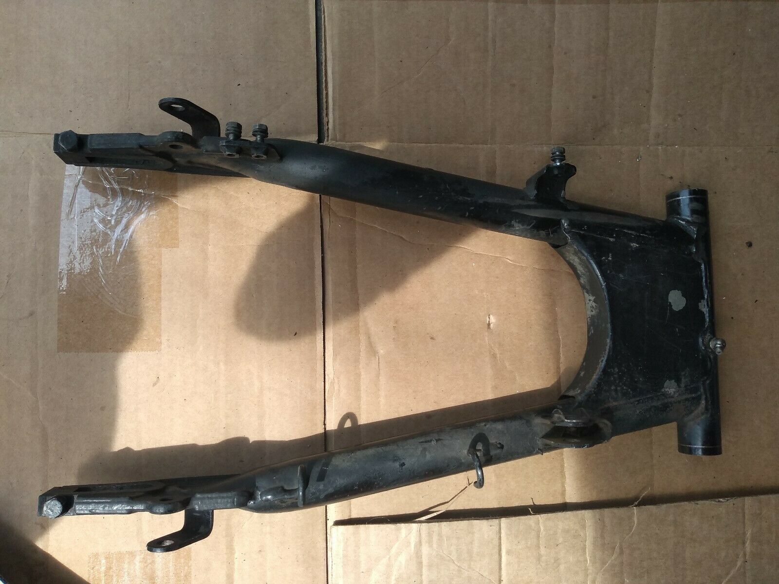

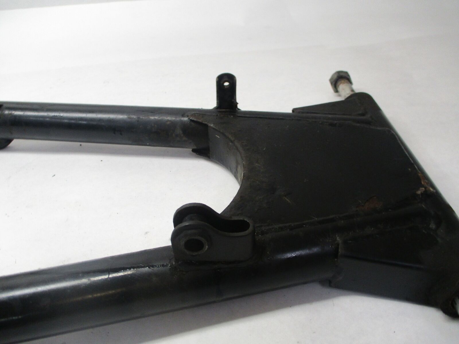

No eBay APP ID and/or Cert ID defined in Kunena configurationLooks like my swing arm will be here Friday. I can work around the chain and brake stay issues but I think shock placement might be a show stopper.
Been comparing the different ones through the production lines.
1978
Looks like the Z1
1998 KZP
2002-05
Looks hammered to me

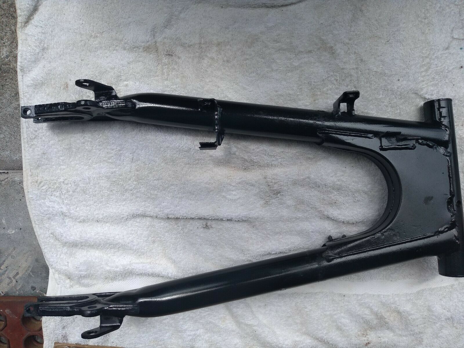

12 Sep 2020 11:44
It came. Looks good. He told me it was 41.75mm round not 47. Turns out it's the same as the Z1's. It is a little longer but not as long as the one I modded up. I'll dig it out to compare. It should work great.

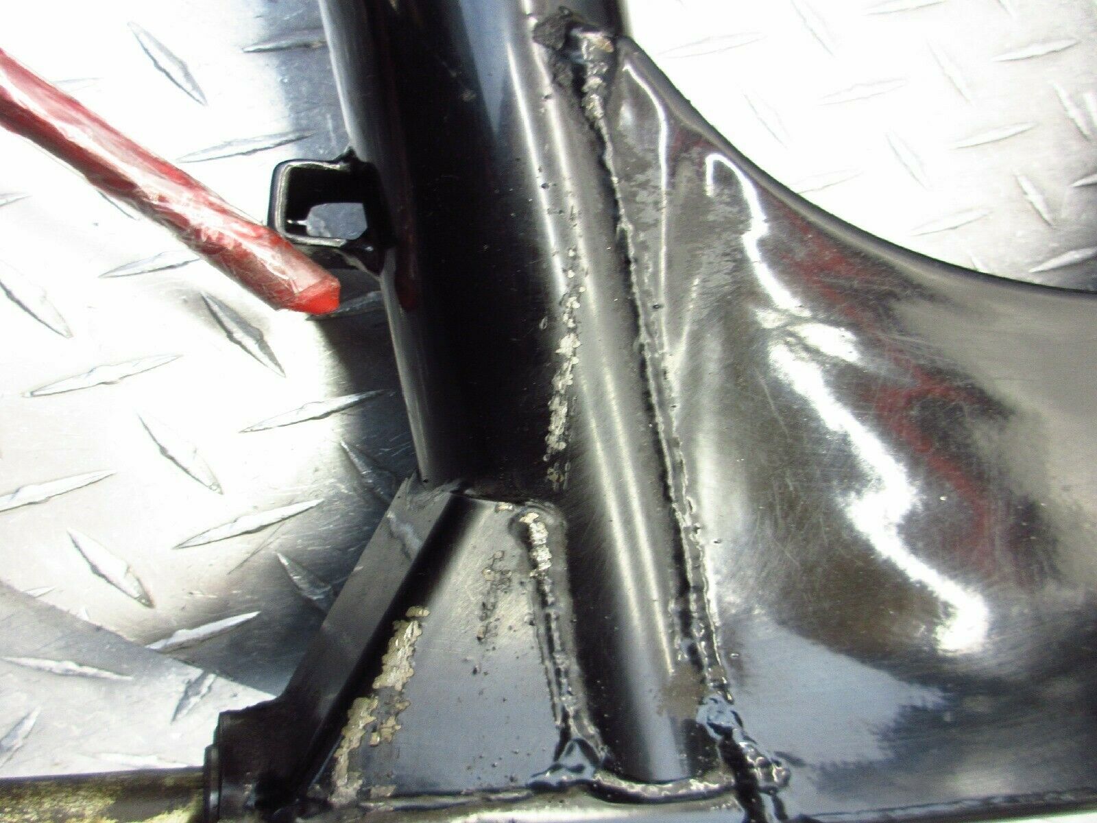

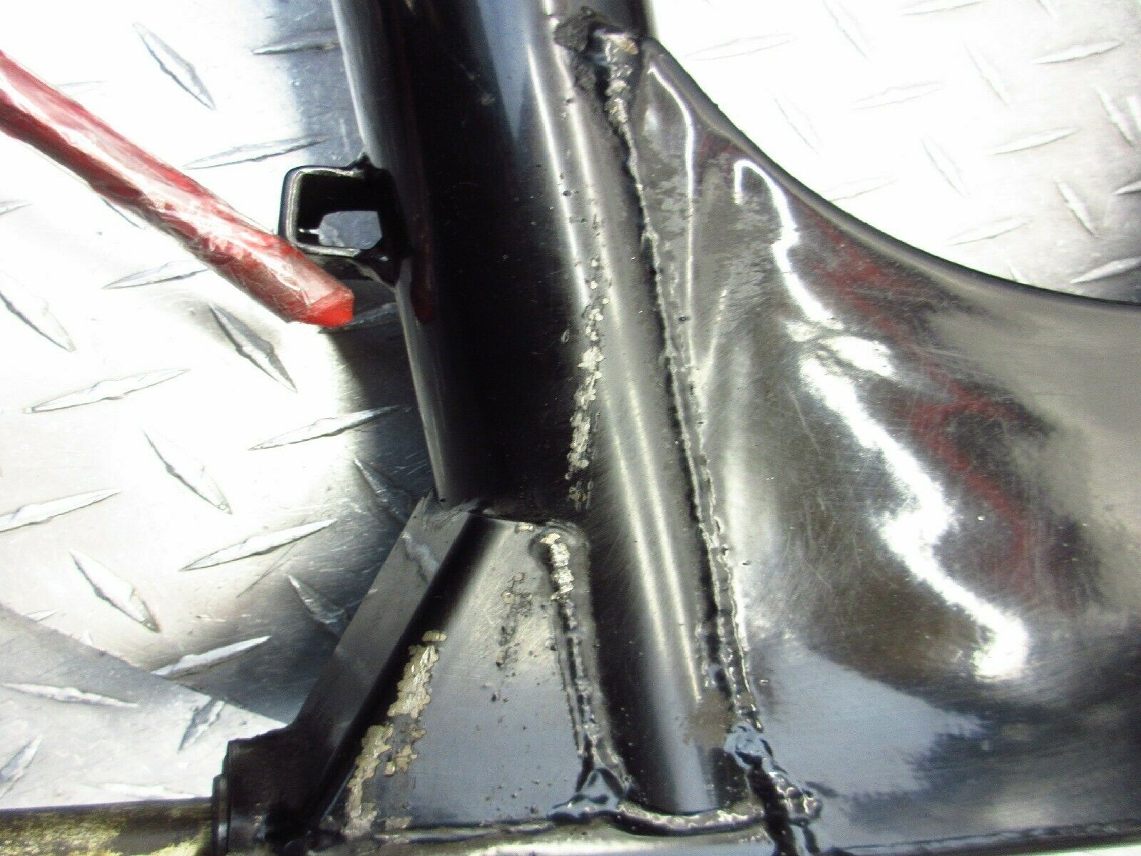

19 Sep 2020 13:51
A little more to it than I thought.
Re: Z1KZP swing arm swap
19 Sep 2020 14:35 - 19 Sep 2020 15:46
Your correct on the frame tubes sounding thicker. According to a book I just received and digging into, the tube wall thickness of your Z1B is 1.8mm and the next gen A4 was built out of 2.3mm wall tubing. Not sure if they were increased again after the 1977 Kz900 A5. Id assume the swing arm was increased in a similar way.

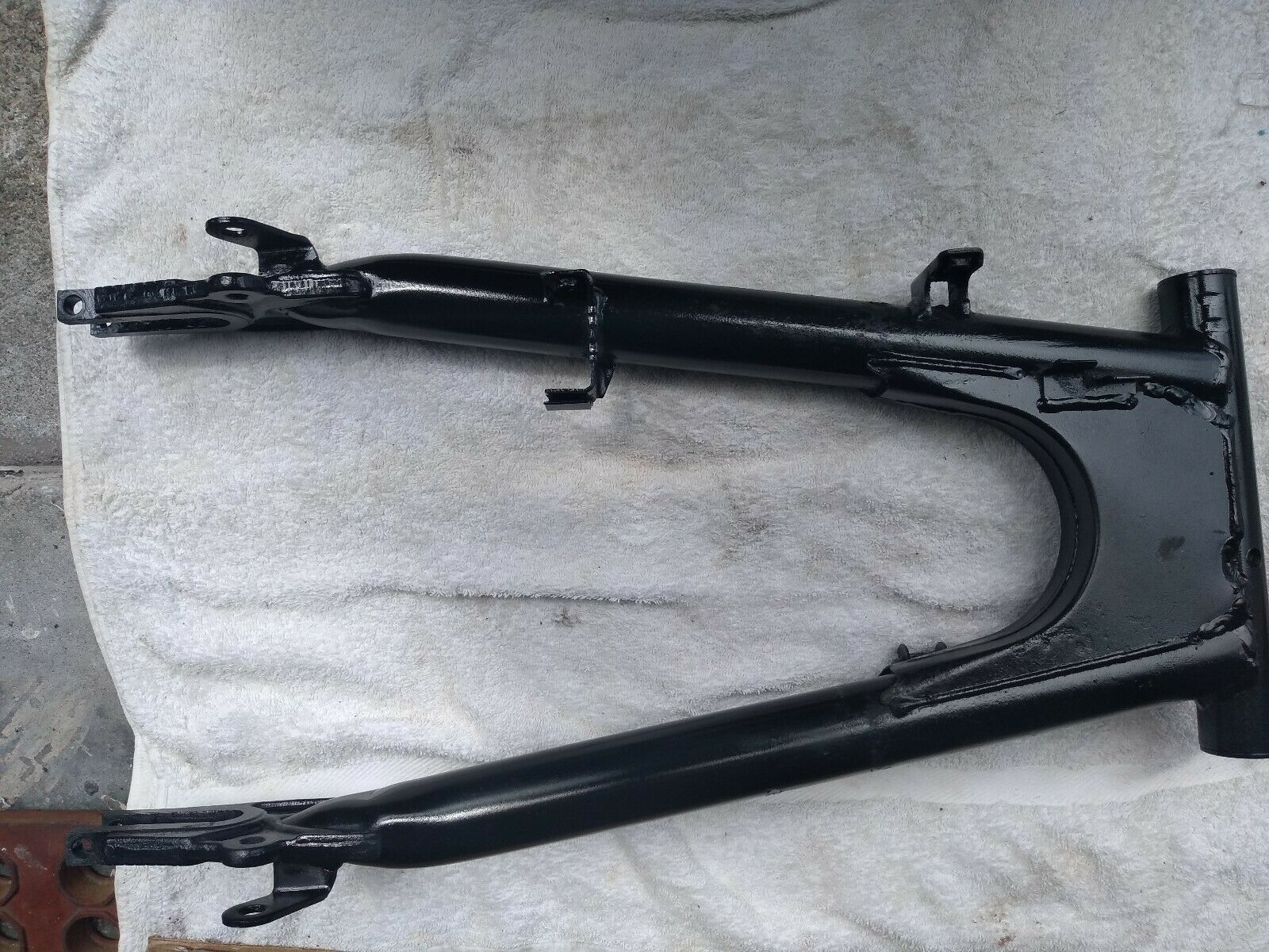

19 Sep 2020 18:38
Slow going but getting there.
