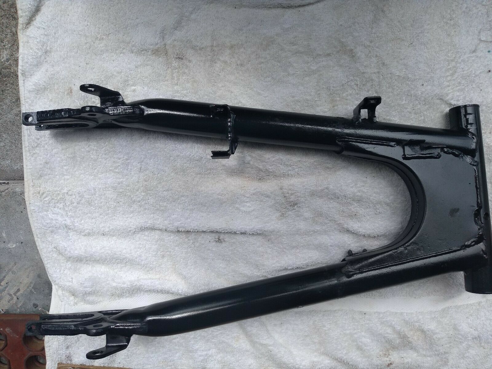

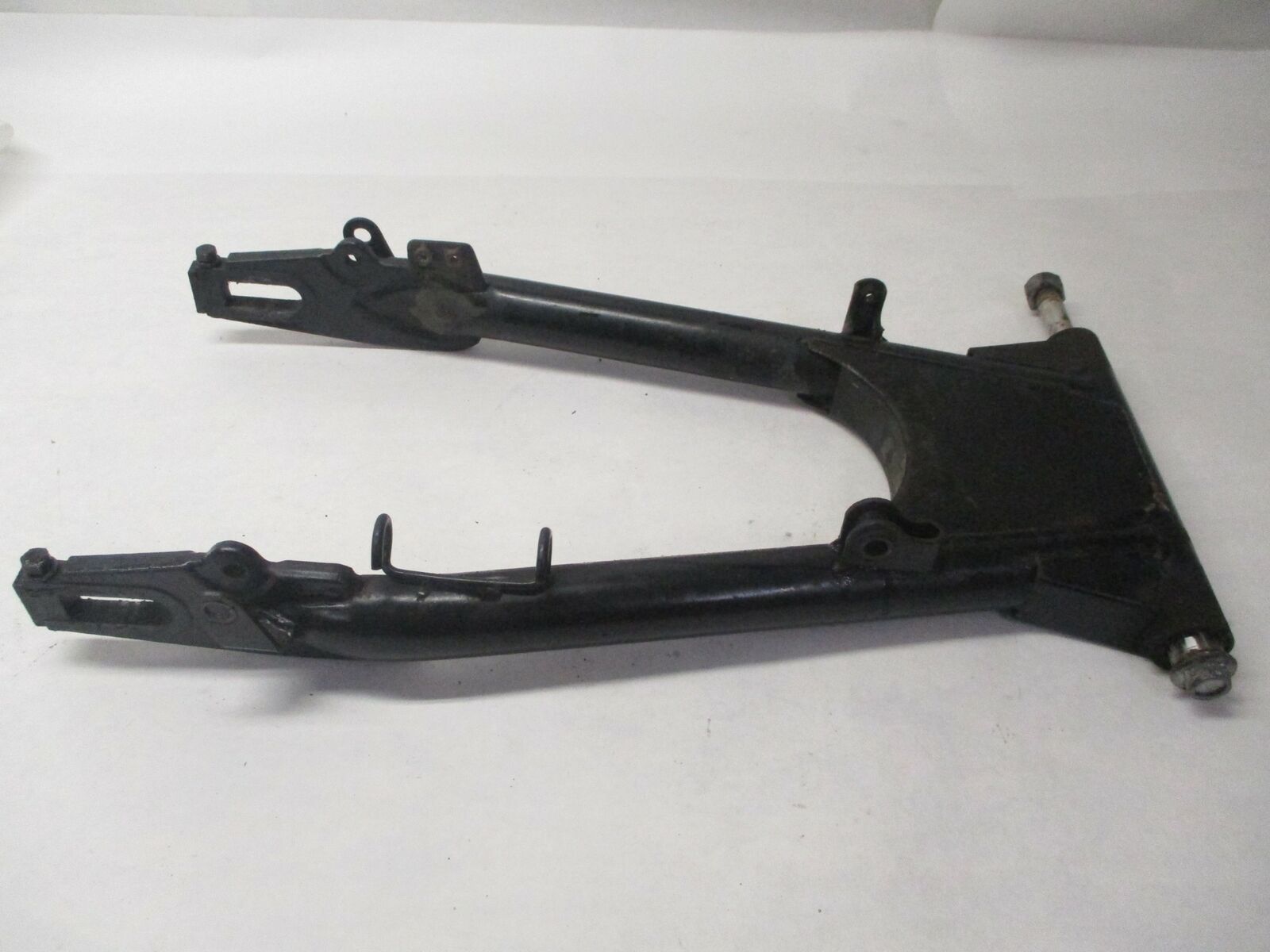

No eBay APP ID and/or Cert ID defined in Kunena configurationLooks like my swing arm will be here Friday. I can work around the chain and brake stay issues but I think shock placement might be a show stopper.
Been comparing the different ones through the production lines.
1978
Looks like the Z1
1998 KZP
2002-05
Looks hammered to me
1978
Looks like the Z1
1998 KZP
2002-05

It came. Looks good. He told me it was 41.75mm round not 47. Turns out it's the same as the Z1's. It is a little longer but not as long as the one I modded up. I'll dig it out to compare. It should work great.
