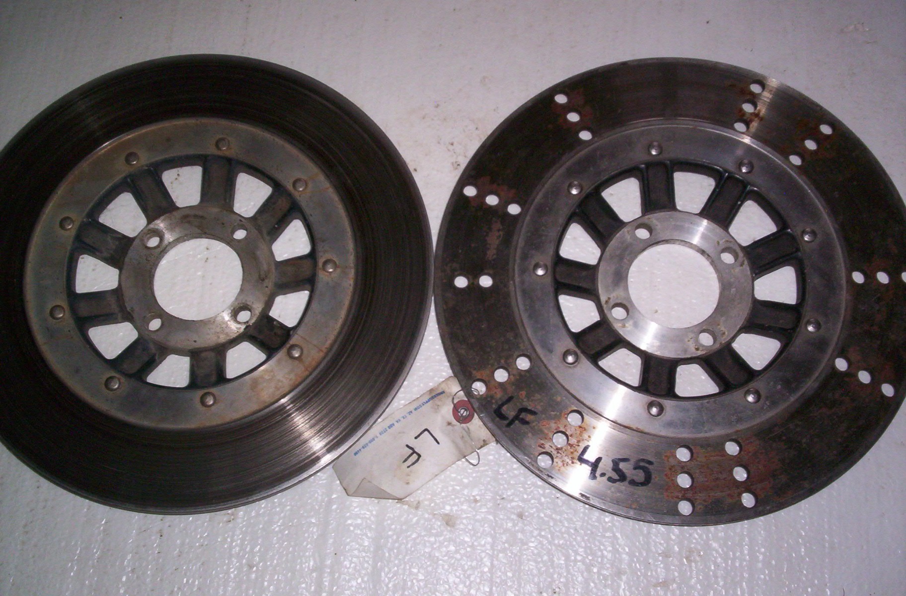

here we go- from Jeff.saunders in 2011, also sorry to call you out, but that name carries some clout. anyways there were other threads I found when researching but I haven't found them right now, but all of it was on kzriders actually:
On a Z1, the double disk setup is crazy heavy. Each disk rotor 7mm thick and weighs 10lb. On the later models, they reduced the thickness to around 5mm and drilled the disk to drop the weight.
I've ridden a Z1 with double disk, and actually prefer the single disk setup. Cosmetically the double disk gives a nice balanced look, but I didn't like the increased shock coming up through the bars.
The double disk setup will give a little more stability to the front wheel - the centrifical weight will help keep it pointed forwards - and reduce the likelyhood of wheelies..."
Well for some reason I want the stock shock lowers but I'm lacing different sized rims on them and changing a bunch of other stuff, trying to improve what I can.. The stock Z1 lowers just are so Z1.

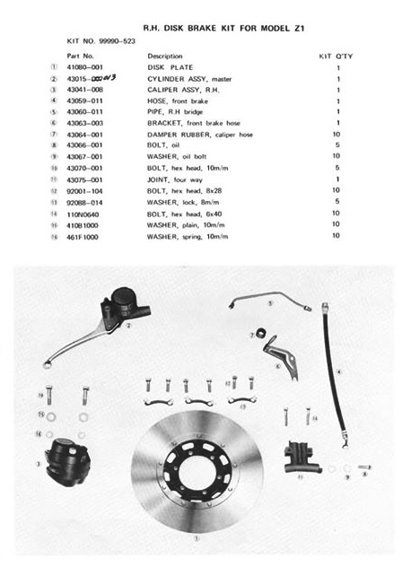

- Thanks: 2260
Re: Z1 dual disc conversion with KZ900 wheel
16 May 2020 02:36
The following user(s) said Thank You: DOHC, Rick H.
- Rick H.
- Posts: 840
- Thanks: 241
16 May 2020 08:13
Thanks Scirocco for posting the info on the conversion kit. I have never seen that before. So unless I am wrong the disc rotor in the kit was the same rotor that would have been on the bike both being the wide rotors. If that is true then I have to wonder how much difference there really was in using the two wide rotors versus two thin ones. Obviously the calipers can accommodate either. If weight was of any concern I would expect Kawasaki would have included two thin rotors in the kit or a replacement set of fork springs to replace the stock single disc fork springs. One can discuss the additional weight for days of the of the twin disc conversion, but any effect must have been minimal at best and did not concern the factory. As these conversions go I think the most important factors are using the larger 5/8" master cylinder and using the same size calipers as pointed out in earlier discussions.
