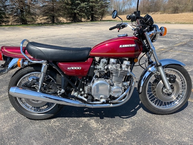

I put a dual brake setup on my KZ-1000 when I went thru it. I never understood why these bikes didn't come with a dual disc setup because the bike needed it as well as some other things. I found a guy that had one of the dual disc brake kits from Kawasaki and it had everything but the master cylinder which I had to source elsewhere. After researching this subject it became obvious that on the factory dual disc bikes of the time they used a thinner rotor than the single disc bikes. However the dealer installed kits in the US had a thicker rotor that matched the rotor on the bike the kit was being installed on. Otherwise both rotors would have had to be replaced which would have added to the cost substantially. It's my understanding that bikes sold in Europe had dual disc brakes from the factory and they were the thinner discs.
In any event the partial kit I received/bought had the splitter, disc, brake hose, hose bracket, brake line, caliper and caliper holder and all necessary bolts. No instructions were in the box. The person I bought it from said he had the kit for a long time and needed the master cylinder in the kit for another bike so he used it, but was never able to find another factory one to replace it. There was no part number tag on the box, but there was a spot that looked like it had a pasted on tag of some sort but was long gone. I have never found the factory part number for this alleged conversion kit, but have been told it did exist and several were installed by dealers.
The installation was pretty straightforward and bleeding the system was quite easy. In operation the dual brake system works great. My only concern is that the new rotor looks "new" while the old original rotor looks "old". At some point I will send the rotors out to be machined so they look the same. The bike handles bumps and such quite well and the front wheel seems well planted when going over them. How much additional weight is offered by a 5mm rotor as compared to a 7mm rotor is of no real concern to me as it isn't a race bike. I have had the bike well over legal speeds and it stops beautifully with no pull or irregularities. Lever effort is just what I would expect on this bike and it WILL lock up the wheel if you get too rambunctious. I have had no problem trail braking with this setup and it is what the bike should have had right from the factory. I suppose there is some slight initial extra resistance when getting the bike moving from a dead stop but it is expected with more weight on the ground. That resistance is of little consequence and once moving is history. The extra resistance when stopping to the extra weight of the dual disc setup is counteracted by the additional caliper. Is there more resistance to changing direction with the dual disc setup? Perhaps but if there is any I certainly don't notice it.

Great looking bike! Ed
