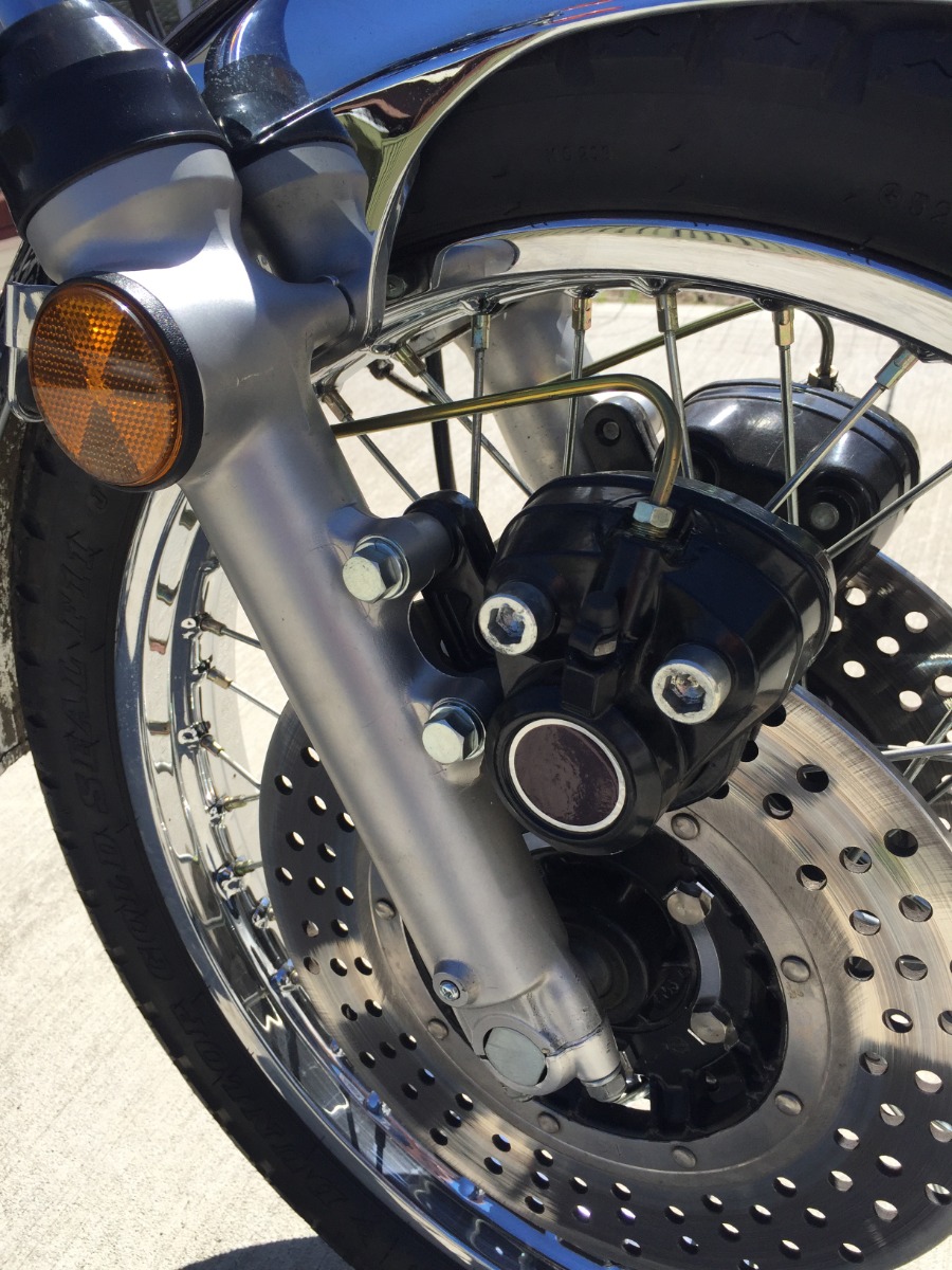

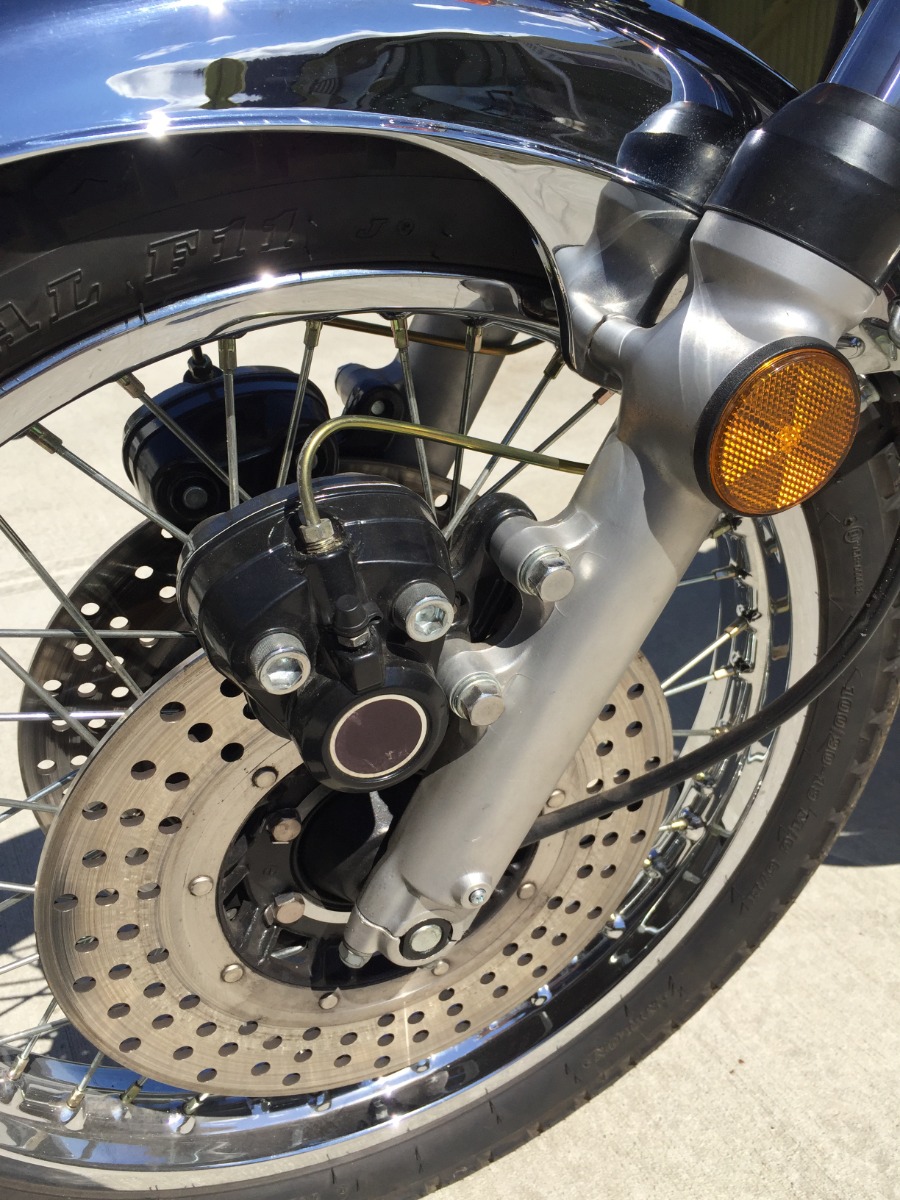

Rick H. wrote: Thanks Scirocco for posting the info on the conversion kit. I have never seen that before. So unless I am wrong the disc rotor in the kit was the same rotor that would have been on the bike both being the wide rotors.
Rick H.
Correct. I have the kit on my blue Z1B. The rotors are the thick ones. One is a 9L and the other is a 1S date code. The PO had mounted them behind the forks but when I restored the bike I mounted them in front. As you can see, they were drilled.
I also have twin discs on my B4 but they are the thin ones. Scared the hell out of me when I checked their thickness one day and discovered they were thinner than the spec....then I realized they were thinner than the spec for the thick ones!

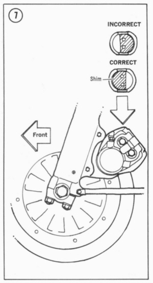

Did any one ever thought about the brake pad shim orientation, (rollback/knockback effect)?

As far as I know the shim was only added to prevent brake squeak. I wonder if orientation makes a difference?
