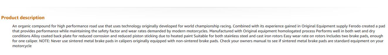

Notice those Ferodo pads are organic not sintered - that's good. If you look at the "Note" in the "Product Description" it warns about using other pads that are sintered on bikes that did not originally come with rotors intended for use with sintered pads. Image below shows that warning. Ed

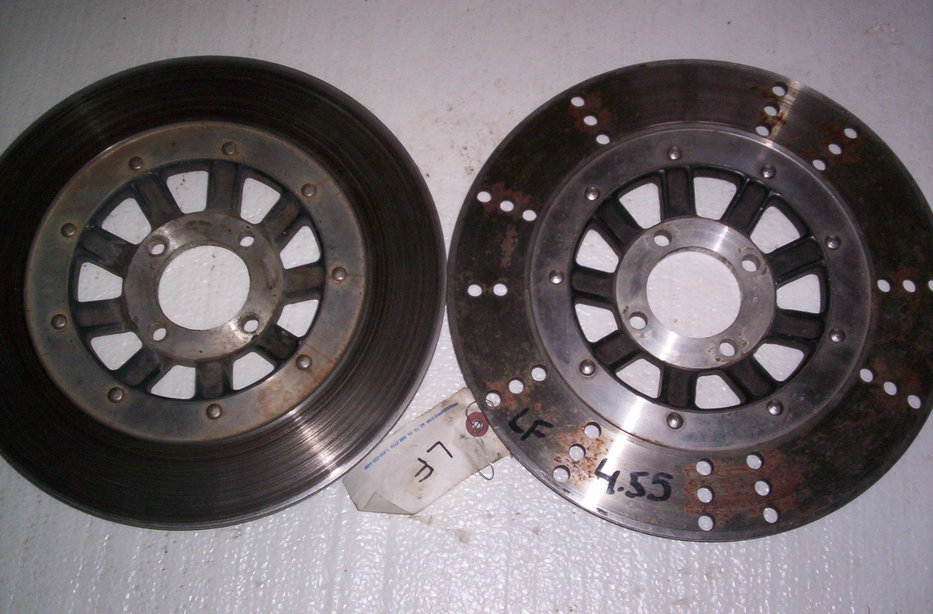

Modern organics are not the same as they were 30-40 years ago. As I said it depends on what the rotors were designed for. I was using NOS organic pads with stock KZ 900 rotors. When I went to the later KZP rotors, the pads went away and caused pulsing at the lever.

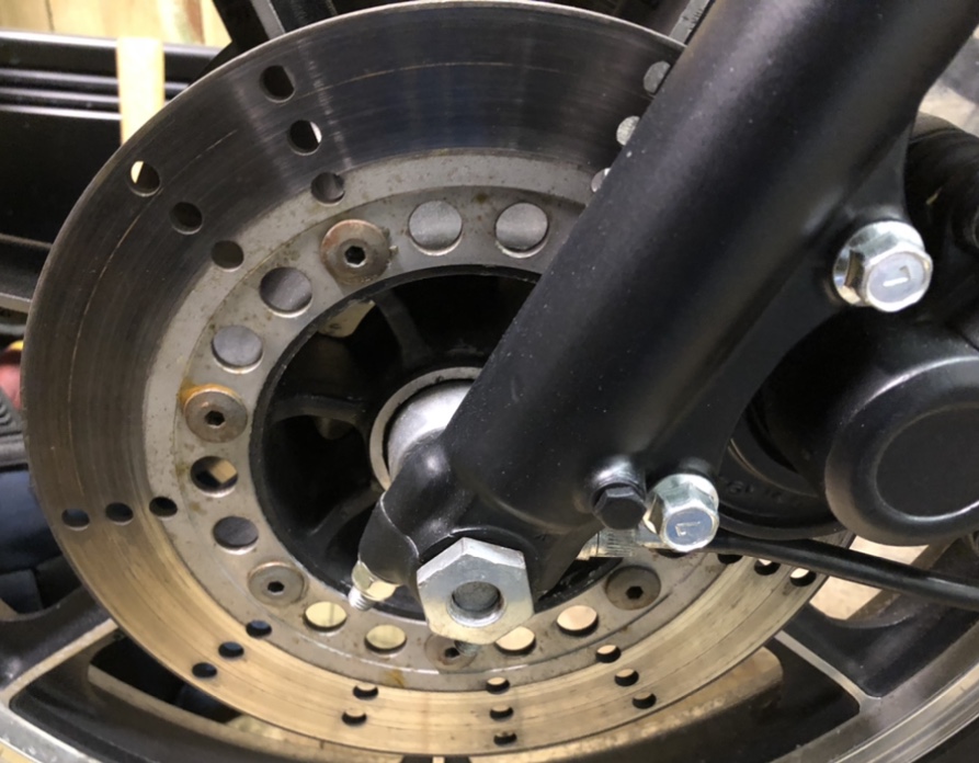

Project:
