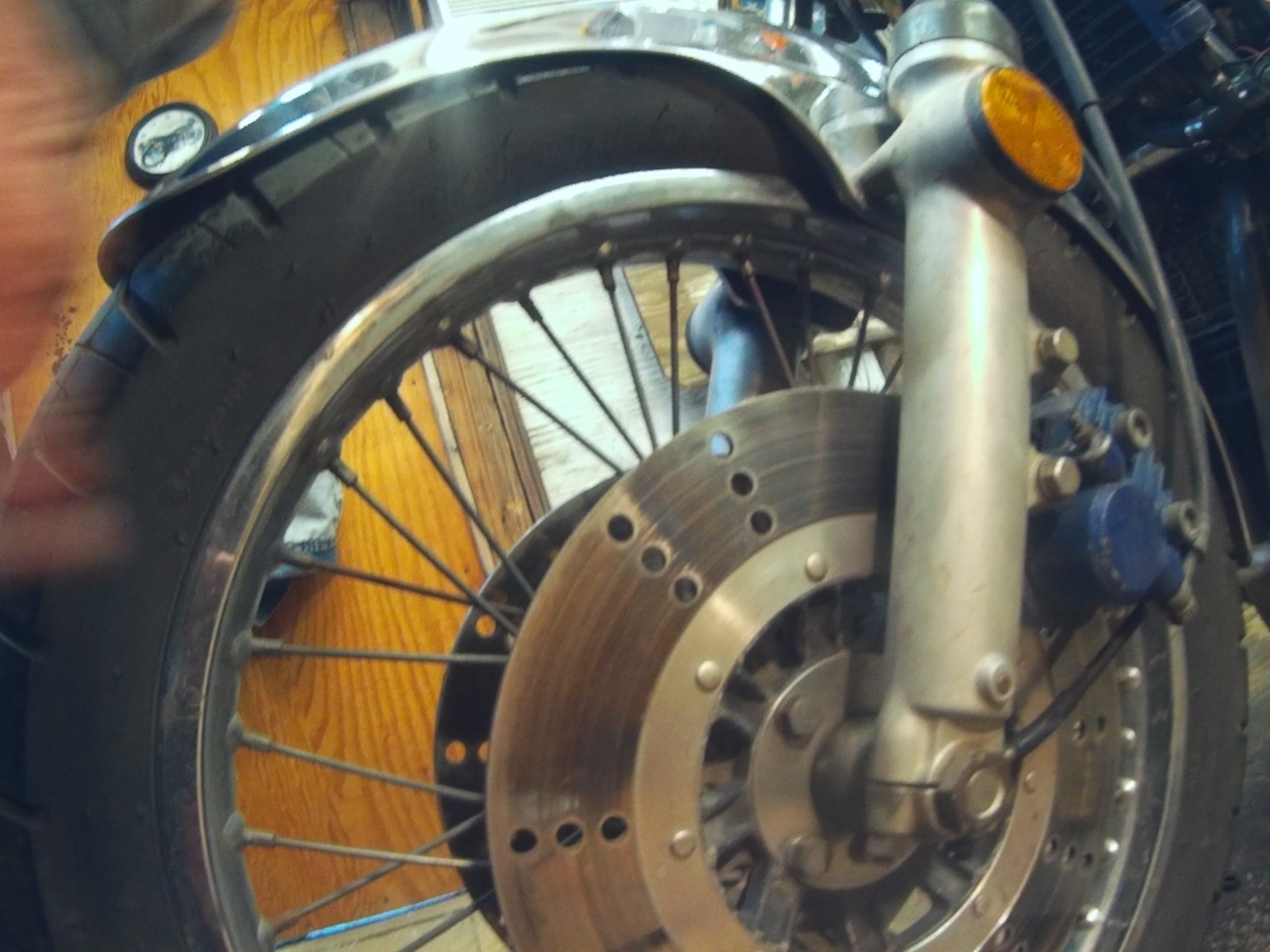

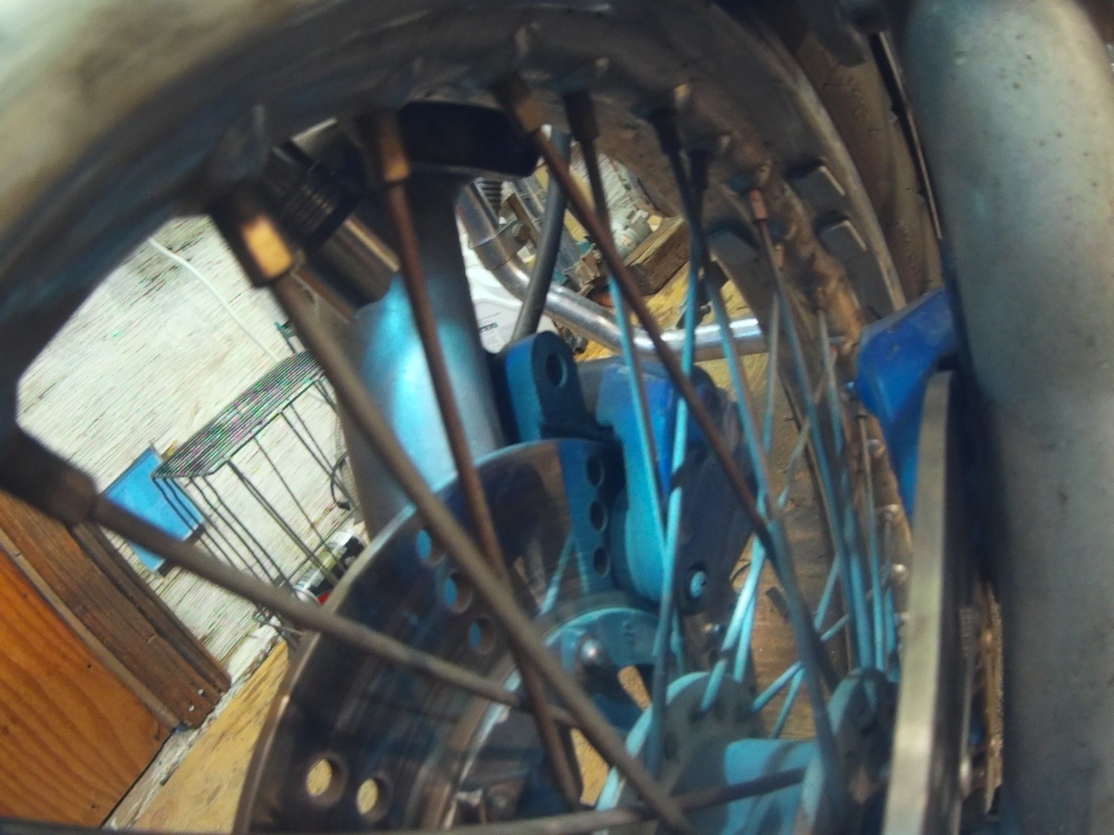

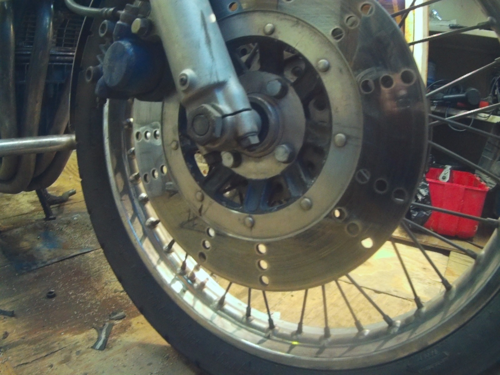

22 Feb 2020 06:38
I suggest you use the type of pads designed for the rotors on your bike. For years I used organic pads with my stock rotors but when I got later OEM drilled disks the lever had a pulsing that was unbearable. I tried everything I could think of to stop it and the pads went away fast. I got some sintered pads and it stopped. It's been two years, the brakes work great, the pads are lasting and the rotors are like new.

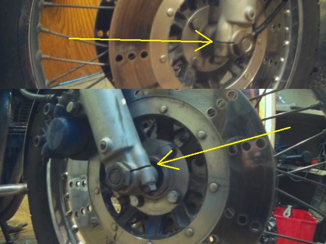

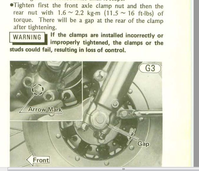

22 Feb 2020 07:00SWest wrote: Steve
I know it's a bit off-subject, but the axle clamps shown in the pics are installed incorrectly (see 2nd image below). There should be zero gap at the forward end of those clamps. All the gap should be at the rear of the clamps. Here's a clip from the KZ manual. Ed

22 Feb 2020 09:20 - 22 Feb 2020 09:25
You're right. I guess I was in a hurry when I changed the bearings. Good catch. I'll switch them now.
