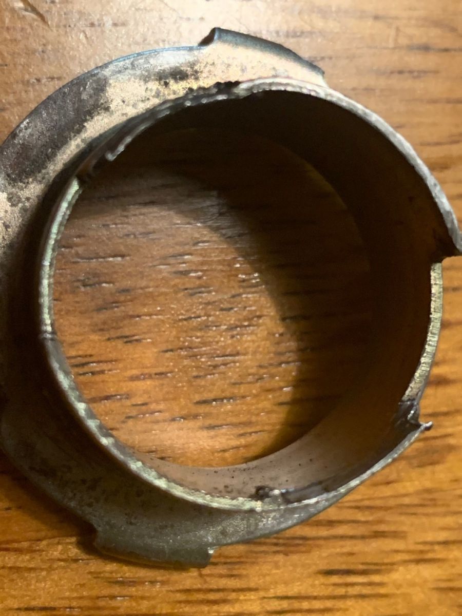

Got a chance to dig in today. The left side was missing a seal. The speedo receiver was chewed up and the left side bearing was a disaster. Not sure if there's cause and effect there, and if so which way it goes. I managed to install new bearings but will hold off on putting the wheel back on until I get a new speedometer receiver.

The speedo drive is supposed to have play. When you put it in the transfer assy, does it turn as you turn the drive

Re: wheel bearings shot?
08 Feb 2020 18:05SWest wrote: The speedo drive is supposed to have play. When you put it in the transfer assy, does it turn as you turn the drive
It does turn the drive. It's not so much the play that I'm concerned about, but the damage to the tangs of the receiver. If you look in the video I give the receiver a tap in a couple places to point out where the metal is sheared off or cut.

- Posts: 23667
- Thanks: 2994
08 Feb 2020 18:20
Looks like it was installed in the wrong position. It can be cleaned up and reused. The seal keeps it centered. The kit should have a new one.

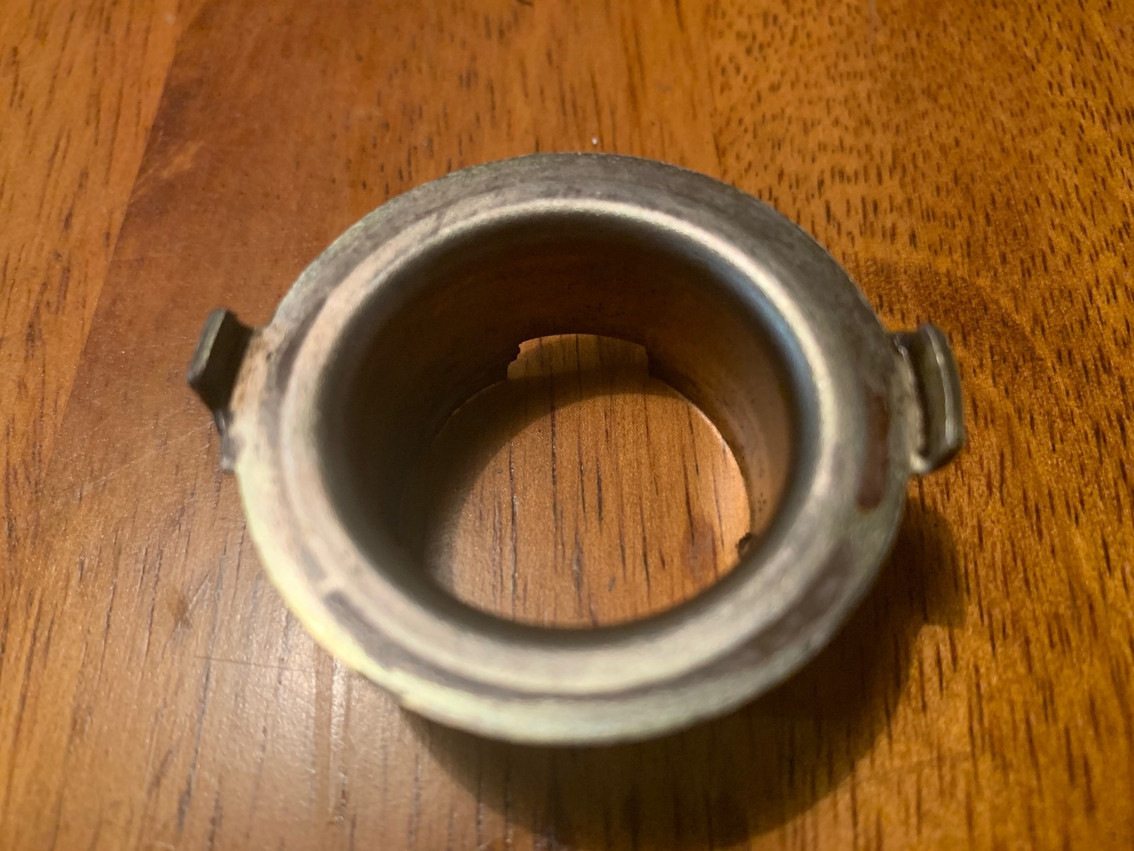

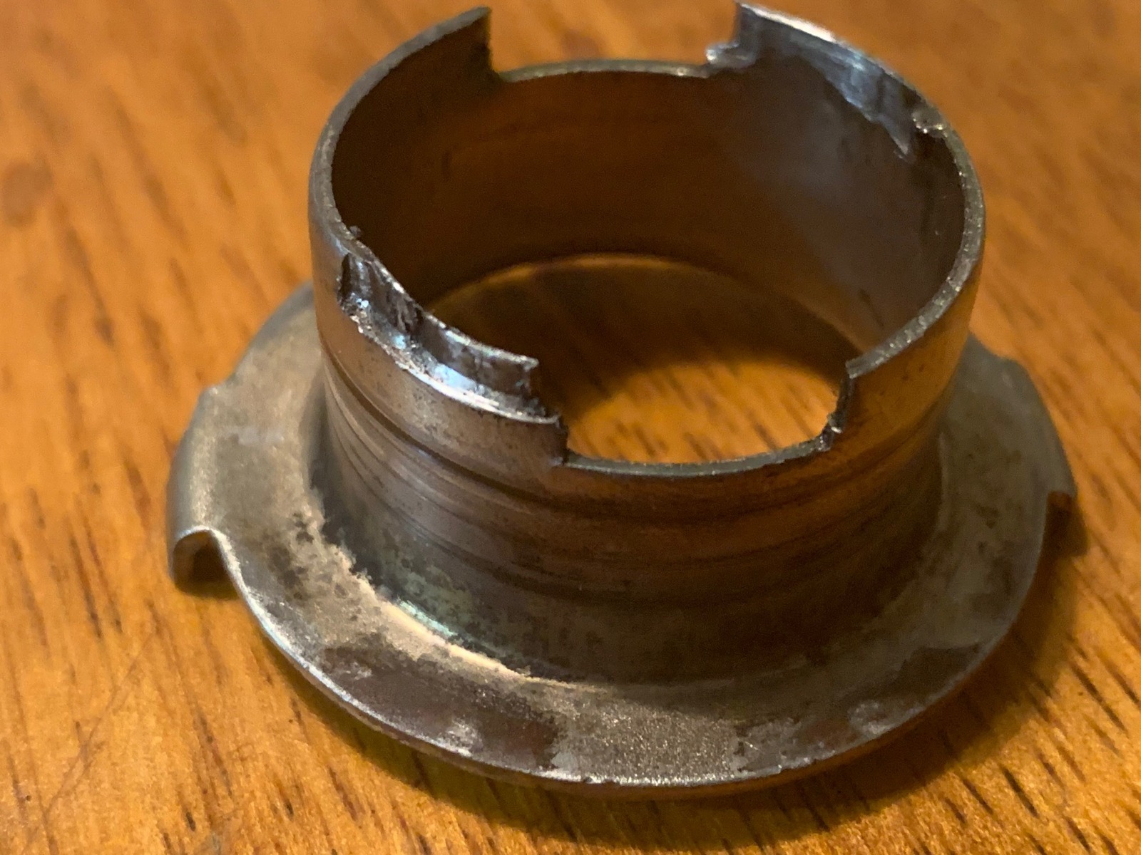

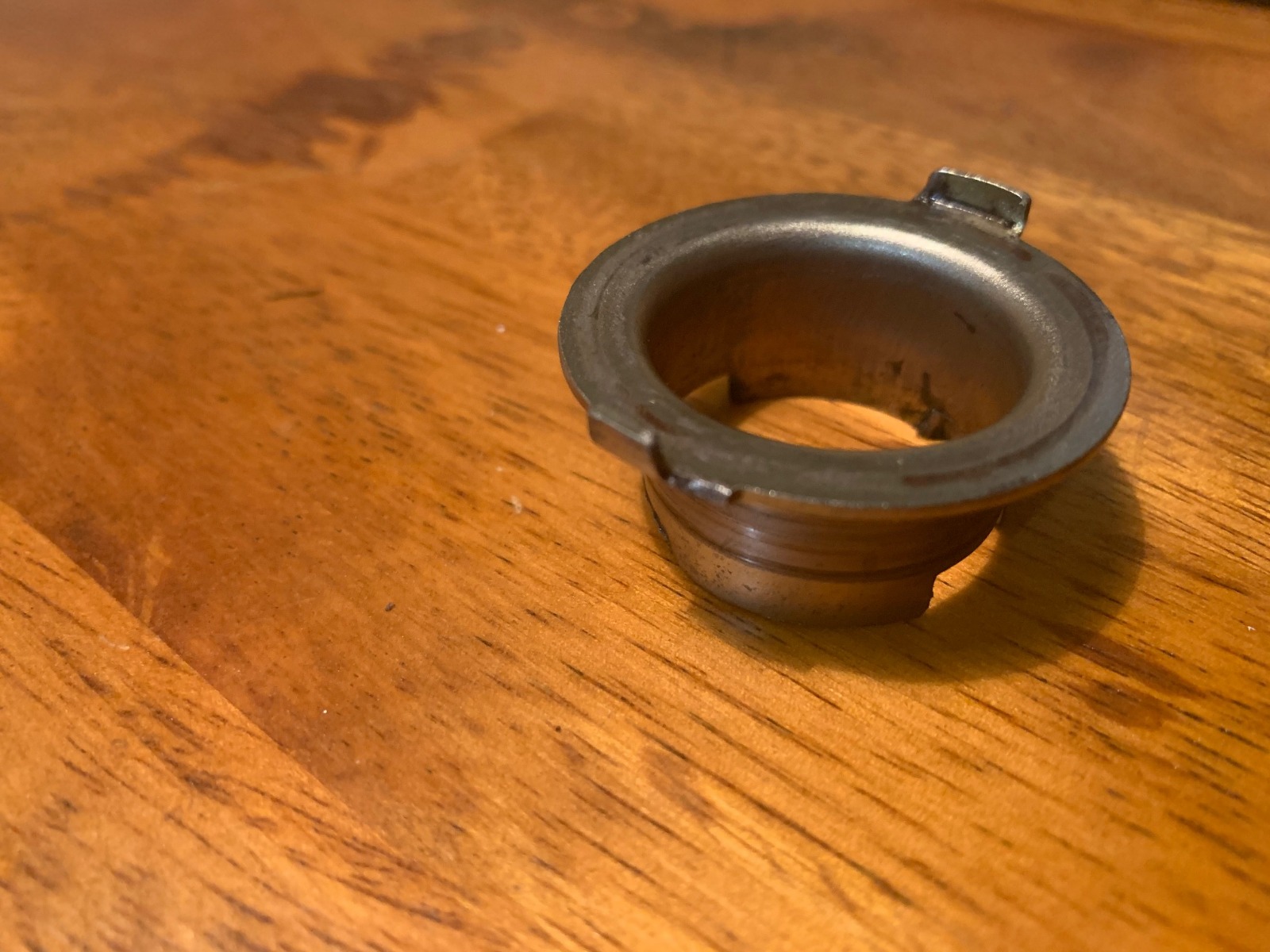

Close up of the drive?
08 Feb 2020 19:53 - 08 Feb 2020 19:53

- Posts: 23667
- Thanks: 2994
08 Feb 2020 20:10
The sealing surface still looks good. I guess all you can do is try it and see what happens. It was the other side that failed on me.

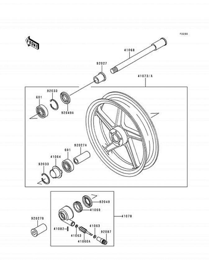

Ah, now I'm confused. The All Balls bearing kit came with three new seals. One clearly goes on the right side hub, the other goes in the speedo assembly. I don't see any place for the 3rd, largest seal. Doesn't look like there's a 3rd seal in the parts diagram either. Maybe it's relevant to other bikes that use the same bearings but not to mine...

- Posts: 23667
- Thanks: 2994
09 Feb 2020 09:10
Not the same bike but mine had only two as well. Might be meant to fit the range of bikes.
