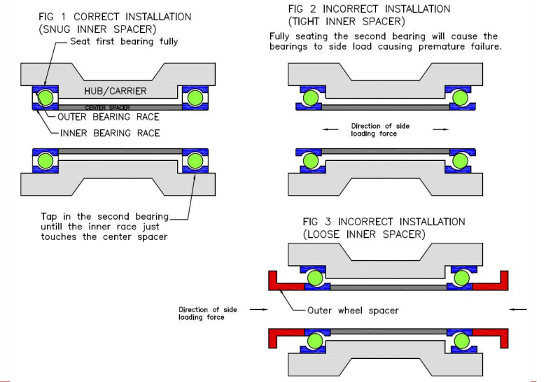

Just to add to what @Nessism mentioned, the second bearing you install should be tapped in gently until it just touches the center spacer. The outer spacers, inner spacer, and inner bearing races make up the "axle" that the wheels spin on. When you tighten up the axle bolt, it presses these items together and can cause side loading if the bearing is driven in too far or not far enough. I've made this mistake myself along time ago and I've worked on many bikes with bad bearings that I suspect were installed wrong. The All Balls instructions illustrate this very well.

04 Feb 2020 16:39 - 04 Feb 2020 16:41jayrodoh wrote: Just to add to what @Nessism mentioned, the second bearing you install should be tapped in gently until it just touches the center spacer. The outer spacers, inner spacer, and inner bearing races make up the "axle" that the wheels spin on. When you tighten up the axle bolt, it presses these items together and can cause side loading if the bearing is driven in too far or not far enough. I've made this mistake myself along time ago and I've worked on many bikes with bad bearings that I suspect were installed wrong. The All Balls instructions illustrate this very well.
Sorry to be a nit but I disagree with Fig 1. If you fully seat the first bearing until it bottoms against the shoulder in the wheel then when you install the second bearing it may not go in far enough so you can install the snap ring.

04 Feb 2020 16:57Nessism wrote: Sorry to be a nit but I disagree with Fig 1. If you fully seat the first bearing until it bottoms against the shoulder in the wheel then when you install the second bearing it may not go in far enough so you can install the snap ring.
No offense taken. I think we're all here for the same reason, keep some older bikes on the road and share some knowledge and stories. I know I'm a little green here and my Kaw experience is limited to one Z1 and a couple KZ's but hopefully I can help some other riders along the way. I just wanted to share that it is possible on some bikes to drive the bearing in too far and that the bearings should be seated lightly against the center spacer.

05 Feb 2020 05:28jayrodoh wrote: Just to add to what @Nessism mentioned, the second bearing you install should be tapped in gently until it just touches the center spacer. The outer spacers, inner spacer, and inner bearing races make up the "axle" that the wheels spin on. When you tighten up the axle bolt, it presses these items together and can cause side loading if the bearing is driven in too far or not far enough. I've made this mistake myself along time ago and I've worked on many bikes with bad bearings that I suspect were installed wrong. The All Balls instructions illustrate this very well.
The .png image file failed to open for us. The link below points to the full directions at the AllBalls site that describes the installation process of not driving the second bearing into it's bore too far. The front wheel bearings on our ST1300 are the same way.
www.cyclepedia.com/manuals/online/cpp-al...ycle-wheel-bearings/
