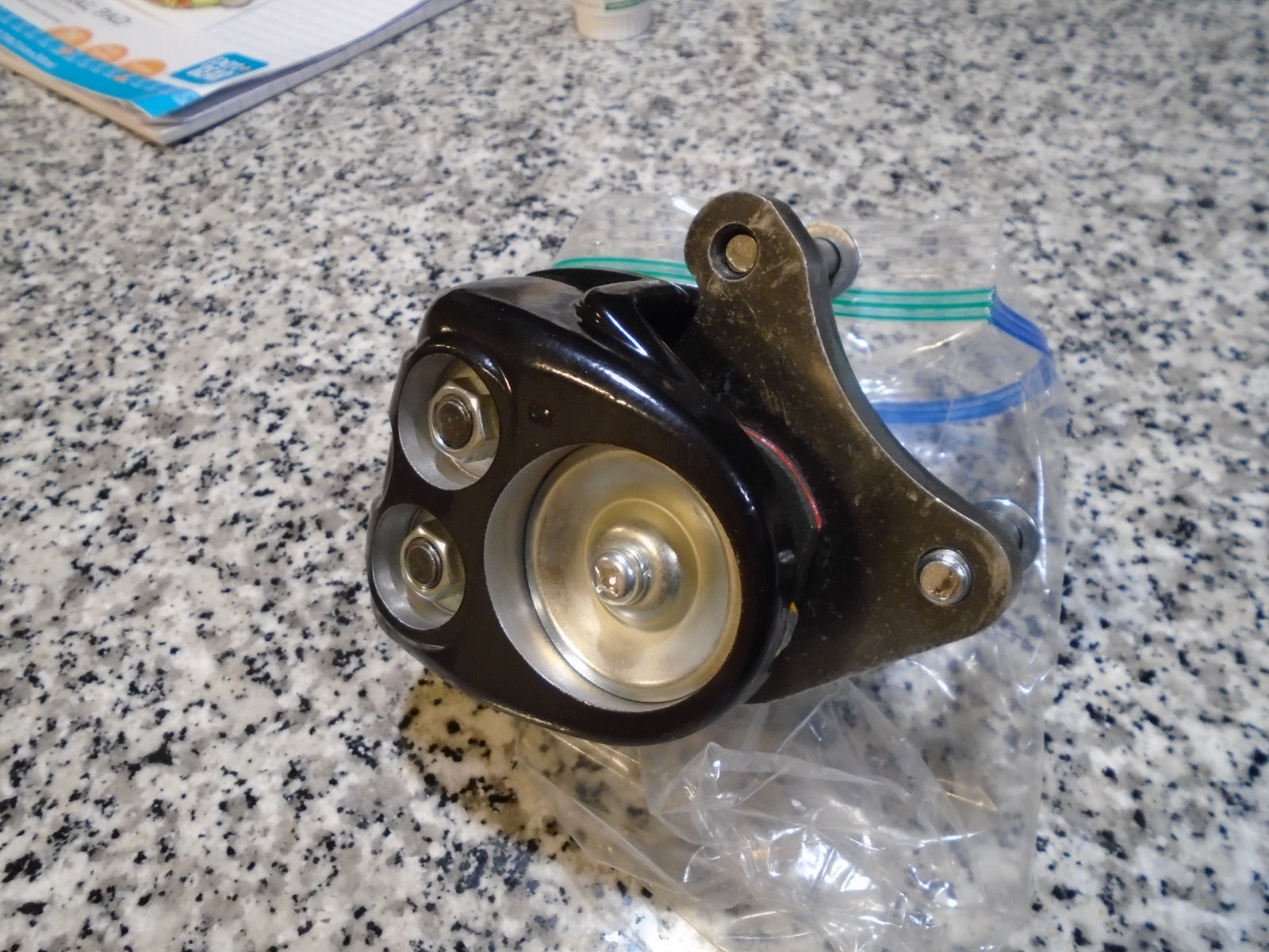

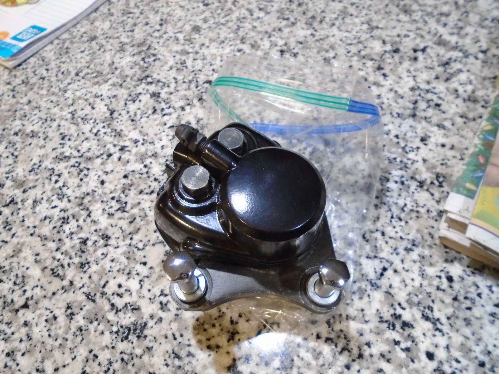

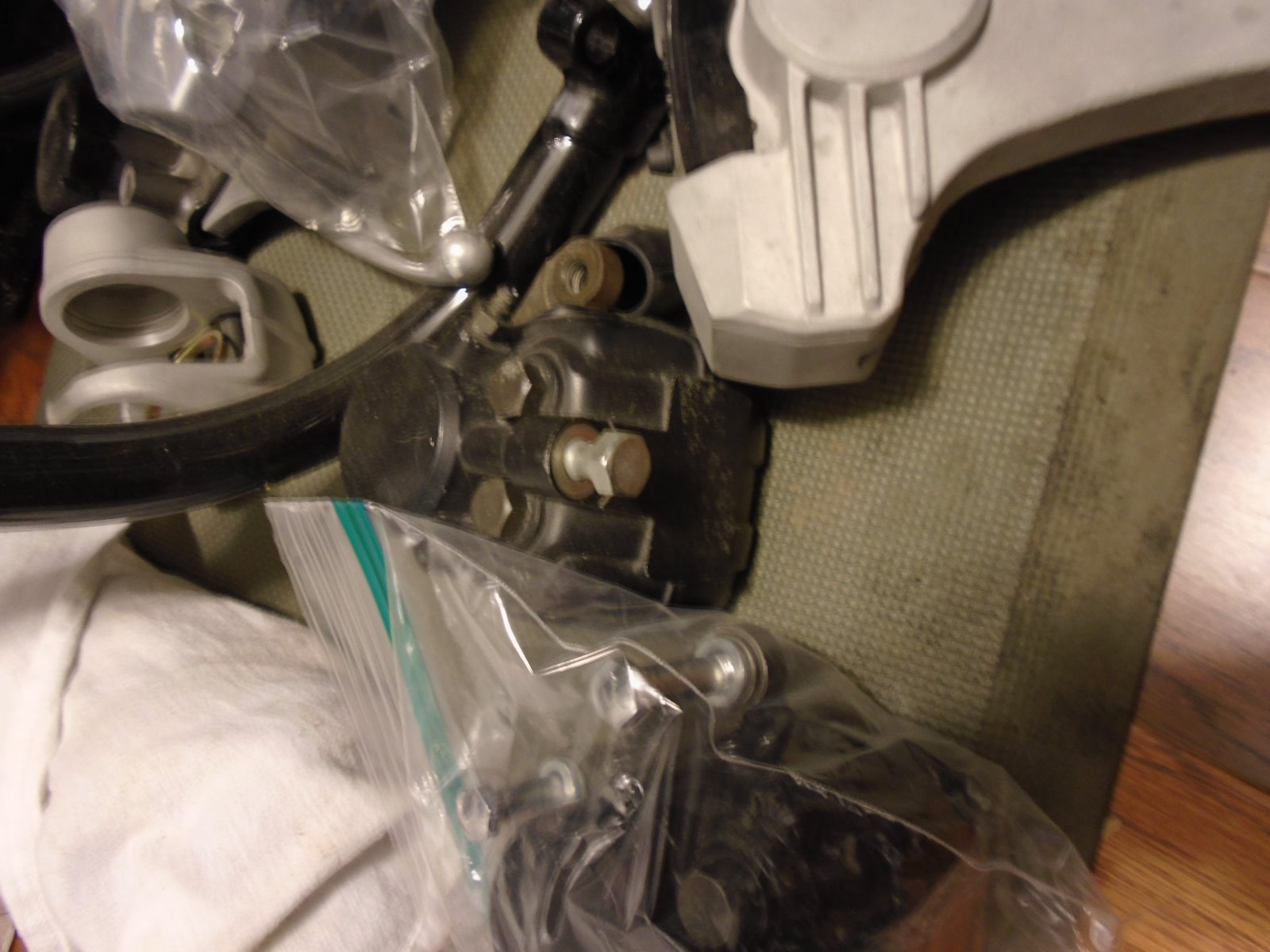

Are you retaining the hard brake line, as original, or using the soft line? Caliper RH brackets can be sourced from various KZ models using the same spacing bosses on fork lowers. Here is a RH rebuilt/refurbished assy that had the correct "hard line" for KZ900 and Early KZ1000. A photo of what I refer to as soft line used on later KZ models. Getting closer to getting the gauges started!!
