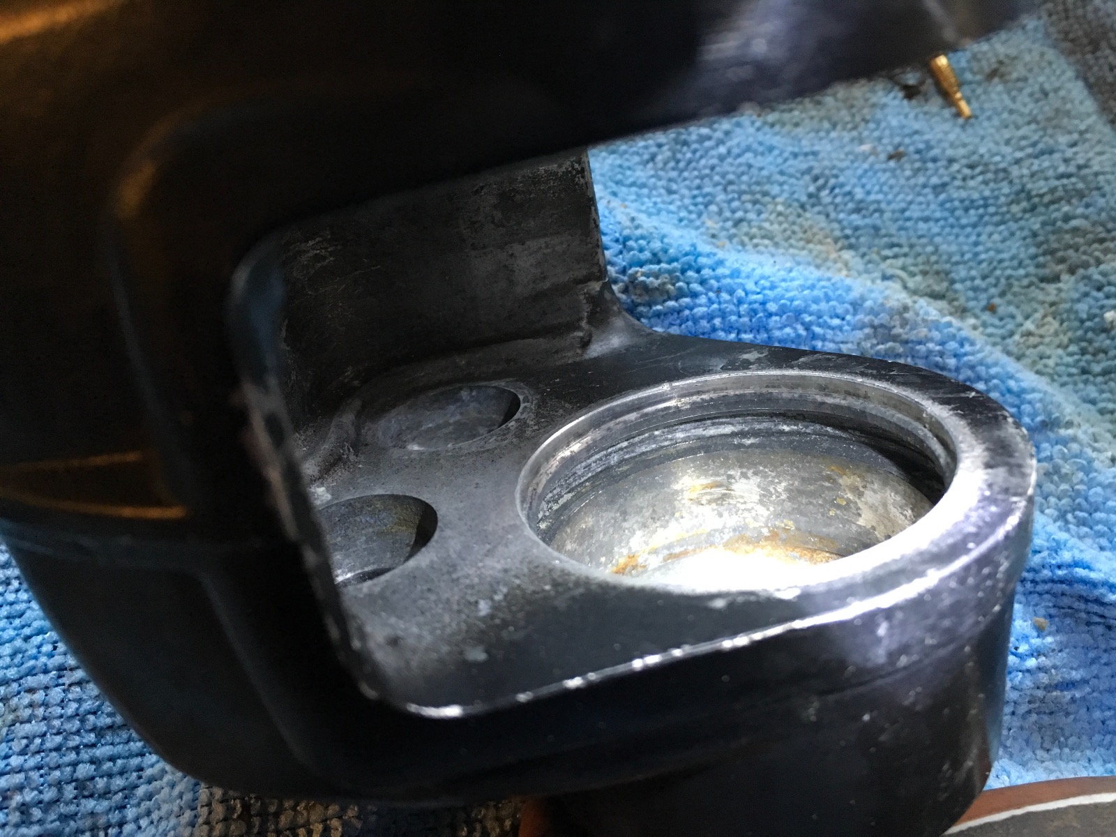

I have both calipers disassembled. One cleaned up with some brake clean and the parts washer, the other was repainted by the PO. I soaked it in the parts washer fluid over night and that cleaned out all of the left over gunk, but it didn't touch the paint or the corrosion in the piston seal recess. It spent the night in the carb dip and that allowed me to scrub off the layer of paint but it didn't get all on the corrosion. In the past I've hade good luck soaking carb bodies in CLR, seeing how the caliper is aluminum I'm assuming it would be ok to soak it in CLR to get the last of the corrosion off.
Any one have a comment on soaking the caliper in CLR???

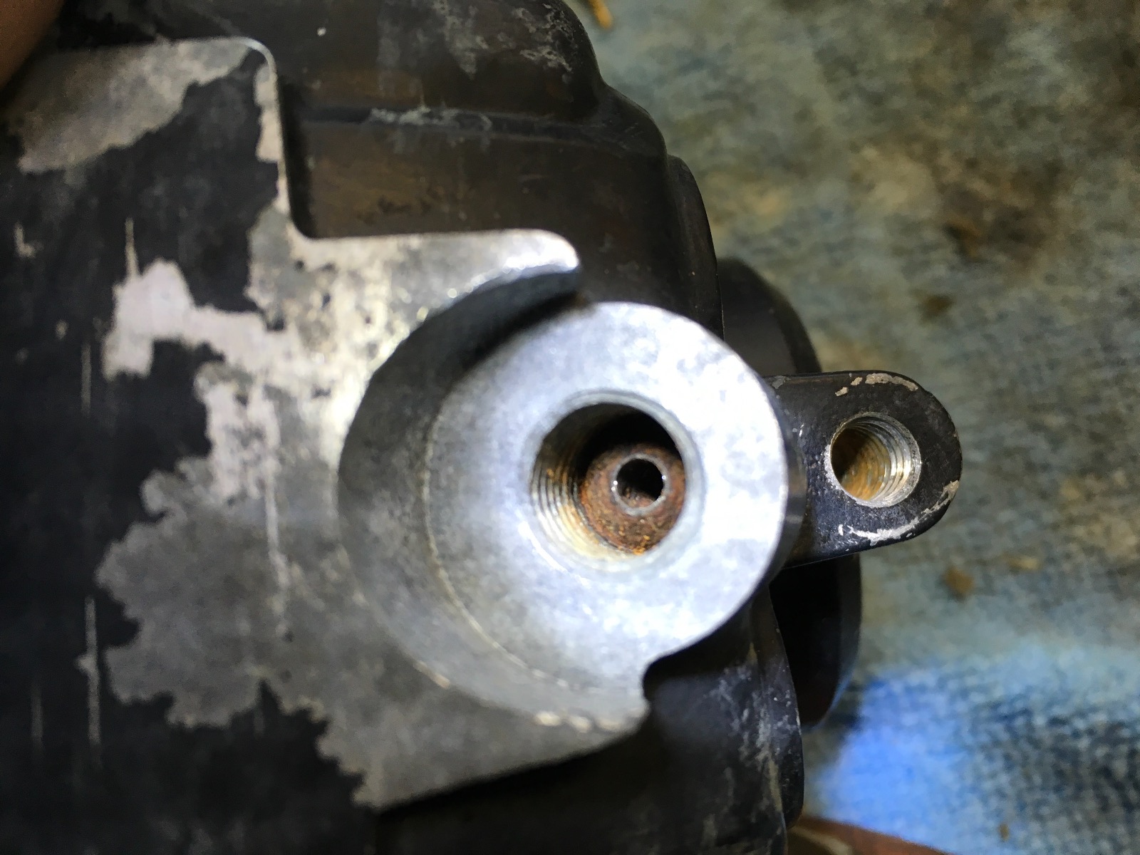

Thank you bluejay58. I’m not worried about the paint, that will be removed at the powder coat. I’m trying to get the rust out of the bridge pipe and bleeder area.
And a little bit of corrosion and rut out of the piston bore. I’m hoping this is just surface rust and it will come off during a short soak in CLR. I have soaked carb bodies in it with great success.

The rust is from the banjo bolt and bleeder screw and held in place by dried out Dot 3
Fresh brake fluid will soften it, so will aircraft paint stripper,
CLR will attack the aluminum , make sure and wash it good afterwards.

I would try a small diameter wire brush, set up on a circular drill for the bridge pipe. I would run a tap down the bleeder hole. For the piston bore....a very fine sandpaper...say 5000 grit or more.

Thank you for the advise... Ill soak it in brake fluid, while I hit HF for some small rotary wire brushes.
