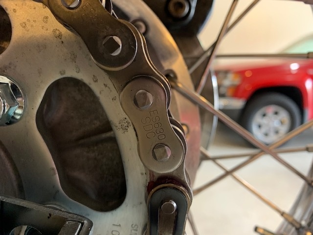

I temporarily installed my new 630 drive chain using a "clip" type master link. My intention was to take the bike to a local motorcycle shop after I got it back together and have them replace the clip master link with a riveted master link that I got with the chain. I have since learned that the shop I was going to take it to for this work doesn't have the capability of riveting, or more appropriately, swaging a new solid head pin master link. I then checked with a couple of other shops and they told me the same thing. The biggest they can go is 530 chain. Looking at the chain it appears as though each pin head is swaged at four points. (See attached pic) Does anyone know of a tool that is available for doing this type of work and where I can find one. After buying the chain and doing some research I probably should have gone with a 530 chain and sprocket conversion, but I already have a hundred bucks into the new 630 chain. Thanks for any help as always.

Whats wrong with the clip master link? As long as they put on with the closed clip end in the direction of travel they are fine. 40 years in on various bikes with different size chains I've never had a clip type master link fail.

There used to be a quad stake riveter available for doing solid end pin links but they are hard to find now as most manufacturers have gone over to the swage type that spread the end of the pin from the center that has a hollowed end. .
You can buy 630 rivet soft links that has the hollow end which any shop will be able to rivet .
Nothing wrong with the spring clip you have though as long as it's on facing the right way and it's a tight fit.
No reason for it to fail otherwise as it's under no load in use.

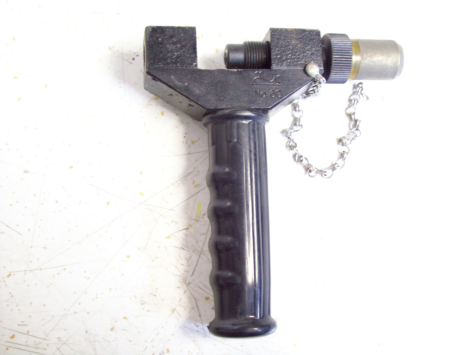

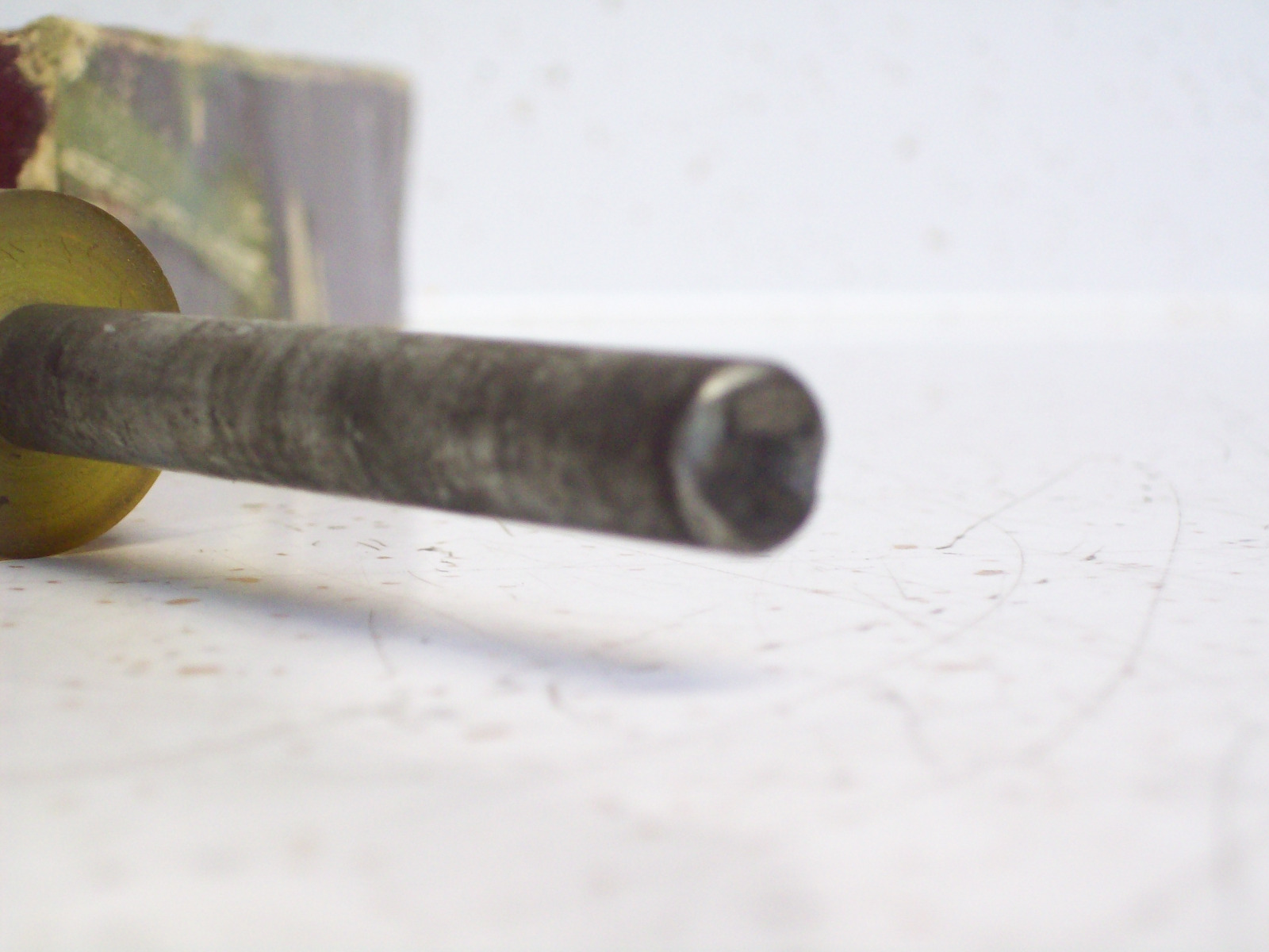

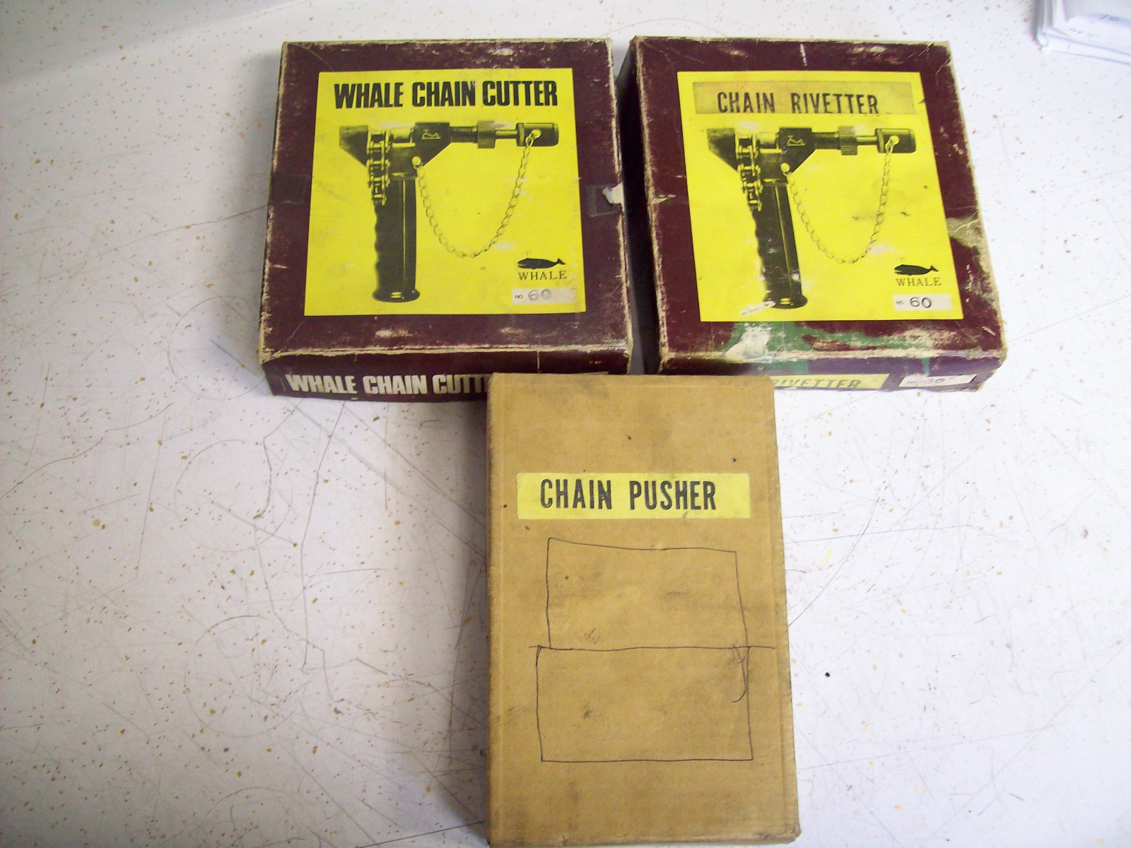

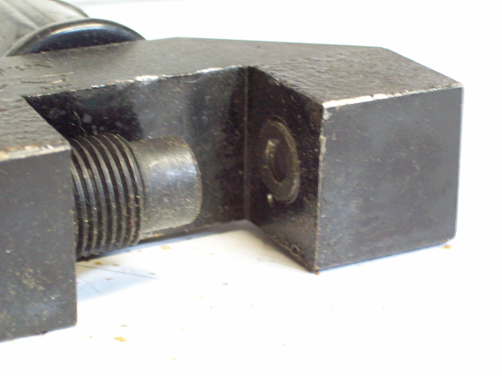

Whale makes great 630 chain tools!!! I have used them for many years now. Check out their 630 chain rivetter tool. It makes a perfect quad stake rivet pattern on the pins. I tried to take a real clear photo of the end of the punch part to show the design of it that gives you that quad stake pattern. But I couldn't get a real clear photo of it!!!
These show up on Ebay every once and a while. I have even used it on 530 chains too!!! I like it better than my RK chain tool too.

For Dr. Gamma: I assume from your pictures that you need two Whale tools, one to cut the chain and one to rivet? I did a quick check on Fleabay and found several new ones, but they were let's say "pricey" and only listed as working on 530 chain. I take it the #50 Whale tool will not work on 630 chain correct?
